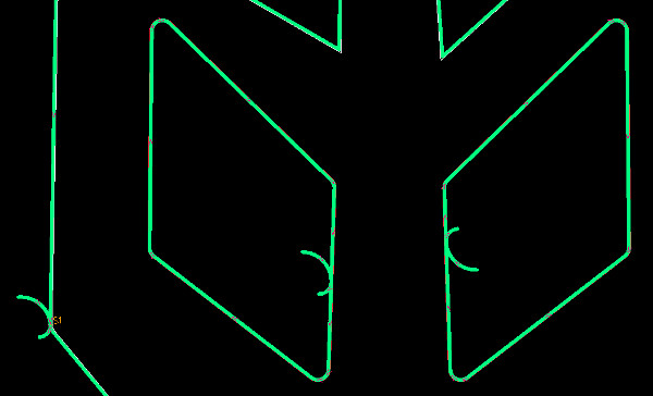

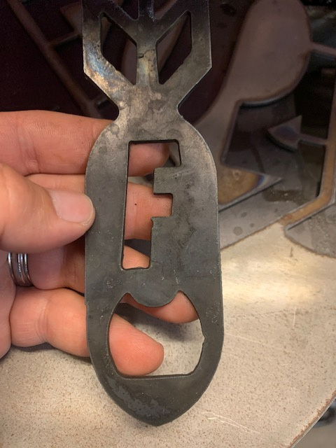

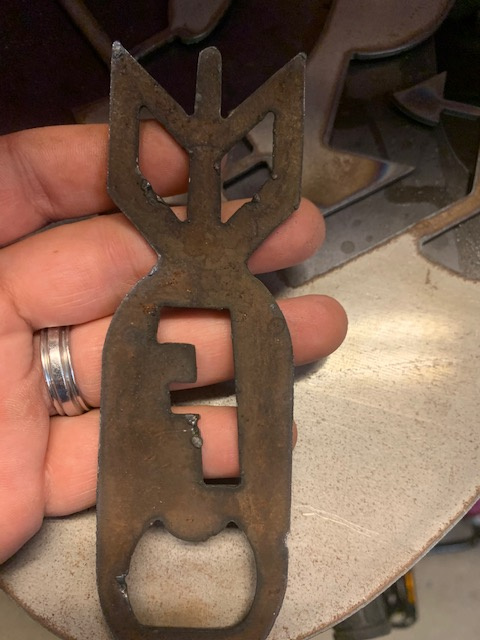

I am getting arc marks on my lead ins on my cuts I have checked the kerf width on sheetcam and on the plasma config on the axis tab not sure what else to check I have new consumables do i need to change the kerf width to compensate but I had done that but didnt see a difference. Any info out there for me to check?

Are you sure that is caused at the start of the cut and not at the end? The ends tend to make a wide divot, but form the picture it looks like you added lead ins and compensated lead in from the wrong side so it is cutting into material and then backing off.
That can also be caused when the inner part falls off and the arc widens chasing the falling piece.

Those divots are not made at the start of the cut.
They look likely to be made by lead in moving outside of the cut line or from overburn when the plasma is switched off.
Another thing that might cause that at the end is, the step per milimeter or inch is way to low, so for short movements the motors actually stay in one place, causing that overburn. I really doubt it is the latter as the sloped cuts look OK.

on sheetcam you can look on the path if it is on the right side
and you can do the CONTOUR button and Right mouse on the outer contour
move to new layer and work your way to the contours if they are not in your way orderd to be Inside outside compatible to eatch other
likwise Rhino DXF does lots of path cahanges while Qcad orders/sort/direct all the same way
