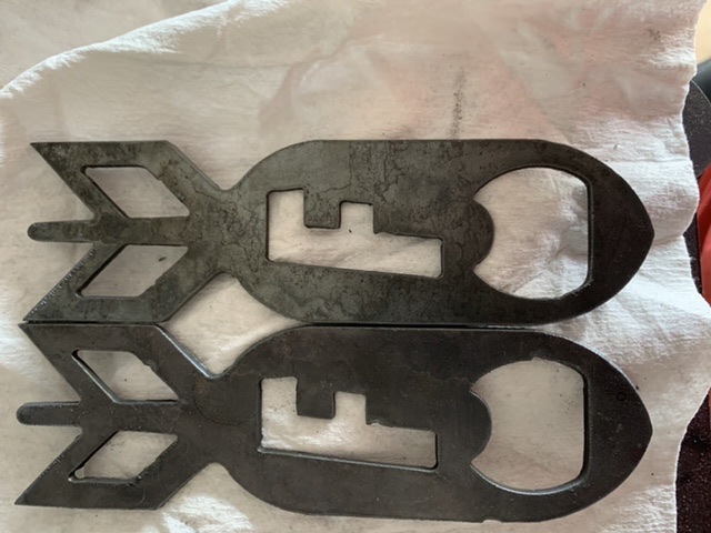

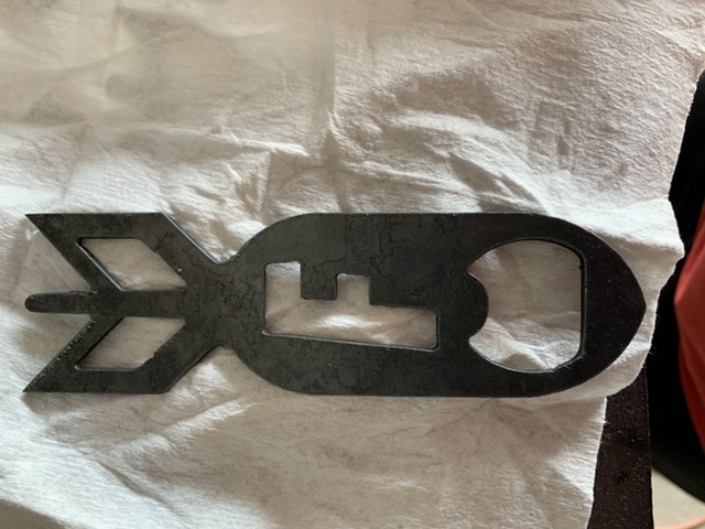

Replied by tommylight on topic Getting arc pierces on lead in on inside cuts
On the second picture there is the THC section, and there is speed in %. Lover that to prevent "bunny hopping" or to much moving up and down during cut.

Replied by phillc54 on topic Getting arc pierces on lead in on inside cuts
Maybe your machine is slow at turning the torch off.
It would be worthwhile trying Tom's suggestions on this post forum.linuxcnc.org/38-general-linuxcnc-q...cuts?start=10#158257
I am not sure about the Cut Feed Rate of 150 inch/min (3810mm/min). I assume it is a40A machine from the Run Panel. Other folk would have a better idea than me.

How do I speed up the speed on the axis to make them faster?
- Posts: 21990
- Thank you received: 7487
24 Feb 2020 16:06 #158389
Edit the ini file and raise the max_velocity.
Also the stepgen_max_velocity must be raised to at least 25% more than max_velocity, if present.
