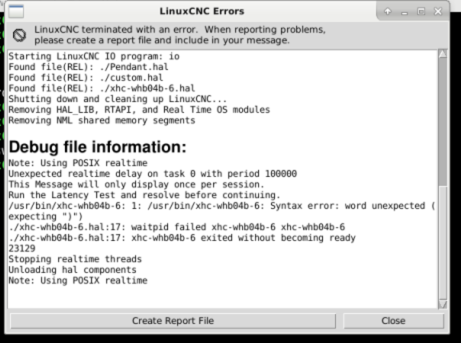

I moved a step forward after "sudo chmod +x xhc-whb04b-6 "
But another error message now
- Posts: 21921
- Thank you received: 7468
07 Apr 2020 23:06 #163118
Replied by tommylight on topic Pendant WHB04B on LinuxCNC 2.7 / Debian
There is a missing bracket on the first line of xhc-whb04b-6 file.
- Peterdeleu
- Posts: 99
07 Apr 2020 23:18 #163120
by Peterdeleu
Replied by Peterdeleu on topic Pendant WHB04B on LinuxCNC 2.7 / Debian
You mean the file in the binary folder?
I can't edit this file. It is not a text file .

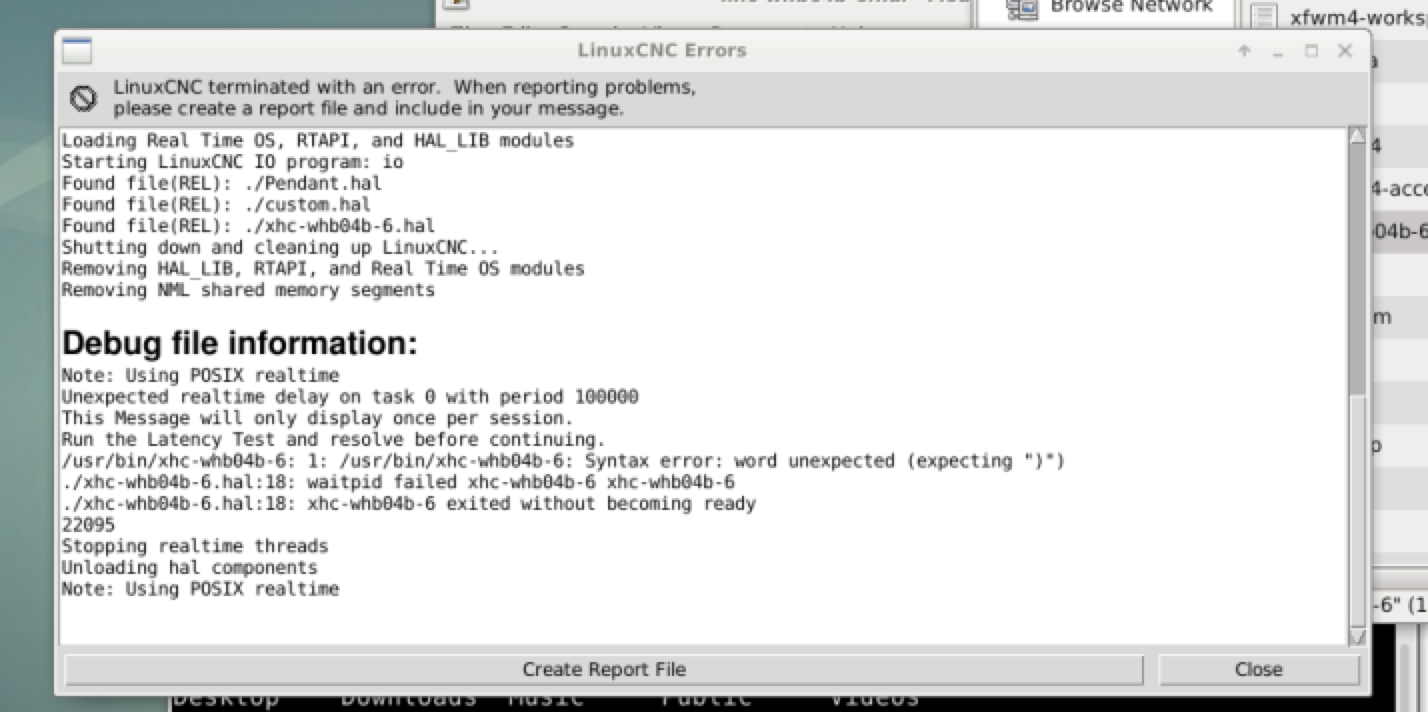

08 Apr 2020 06:51 #163163
by Peterdeleu
Still an error message
