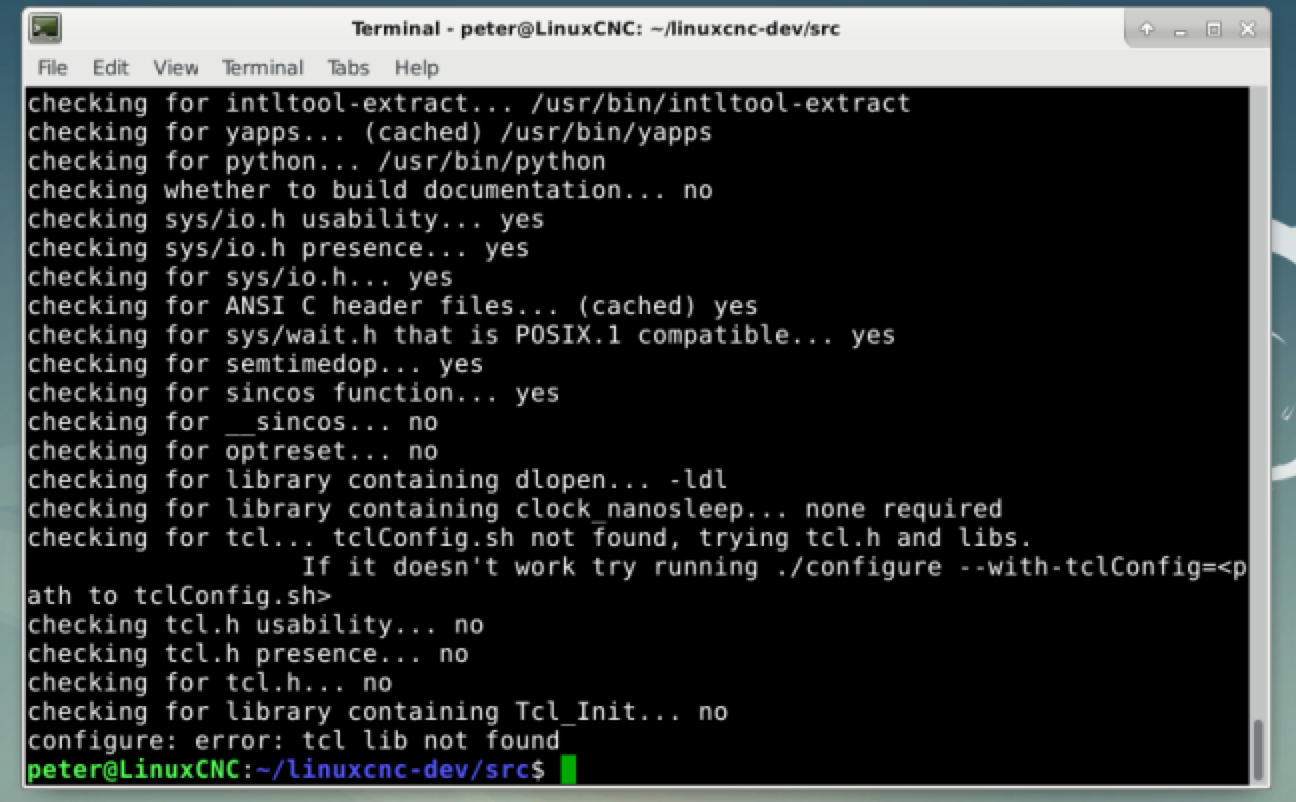

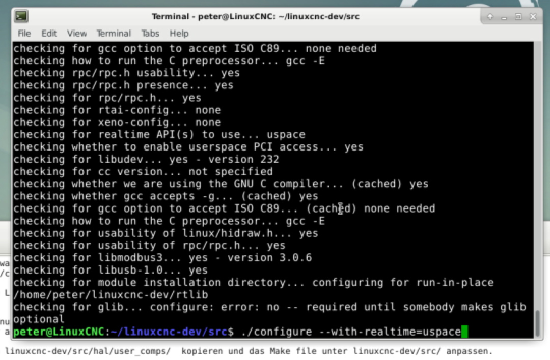

I tried to follow the Talla83 solution
During the command : ./configure --with-realtime=uspace it stops with this error message

Maybe I should give up
I've installed giblib2.0, gtk2.0, yapps2, intltool and tcl.h
It seems like I miss a lot of things here..
It is not easy with lack of Linux knowledge
Now it stuks on : see error message

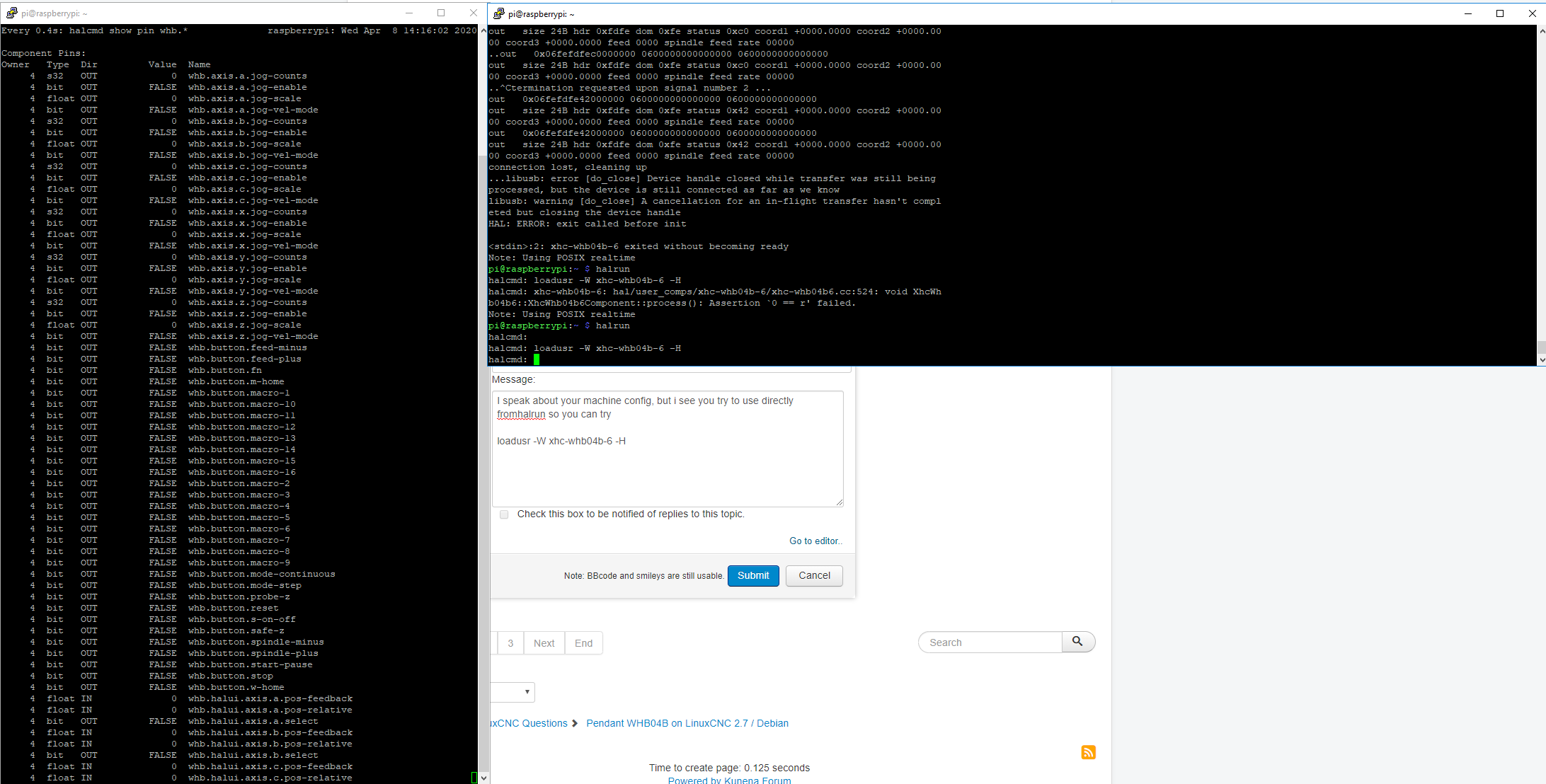

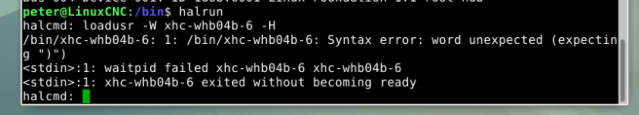

Replied by alkabal on topic Pendant WHB04B on LinuxCNC 2.7 / Debian
Please share your full config
or try to start
loadusr -W xhc-whb04b-6 -H
or try to start

08 Apr 2020 12:13 #163189
by MovT
apt-get install tcl-dev
Replied by MovT on topic Pendant WHB04B on LinuxCNC 2.7 / Debian
I speak about your machine config, but i see you try to use directly from halrun so you can try

08 Apr 2020 12:28 #163194
by Peterdeleu
Replied by Peterdeleu on topic Pendant WHB04B on LinuxCNC 2.7 / Debian
Stil that same error message
