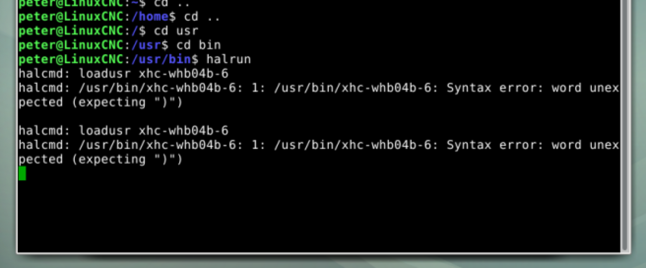

I think this is no /bin but /usr/bin for past the binaries file
Last edit: 08 Apr 2020 12:53 by alkabal.

following this :
linuxcnc.org/docs/devel/html/code/building-linuxcnc.html
i have succefully compiled my fork with fresh git clone:
For a run in place you need to copy the rules files manually to /lib/udev/rules.d/
and in your home directory do (with dot and space)
. ~/linuxcnc-dev/scripts/rip-environment
replace :
> git clone git://github.com/linuxcnc/linuxcnc.git linuxcnc-dev
> cd linuxcnc-dev/src
> ./autogen.sh
> ./configure --with-realtime=uspace
> make
with
git clone https://github.com/alkabal/linuxcnc linuxcnc-dev
> cd linuxcnc-dev/src
> ./autogen.sh
> make
> sudo make setuidFor a run in place you need to copy the rules files manually to /lib/udev/rules.d/

I'm sorry to say, but I still have that error message.
I've followed your last procedure. But always the same error .
The problem is, I don't know what I'm doing. I just follow your instructions.

Hi
Following instuction allow only to add the bin (compiled file from updated source with Lcnc 2.9 latest) anf rules files in the good foder + chmod for make it executable.
If you try with loadrt : the hal file is not used (only needed for start with real or sim config)
if you have do this for RIP you don't need any more to do cd /home/your/linuxcnc-dev/bin or /usr/bin and if you have installed from deb installer you even don't need to do this.
i have succefully use loart with : loadusr -W xhc-whb04b-6 -H
I have never see this error message before so i apologize but i don't really know what append, the only things i can think is you have the 4 axis version and i never used this one.
Other things not tested, have you a realtime kernel ? (tested only with rt-preempt)
if you are able to allow ssh i can try to help remotely.

try
sudo apt-get -y install libc6-dev libusb-1.0-0-dev
yes teamviewer is possible
Maybe the best i try to setup for compile

Tx to Alkabal. My pendant (XHC-WHB04B-4 - 4 axis) is working in Debian 10 / LinuxCNC 2.9 !!

I'm trying to do make this pendant works on Debian 10.3 LinuxCNC 2.9.
I have the same issue "syntax error: word unexpected "
It seems you did manage to get it work, could you share how ?
