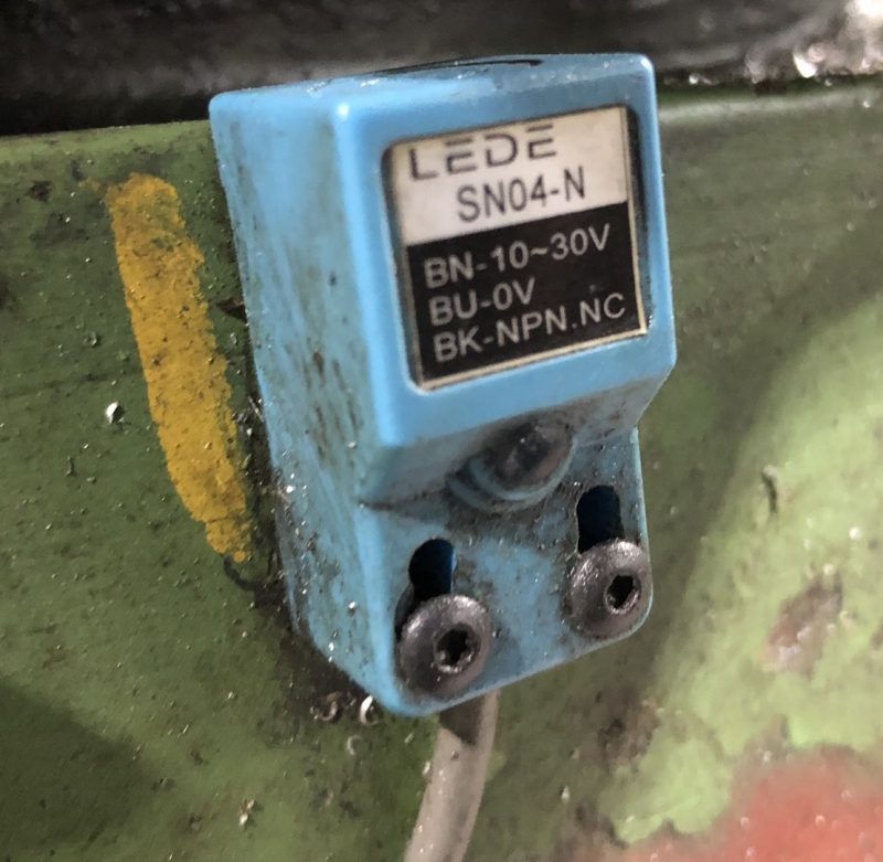

Clive, very good! The set up I have only uses step and direction DC servo drives on XYZ and a hybrid stepper motor on the 4th axis. Everything is still step and direction. The spindle is just on / off relay.
So I think the 7i76e will be perfect. Just need to check on pull up or down version. I think all my limit and homing proximity switches are NPN. That fact will determine my sinking our sourcing option.
Just clarifying that the 7i76e has its own opto couplers that if are enough to cover my 1/O requirements wont require an additional BOB?

PNP switches connect directly. NPN's need a pullup resistor, or use a D board
7i76 has 32 ins and 16 outs. need more? use a 7i84 which can connect directly to the 7i76. That gives you 32 more inputs and 16 more outputs.

Bevans, I think you mean NPN's need a D board don't you?
Replied by rodw on topic Which Mesa board?
PNP switches connect directly. PNP's need a pullup resistor, or use a D board

These are what I use for the limits and homing an all axis, NPN.nc.
So I need the 7I76ED ?
Thanks.
Thanks.

Unfortunately the 7I76ED only changes the digital outputs
to sinking vs the 7I76Es sourcing output drivers.
The inputs are still sinking and require sourcing drivers
(switches, PNP sensors etc)
A 7I95,7I96, 7I97, 7C80 can use sourcing or sinking drivers
for their inputs. a 7I76E or 7I76ED would need pullup resistors
to interface with sinking (NPN type) sensors.

My servo drives are fairly new Chinese drives, step and direction for DC servo motors. My sensors are all NPN. Im currently running Mach4 with Ethernet smooth stepper and BOB. I want to gut all this for Linuxcnc and and use the 7i76e in place of both the ESS and the current 5v BOB.
So with all this in mind is it the 7i76e or ed? I dont mind changing stuff around.
So its looking more like the regular 7i76e and then using pull-up resistors to accommodate all my NPN limit / homing switch inputs. Yes?
