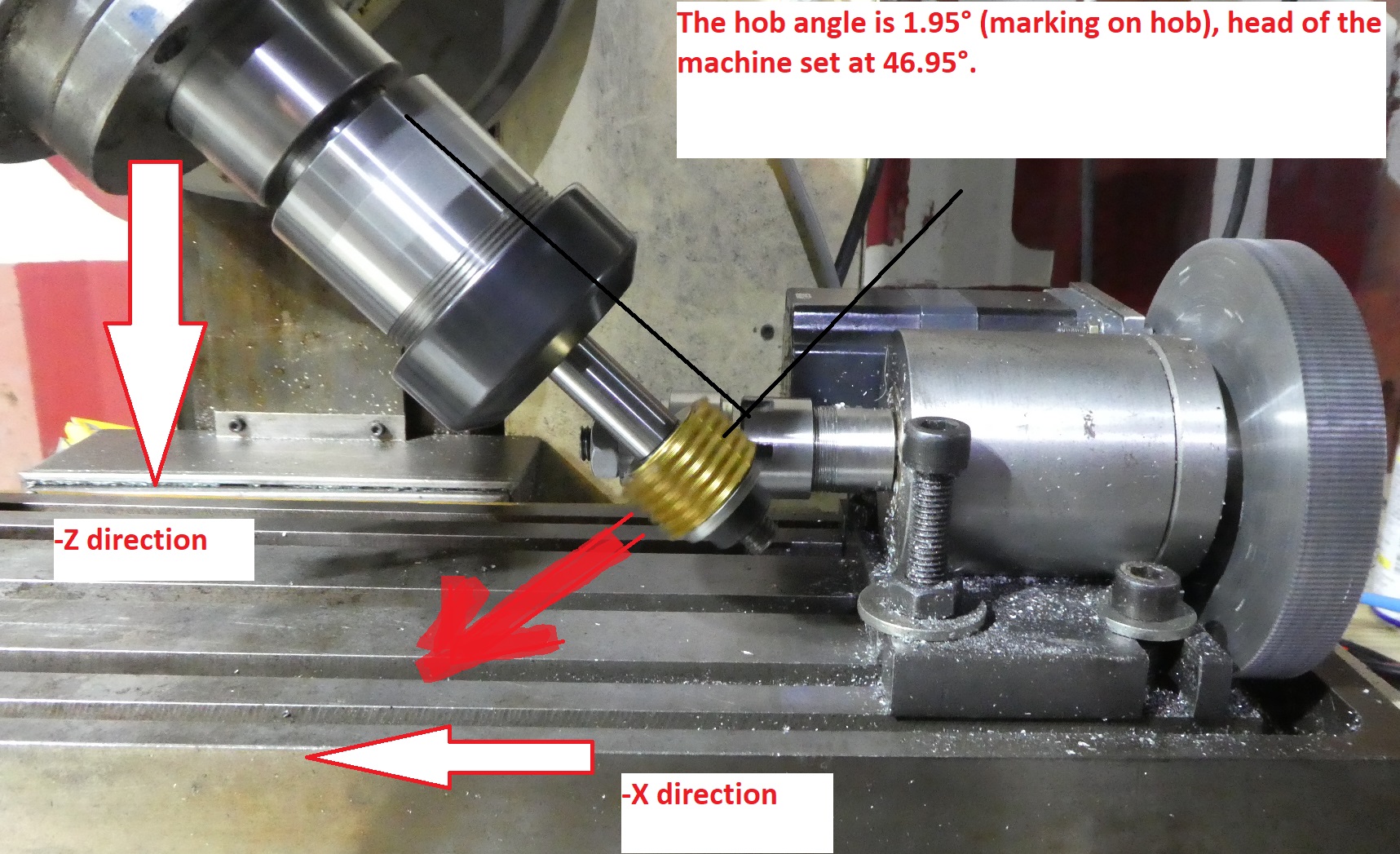

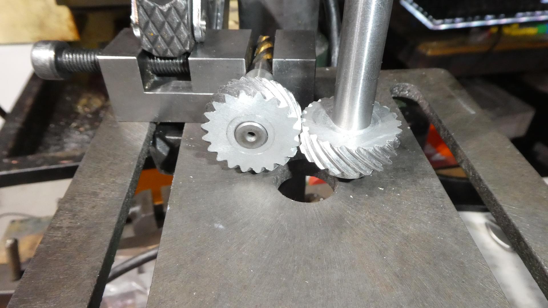

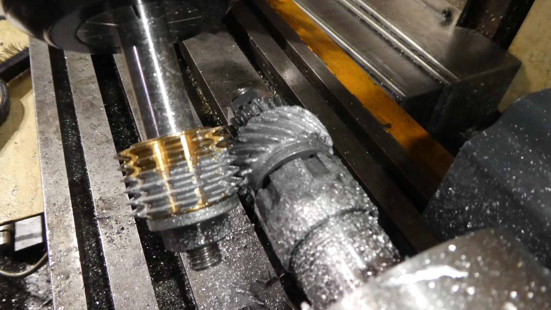

24 Apr 2021 19:12 - 24 Apr 2021 19:18 #206963 by timo
Replied by timo on topic hobbing helical gear
Outcome of today.
Actually I am not sure if shifting the hob is the right expression.
Today I tried this again.
The wokhead is set to 46.95° ( marking on hob 1.95° plus 45° helix angle)
The number of teeth is entered into the invert.0.in on hal file.
Then the spindle rotation and gear blank rotation is in sync.
Now the workhead travels parallel to the tooth of the hob. So it moves left and down for a climb cut. Actually it is not really shifted, but only traversing. As you can see the oily mess is only on the lower part of the hob.
I made a horrible mess driving it down at a 45° angle, this was a bad Idea and wrong..., so one gearblank was scrap. It must travel along the pitch of the hob at its angle ( 46.19°)
I cut two gears that way.
They mesh O.K. as far as I can tell.
Then I played around with the virtual differential gear.
Here is a short 30s clip to show the proof of concept.
You can see that the gear rotation speed is adjusted automatically based on the speed the gear has relative to the hob, I think that is what jefsaro was lookig for.
I made this video by tweaking the value roughly. The next step will be to create a proper formula to allow to put the correct value into the program.
Greetings Timo
p.s. in the video I am jogging the machine manually at different speeds. So if the value is set correct later multiple depth can be cut or the cutting feed speed could be adjusted during the cutting.

I tried this since last post by first cutting a set of gears based on the sketch from previous post. Then driving hob and gear based on the new method.
Now next step would be a proper hob shifting based on z-axis travel to wear the hob evenly.
