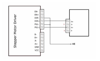

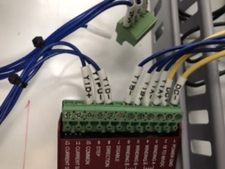

by Himarc3D
Replied by Himarc3D on topic 7i76e - TB2 not working - no axis motor movement - but TB3 and rest working fine
The picture is frim my Gecko201x the image is from internet
201X the wires i labeled Y1PU- (step -) Y1D- (dir -) and Y1D+ (common)
Do what Mike told, check your pins.
