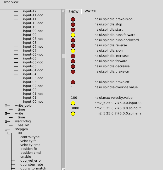

Use the "watch" window in Halshow to see what is happening, paying special attention to the PID inputs, feedback and output.
Maybe your spindle encoder shows positive speeds for negative directions?
You can start Halshow in Axis with"Machine -> Show Hal Configuration"
Other GUIs may have it in different places.
With any GUI, the command "halcmd loadusr halshow" will launch the utility.

so , when i put m4 halui reverse no change,

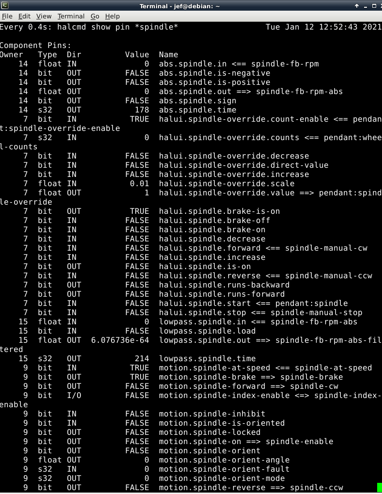

I think we need to see the pid.s.... pins and the spindle.0..... motion.spindle pins
(Edit, I see you are using an old version of LinuxCNC)

Imo we can see the value -100 for spinout when you run backward. But you need PID allways positive !
I suspect that you do not use the file i have write for you because i have take attention to that (excepting a possible mistake when i have write your hal)

hello, here I found the error, by placing the vfd, I inverted the + 10v and reference wires, now the inversion works, thank you and sorry.
now i will put your file back and test it with orient.
