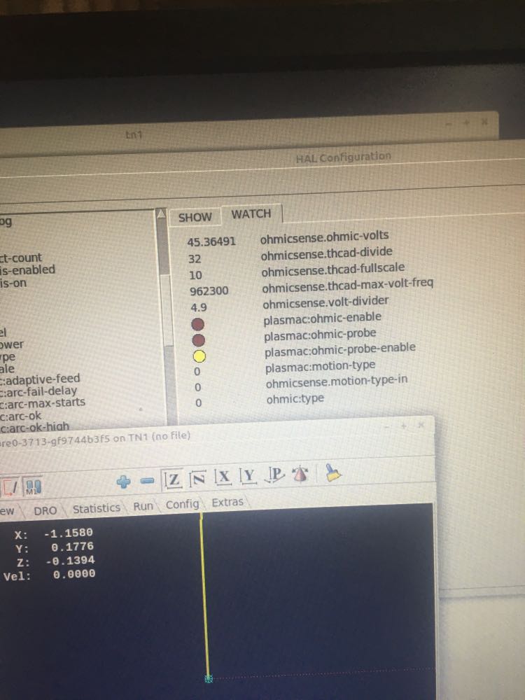

All of that is fixed earlier. I had the divider set to 1, PCW kindly noted that's not right as it would never see it.
Now things are happening but I cant seem to get it to work.I think I have my voltages and scales and stuff done wrong. Look at the picture I am getting 45volts in the thcad or so when touching the metal. Should I set my threshold on that? 44-47? It is set to what rod has I think is 24
Whats up with the 0's in ohmic type motion-type?
Replied by bevins on topic Ohmic3 hal file errors
I think we are going down the wrong rabbit hole here. He said he has no velocity on the .01 encoder. Even at 0v, there should be velocity.
I’d start there. It sure seems like something with the encoder side of the wiring to me.

If you’re using a THCAD-10, your voltage divider is not 4.9.
You’ll have to calculate it based on the resistor you used to scale the voltage.

Bevins, post up your scaling resistor value and I'll look at the divider and I'll do some revised calcs for you.
