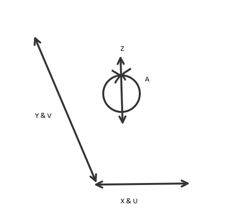

What are all the other constraints for the system? Cost, max size including Z, how soon do you need/want it, max weight, how fast does it NEED to cut, how much can you do, who can help you, etc etc
So far I see:
Plasma cutter - mobile on its own wheels
15m x 3m XY
1mm accuracy of cut
So far I see:
15m x 3m XY
1mm accuracy of cut

LinuxCNC can do natively dual feedback loops.

17 Jul 2021 16:51 - 17 Jul 2021 16:53 #215144
by dhruv
If the budget is overshooting by a lot, then I may keep the bevel cutting rotary DOF to be manual. The cutting speed is 1m/min. There is no weight limit as such.
Replied by dhruv on topic Mobile Robot System
I’m based in India and this is my Under Graduate level project and I have three other team mates. We have been assigned two project guides from my college. The project is funded by a consultancy and the initial budget is INR 1 lakh. I want to complete it in the next 3-4 months. I have a little experience with mechatronics and robotics however this is my first project with LinuxCNC.Now, the sheet metal is placed on the ground on spacers (They don’t use a water bed) and the mobile bot will traverse on the surface of the sheet metal. The bot has a 4 Omni Wheel drive with X (&U), Y (&V), Z (15cm travel) and A axis (for bevel cutting) motion.So far I see:
15m x 3m XY
1mm accuracy of cut
Last edit: 17 Jul 2021 16:53 by dhruv. Reason: Alignment of sketch
