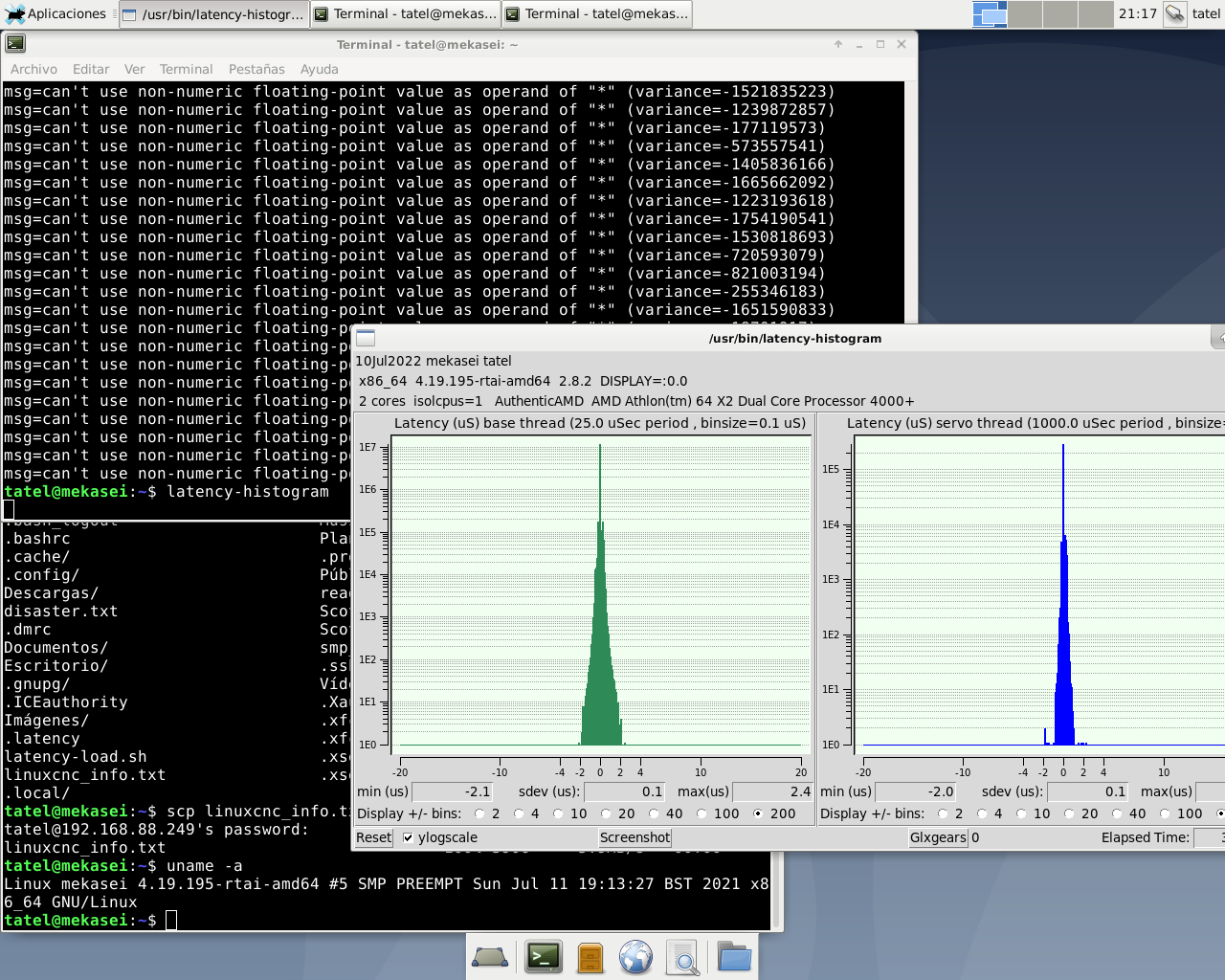

I'm getting random fails with latency-histogram. Even on a fresh install --using RTAI-- it can take quite a bunch of seconds to start; then it shows min servo latencies of -24,7 usecs (base) and -999,7 usecs (servo). It doesn't updates for about other 40-50 seconds, the it starts to update and to throw messages
can't use non-numeric floating point value as operand of "*" (variance=-1521835223)
But sometimes it starts without any problem. Please see screenshot; there you can see how it's working fine just after killing a previous fail.
Tried latency-test. It started fine at first attempt then on another try got stuck signaling 0 usec latency. I tried latency-plot just once and it worked fine.

And here you can see the previously mentioned screenshot:
https://justpaste.it/827de

Not really much to do in this BIOS, but processor.max_cstate=0 and nosmt have worked wonders. No latency problems here, but latency test software problems. Since I got the same behavior twice in a row with two different distros, I tougt it could probably be worth to report it.
Not really sure about how to upload pictures to this forum, do you mean to attach them? Well I'm going to try ...

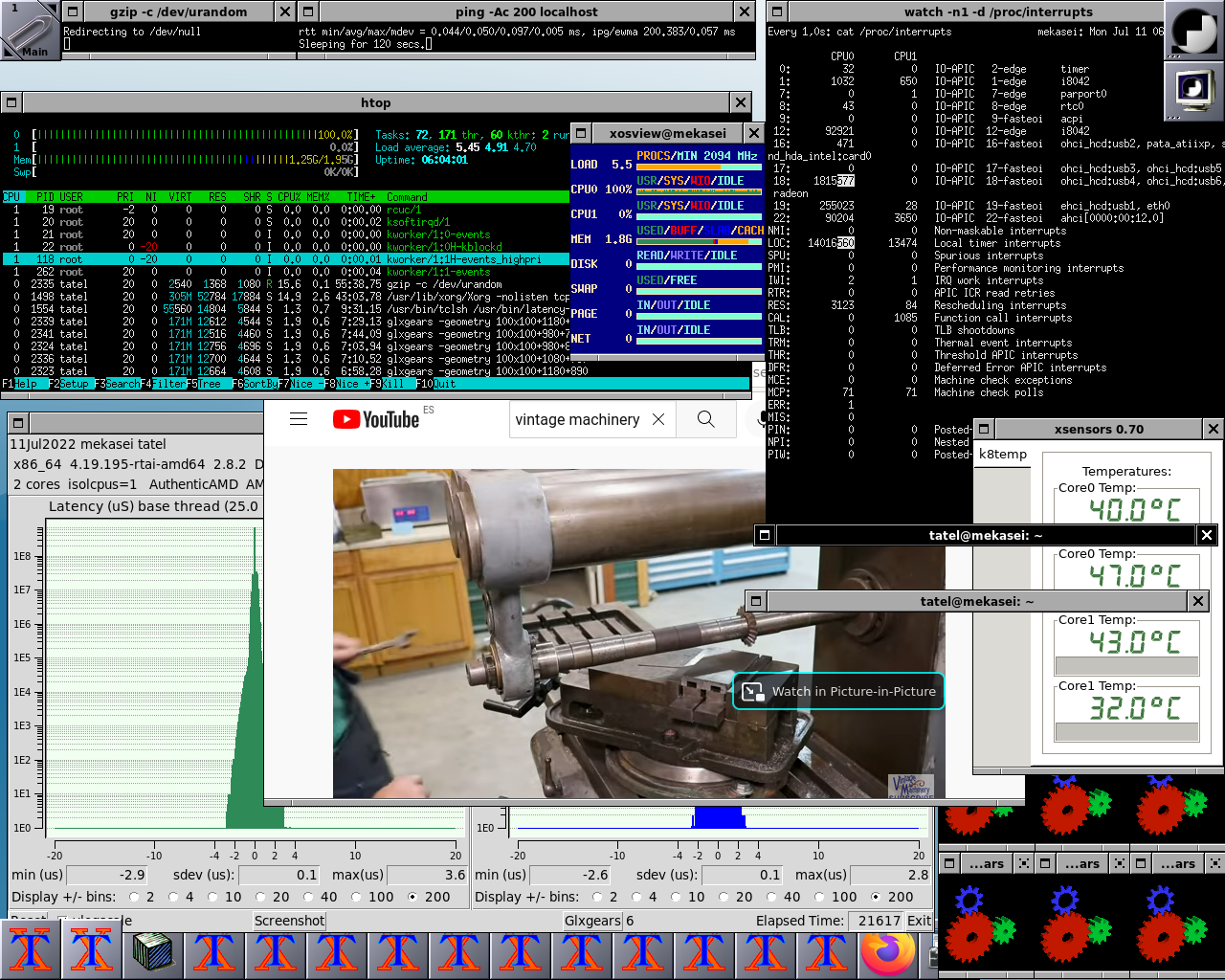

Here's the picture from yesterday's post
Here it is dmesg output, it turns out that there is an overrun reported, but latency-histogram did say nothing about it. It correspond to the first picture in this post, that test is still running with reported max latency 3.6 usecs
