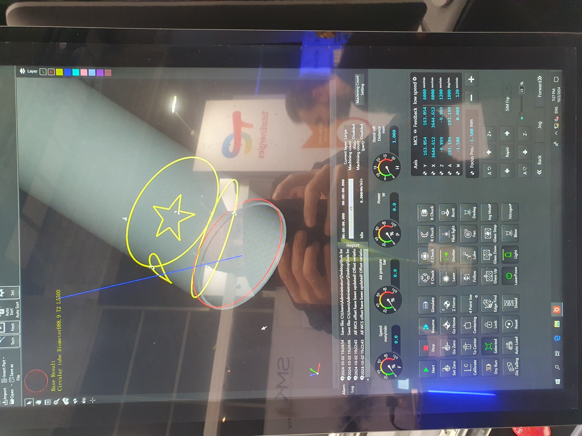

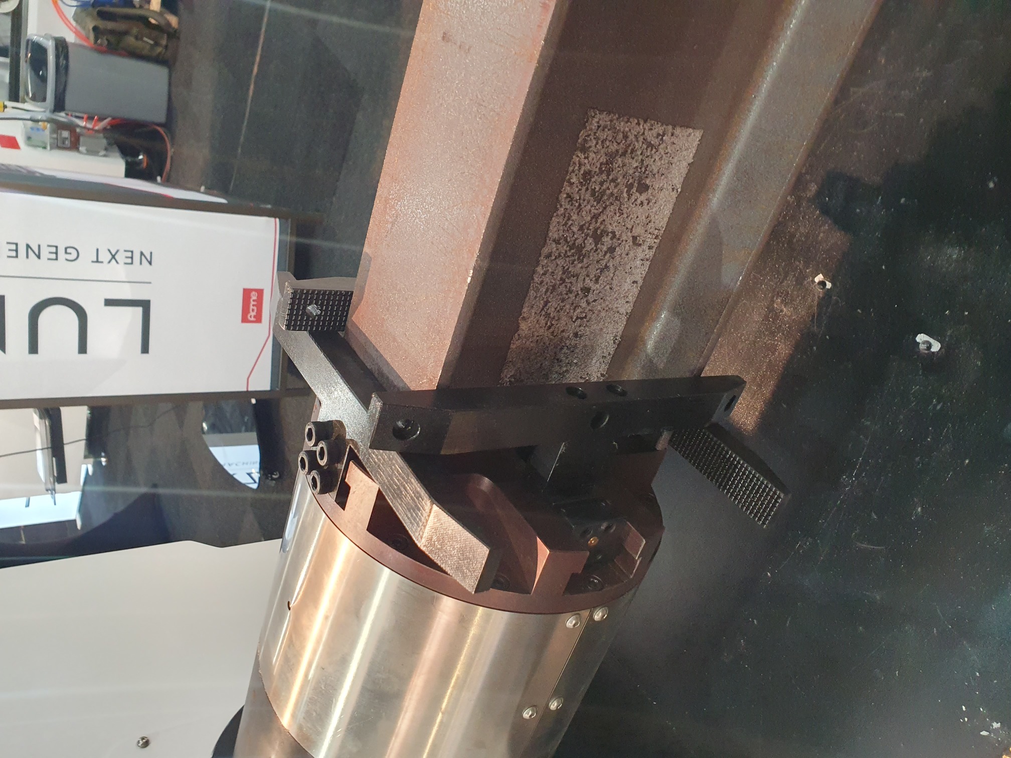

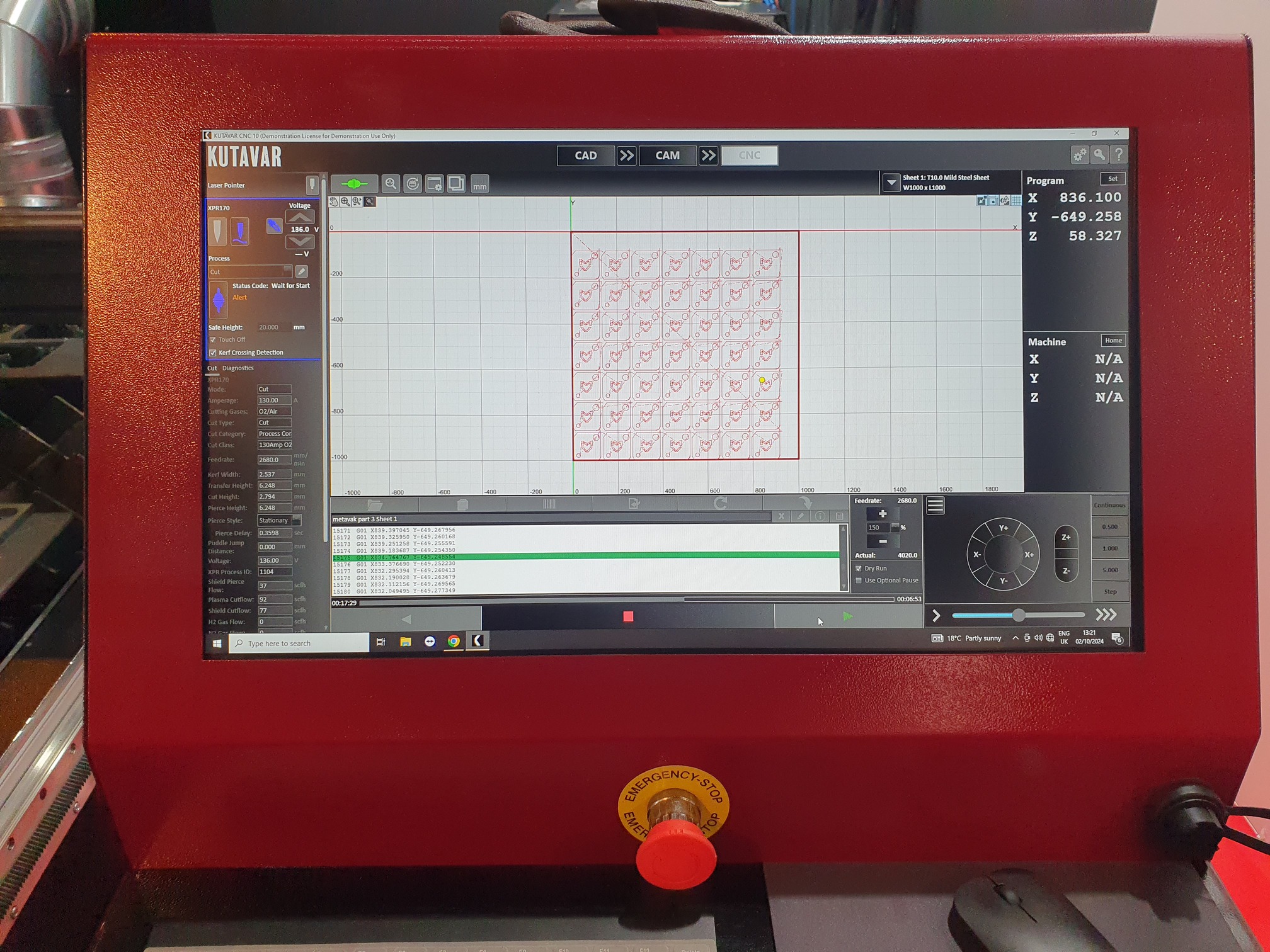

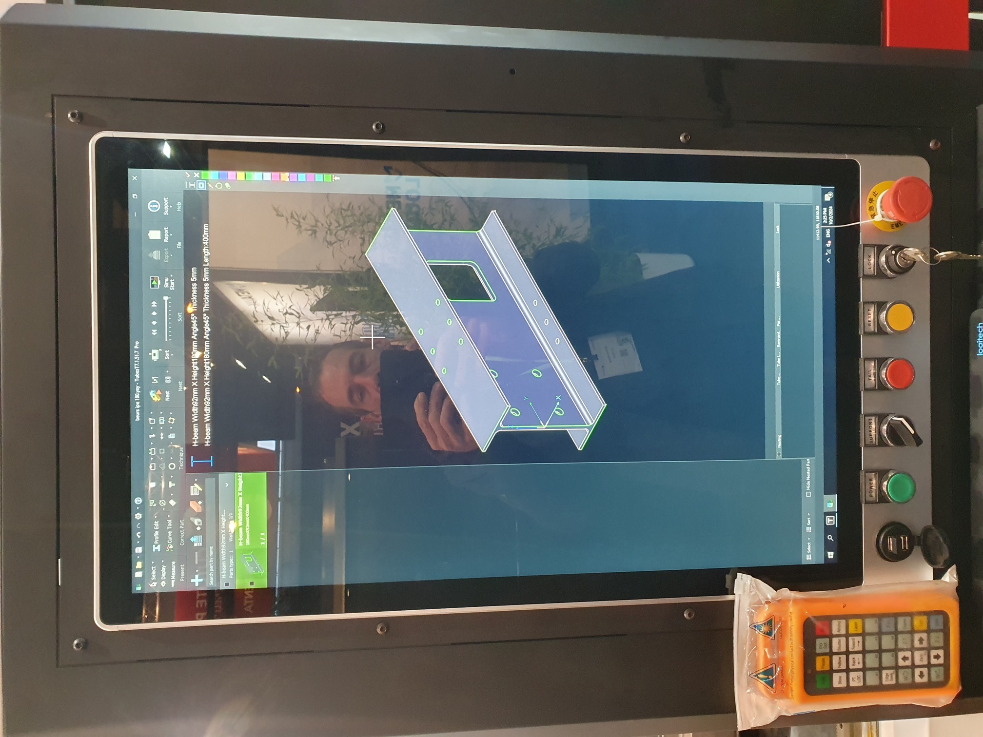

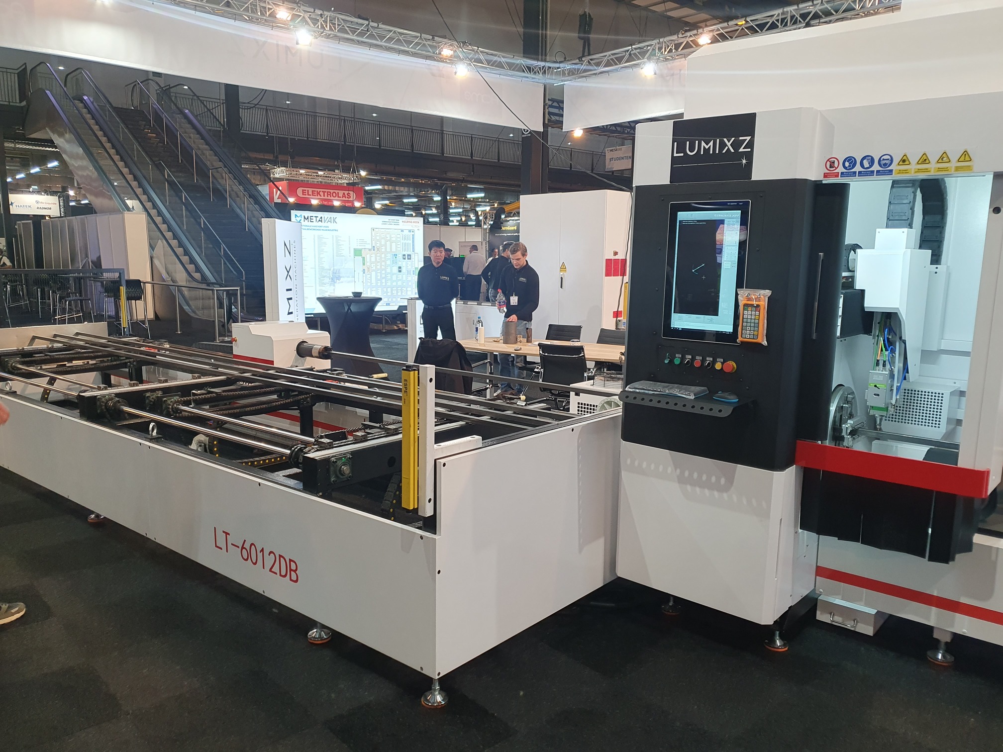

The websocket server & client are now updated to exchange json data. This works fine.

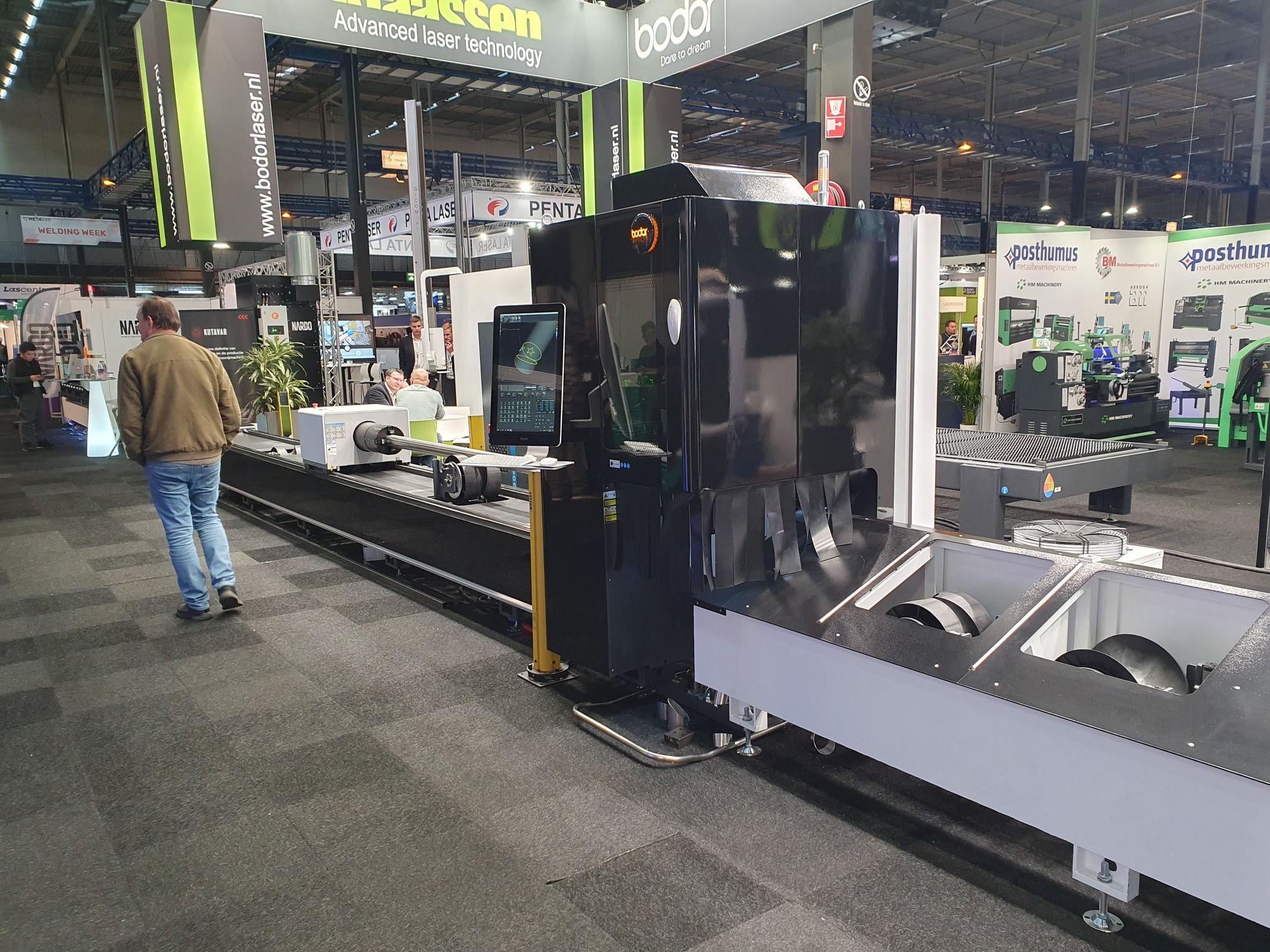

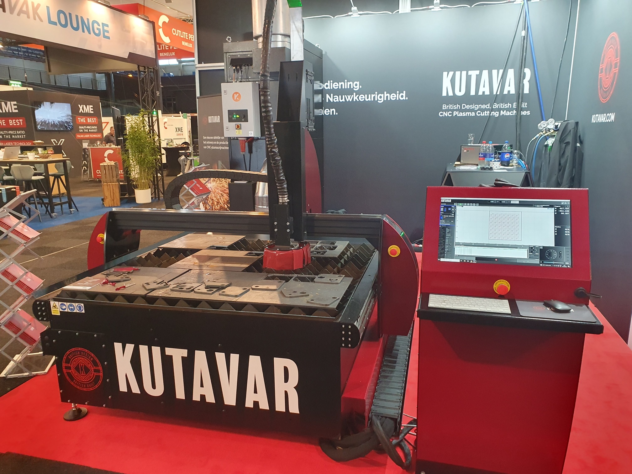

For information a few pictures of the exhibition yesterday. So all these machines have a windows gui running.
Esab refused me to take a picture of their 5 axis cutting machine.
The swift-cut (now esab company) uses mach4 i guess, everyone knows how this looks like.
The kutavar is the next generation with my compliments to the software.
Kutavar is a english brand, located left to London on the map. The software they use is external made.
The software brand they use also delivers or advises the servo's for the Kutavar machine.
The kutavar uses software where you can do cad, cam and cnc in one program.
In England is easy'er to get hands on a Hypertherm high defenition as system integrator.
Then there are several tube cutters using laser, chinese brand, start price 75000 euro.
Tube cutter > 100.000 euro.

I dont know why someone would refuse from a picture, crazy as you can just google it…
Esab’s DMX bevel head is one of the nicest ones in the market, the simplicity is just really good.
Kutavar, former ESCCO, uses flash cut. Getting highdef from Hypertherm “easier” I call BS.

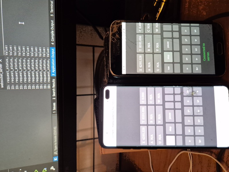

Ok the websocket server runs on the production machine. Then i have 2 phones, they are now the "multiple"
clients connected to the production machine using a webbrowser that loads a html file.
The phones can now stop or start the production machine trough a web browser.
It works.
The phones only run a file called index.html.
This file starts a websocket client and connects to the production machine's ip and port on the local wifi network.
Then the index file polls the positions for 9 axis. The production machine only sends x,y,z axis position.
The phones may  sends commands, like stop or start. This works also.
So now in fact any device can be used to interact with a specific production machine using a web browser.
However visualising the gcode in a web browser is another story.
Test result:
For linuxcnc this could be handy to stop a machine directly when you hear a big bang from a distance.
To connect to linuxcnc, i could connect the websocket server to the linuxcnc nml's server in c++.
Then you are ready to do the same thing with lcnc.
