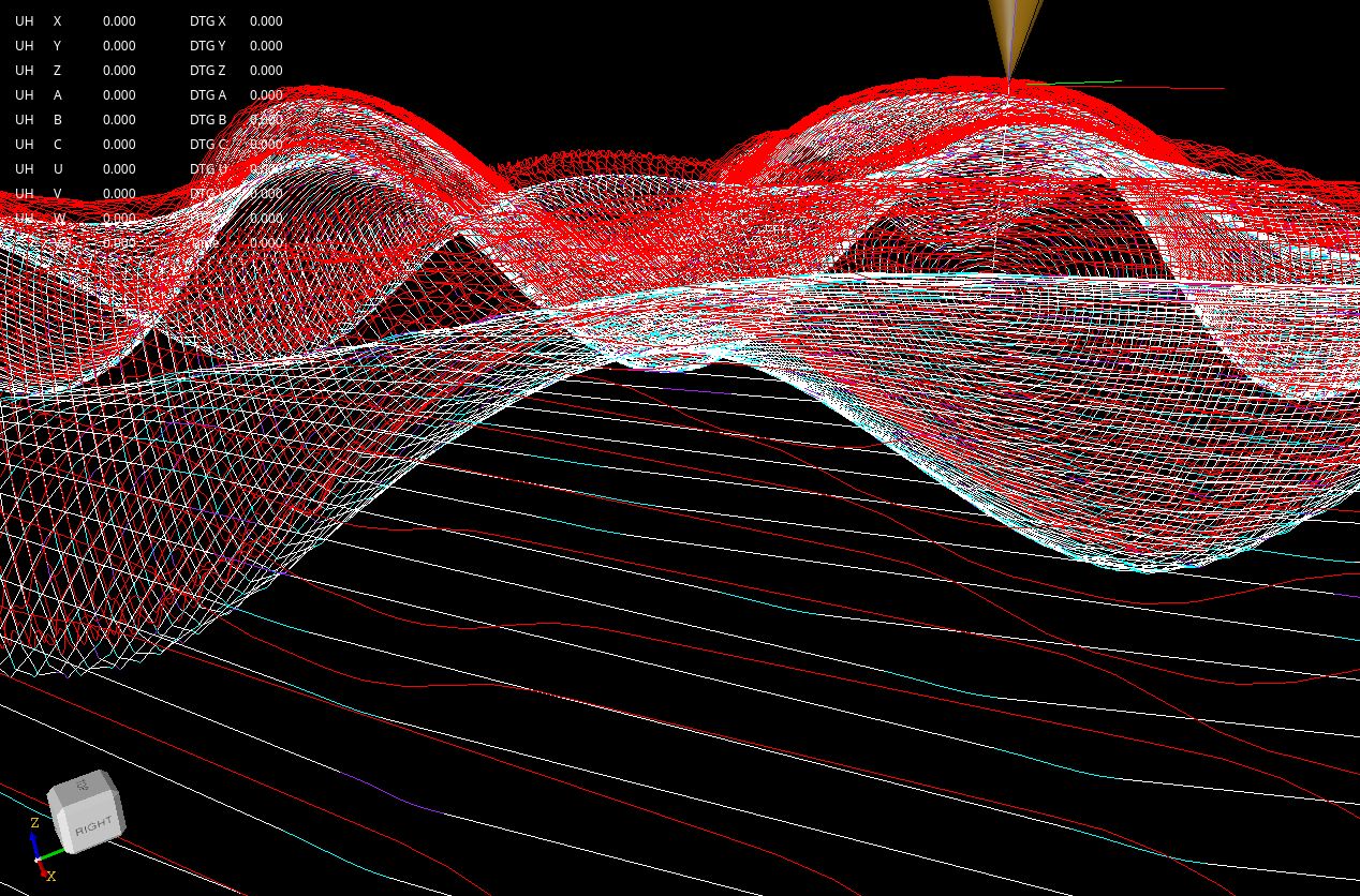

This file has ~12500 lines of gcode.Used G64 P0.5 Q0.5
red=3d velocity profile
white=line
purple=clothoid fillet
cyan=spline fillet
It's now almost time to test the results on a realtime kernel.
Let's work on to that.

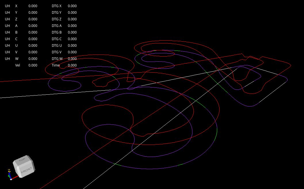

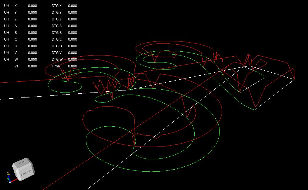

For a letter test:
Original input G64 P0 Q0.5
Input G64 P5 Q0.5
The spikes from the velocity profile are gone !
white=line
cyan=spline fillet
For a letter test:
Input G64 P5 Q0.5

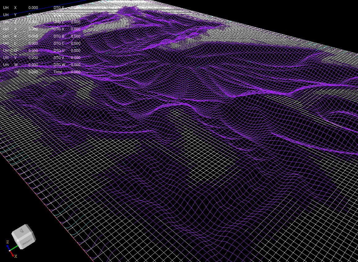

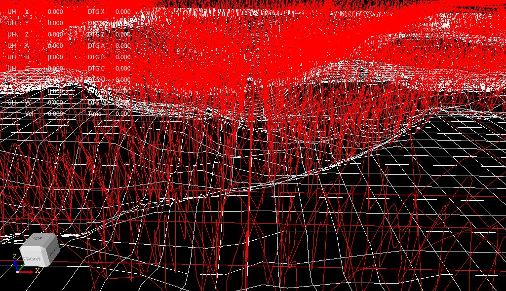

I tried a free gcode file, a griffins logo. File about 14000 lines.
www.cnccookbook.com/g-code-examples-file...for_Milling_Machines
In the file no G64 P.. Q.. was given. Raw output :
Then i added G64 P0.1 Q0.1
The output :
Then without the velocity display :
The purple are all clothoids. Cyan is spline, White is line.
File specs :
items G64 P.. Q.. before:14151 after:28292 diff:-14141
So the gcode file is increased by 14141 segments.
Maybe test some more files?

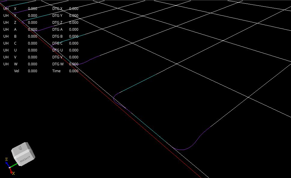

I understand that lowering the value will create smaller deviations. What I'm concerned about is the predictability of the maximum deviation a certain G64 Pn Qn command is going to produce as knowing this is crucial for CNC application.
I know we've had this discussion before but if 'G64 P0.1 Q0.1' means a maximum path deviation of 0.1 mm then those white GCode lines would have to be 0.1mm apart which seems a bit hard to believe (but of course I do not know for sure).
