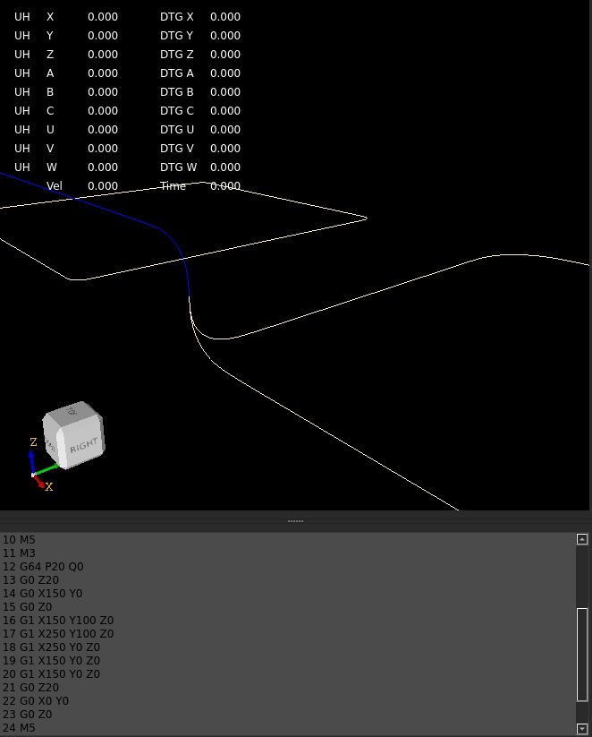

unless the minimum radius setting would not allow for the transition to move from the previous line plane to the new line target plane maybe?
Yes, it's likely that the vertical move from the G0 traverse to the G1 contour depth is too short to create a fillet that satisfies the limit of curvature so it basically decides to take the longer route. Not sure how easy it is to detect such cases in the algorithm but it is going to be absolutely crucial to get this rock solid.

When the travelheight is 20mm and the fillet radius is 20mm the result is valid :
When travelheight is 1mm and the fillet radius is 20mm "G64 P20",
The G0 z line from z1 to z0 is 1mm. This line is then trimmed by the algo on both sides
back to minimal lenght ~0.001mm, as it can not be trimmed back 20mm.
The attached line on the xy plane, the next gcode line,
is long enough to be trimmed back 20mm on both sides,
so when this happens, the clothoid curve will go below the xy plane in z.
Technically this is correct to do so for the algoritme. In practical sence this is unwanted for the workpiece.
As it damages the surface.
One solution: In cam programs, the travelheight has to be at least the G64 P..
Another solution: In the fillet algo, we could measure the rapid heights for G0's rapids and use this as a max for the G64 P.. value.
We have to do this for each plane, G17, G18, G19. But then still if you use G1 rapids, it still create's a fillet that
damages workpiece.

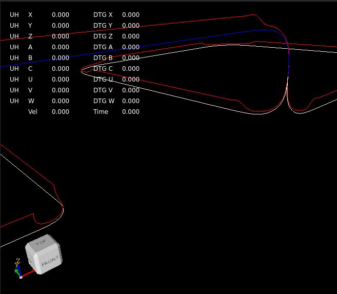

Here we tested a velocity profile based on current curvature along the path.
The red line is a interpolated velocity offset along the path based on the shape's curvature input.
This is interesting.
*Note that the line has zero curvature and speed is constant.
*Note in the lower left of the picture the red line has sharp transition corners, this has a reason i figured out.
The maxvm for the path is set at 250. The clothoid at curvature=0, may have a higher speed and it lowered down.
This results in a sharp speed transition edge.
Last edit: 27 Jul 2024 10:23 by Grotius.
Indeed, very good idea to plot the velocity on top of the tool path! Thanks for sharing.
