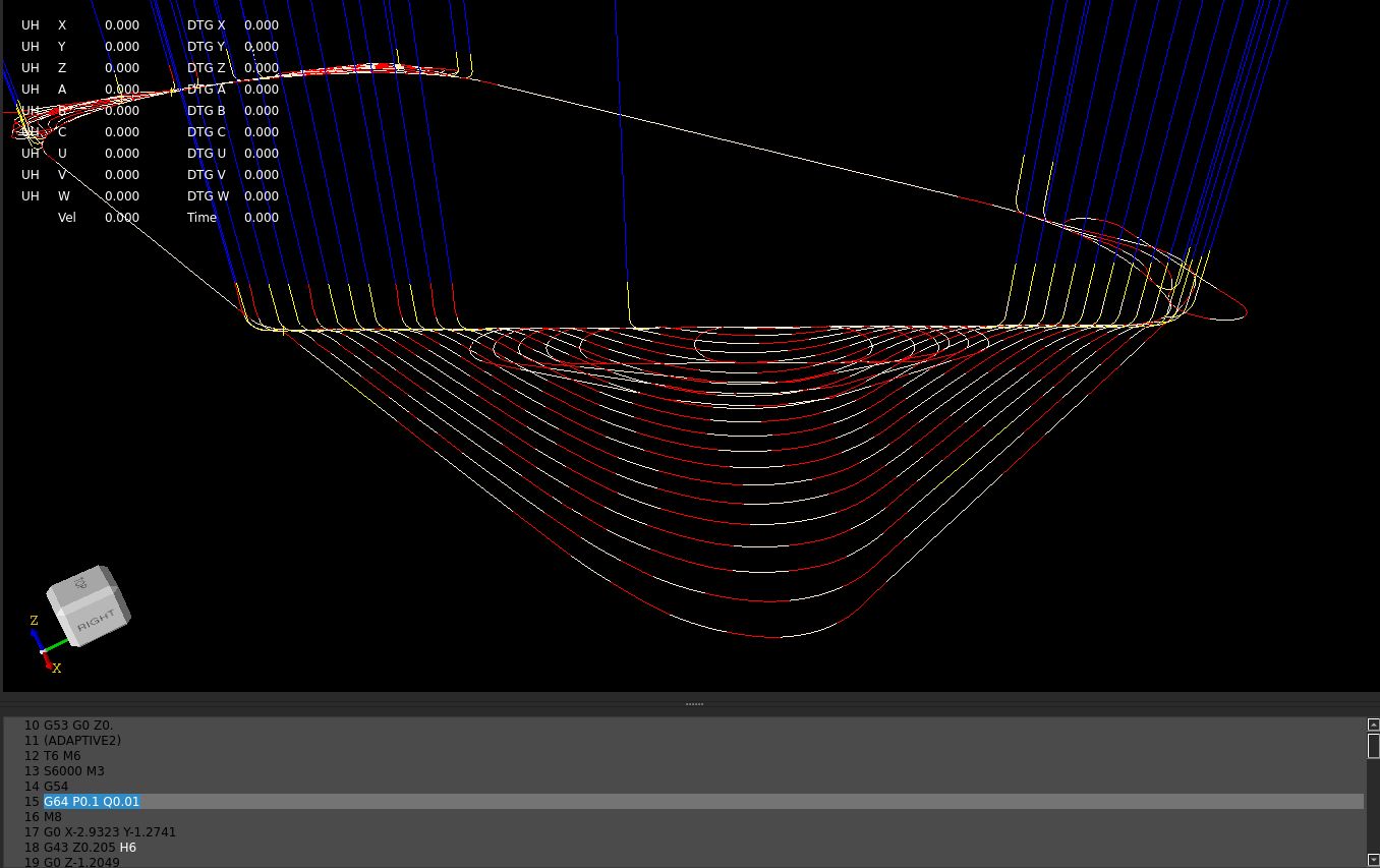

Working on the toolpath blending algoritme.
It's using the gcode G64 P.. Q.. values along the gcode file.
Red are the clothoids, valid in a 3d plane.
Yellow are lines, this are invalid clothoid solutions, out of plane, that we have to port to a spline fillet tomorrow, as
alternative fillet solution.
The settings for G64 used : P0.1 Q0.01
Where P=deviation, creates the fillet.
Where Q=tollerance, filters out only line segments.
// Results of this optimalisation test:
items before G64 P.. Q.. :1214 after:1330 diff:-116

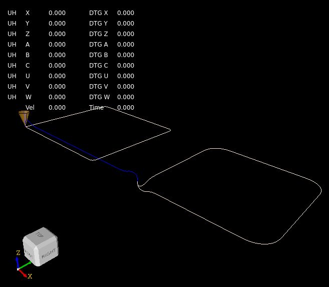

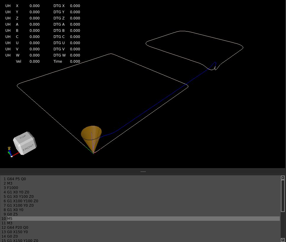

24 Jul 2024 10:36 #305948 by Grotius
Replied by Grotius on topic Trajectory Planner using Ruckig Lib
The spline fillets are working. These are used when clothoid fillet fails.
Tested multiple G64 P.. inputs along a gcode file.
The first square is original a G64 P0 with sharp edges.
The first G64 P5 creates ~5mm fillets along the path of the square shape.
Then the second square, the P20 creates ~20mm fillets along path of the second square shape.
The fillets are of type clothoid. Then there are rapid clothoids and feed clothoids, This is important to notice
to do look ahead and optimize speeds further on.
codeberg.org/skynet/hal-core
The following user(s) said Thank You: akb1212, Lcvette, Aciera, Darium

26 Jul 2024 14:08 #306094 by Aciera
Replied by Aciera on topic Trajectory Planner using Ruckig Lib
Looks like there is a bit of a problem there:
I don't quite understand why the fillets go above the G0 and below the G1 moves.
The following user(s) said Thank You: Lcvette, Grotius

26 Jul 2024 14:41 #306095 by Lcvette
Replied by Lcvette on topic Trajectory Planner using Ruckig Lib
are the two drawn squares of the same code with different trajectory plan methods applied?  if so, then I am wrestling with two thought trains.
The first is me thinking that the Z start/end threashholds should NOT be violated as i could see that being problematic and arbitrarily gouging into parts when repositioning and increasing the cut loads beyond he commanded settings.
The second is that it is really not any different than the way i currently plan the tool paths when roughing and setting smoothing tolerance and stock to leave in the XY cut plane.  That said, i do notice that in cam the z heights do not violate the set bottom height of the selected geometry regardless of the smoothing and or tolerance settings.  if linuxcnc currently does  have not seen evidence of it.  of course i typically set the smoothing values in LCNC fairly low, typically not more than 1-3 thousandths so would be difficult to see that when using a stock to leave with enough cushion for it not to show up on the finished part after finish passes are complete.
interesting situation, i am curious to hear more on it from Grotius.
As always, Thank you for the awesome work and effort on this amazing project!
Chris
The following user(s) said Thank You: akb1212, Grotius
  • Lcvette
  • Lcvette's Avatar
  • Away
  • Platinum Member
  • Platinum Member
26 Jul 2024 14:46 #306096 by Lcvette
unless the minimum radius setting would not allow for the transition to move from the previous line plane to the new line target plane maybe?
The following user(s) said Thank You: akb1212, Grotius, Aciera
