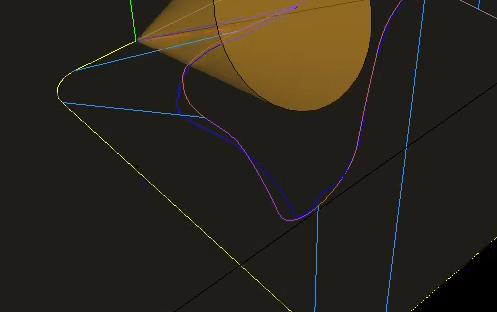

Hm, seems to me that the recorded (blue) path deviates quite significantly from the displayed smoothed tool direction path.

@Hi Arciera,

I tracked down the issue. One important issue, that was responsible for wrong cone preview angles.
The other issue i will show you in video.
The important issue was a function that calculated the abc angles from a given tcp & ta point in space.
The function was using atan... for 3 planes. However, it did not output what we want to see.
Now i changed the function to use a quaternion with config : gp_Extrinsic_XYZ. new function. This seems to work properly.
Now in next video i recorded tooldir axis lines, to show you what is the difference between
1. recorded tooldir path
2. blended or optimized tooldir path.
In the video the vertical axis lines can contain 2 different colors. One color is for recorded tooldir path. Other color
is for blended tooldir path. The axis lines can be off different lenght between path's. However they are valid as they
are on the same plane.

Yes I see, the smoothed tooldir line does not necessarily retain the constant distance from the tcp path which is fine since we are really only interested in the direction of the tool vector.
I'd say this looks quite promising!
So, does the smoothing process ingest a gcode file, process it according to 'smoothing' parameters and then output another gcode file? If so could this output file be run with the current Gcode Interpreter/ trajectory planner?

We can do so. We could write a tooldir blended gcode file out. This then can be runned in the current interpreter of linuxcnc.
But i heard, when a,b,c are involved it falls back to no look ahead mode.
So maybe with a trick it can use look ahead for xyz, and then just output the interpolated a,b,c values?
