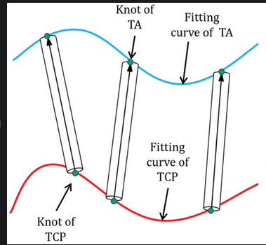

If i draw the tool orientation vector lenght:10mm at each gcode line. Or at each known position.
Then i connect these tool orientation's at the top with a poly line.
Then create fillets inbetween the polylines? Then set tool orientation vector to touch the fillets?
Yes, that is what I'm thinking.
This image is from the preview of the paper linked above. The tool position is the curve in red and the tool orientation is the curve in blue. The blue curve would be the G2 continuous representation of the polyline that connects the green dots marked 'Knot of TA'.
Mind you, I have not really thought about what a particular machine's kinematic restriction will mean when using this approach. If we have a machine with only an A-rotary then we may not be able to orient the physical tool to the calculated (smoothed) 3D angles (ABC).

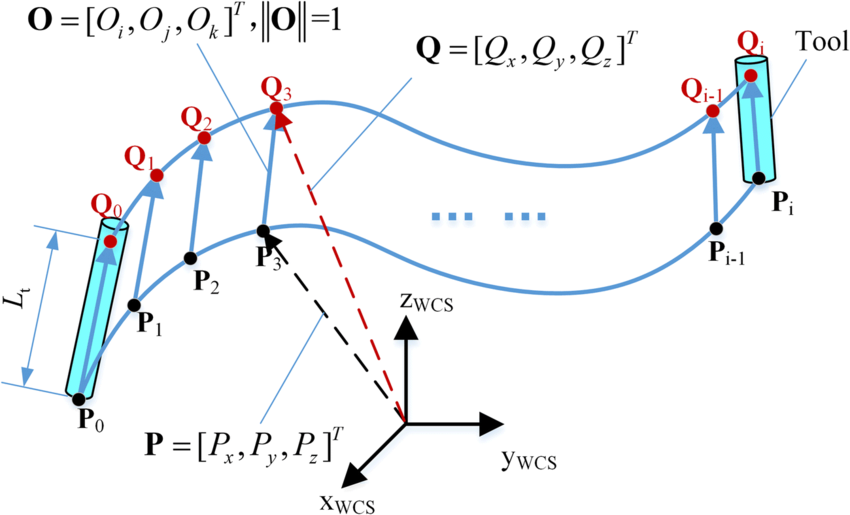

I'm still a little confused how to solve this 5 axis geometry. Especially caluclating the inbetween TA knots.
say we have a gcode line:
G1 X1 Y2 Z3 A10 C20
for the end of each segment we have the toolposition (TCP knot in XYZ coordinates) and the tool orientation vector (using the A and C angles in this example or by whatever angle(s) the kinematic for the particular machine uses eg A, AB, BC ..)
The corresponding TA knot is offset from the TCP knot by a fixed distance (say 10mm) along the tool orientation vector.
02 Jul 2024 16:24 - 02 Jul 2024 16:25 #304259 by Aciera
Replied by Aciera on topic Trajectory Planner using Ruckig Lib
This is another image from the link:
The current tool position XYZ (ie the TCP knot) is at the center of the sphere.
The current  tool orientation  (black arrow)  is defined by angles 'A' and 'C' in red (ie this would be an XYZAC kinematic), the vector points to the corresponding TA knot (green dot, here called 'TO' knot) a certain fixed distance away.
The other two green dots would represent the previous and the next TA/TO knot for the previous and the next TCP knots.

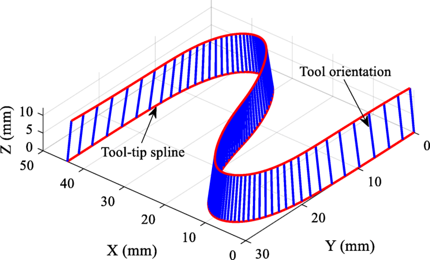

Here is another image that shows the tool-tip spline (ie TCP/ tool position) the tool orientation in blue and the resulting tool-orientation spline:
This might be the best one ('Lt' would be the fixed distance), Points 'Pn' would be the tool positions (XYZ) and Points 'Qn' the 'TA knots/ TC knots':
