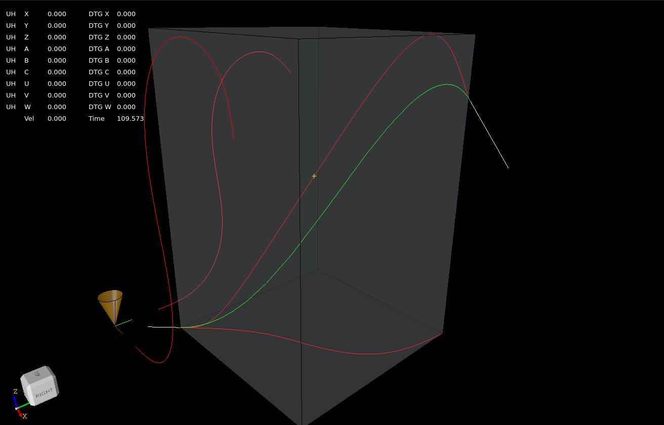

08 Jul 2024 20:18 #304695
by Grotius
Replied by Grotius on topic Trajectory Planner using Ruckig Lib
Hi Arciera,
After investing more time into the 3d clothoids. I wasn't able to get it work like it would be. So now the
green line is a bspline 3-degree. This works ok.
Let we use this bspline for the toolpath fillets.
You see there is a differance in clothoids and or bspline. The clothoids are bigger curves.
So tomorrow i can integrate the b-spline into the trajectory planner, it needs interpolation function etc.

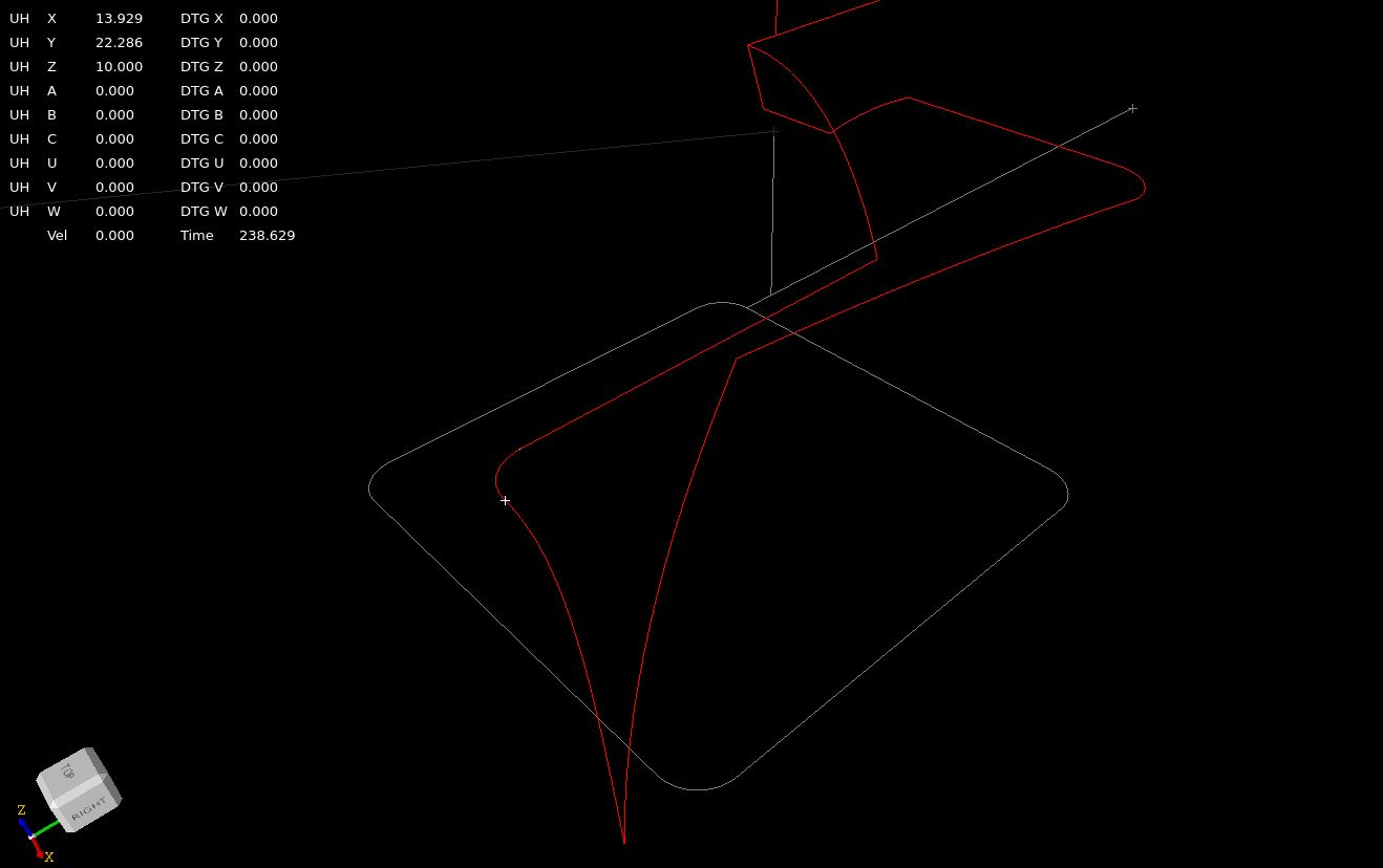

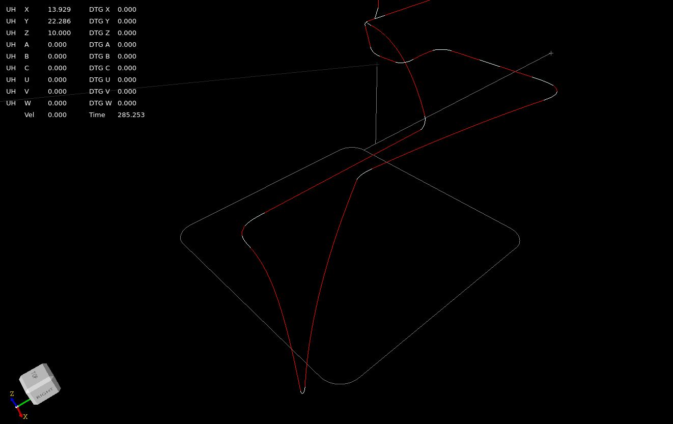

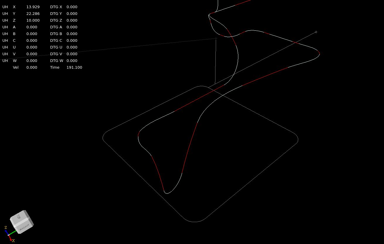

10 Jul 2024 09:53 #304793
by Grotius
The algoritme for tooldir blending works finally.
The algoritme does :
1. It trims the recorded tooldir path for each gcode line on both ends.
3. It draws a 3-degree bspline given 4 points in space.
Tooldir blending 0mm, blending turned off.
Tooldir blend 1mm
Tooldir blend 5mm
Tooldir blend and tooldir record in blue. Where blue is the original recorded tooldir path without tooldir blending.

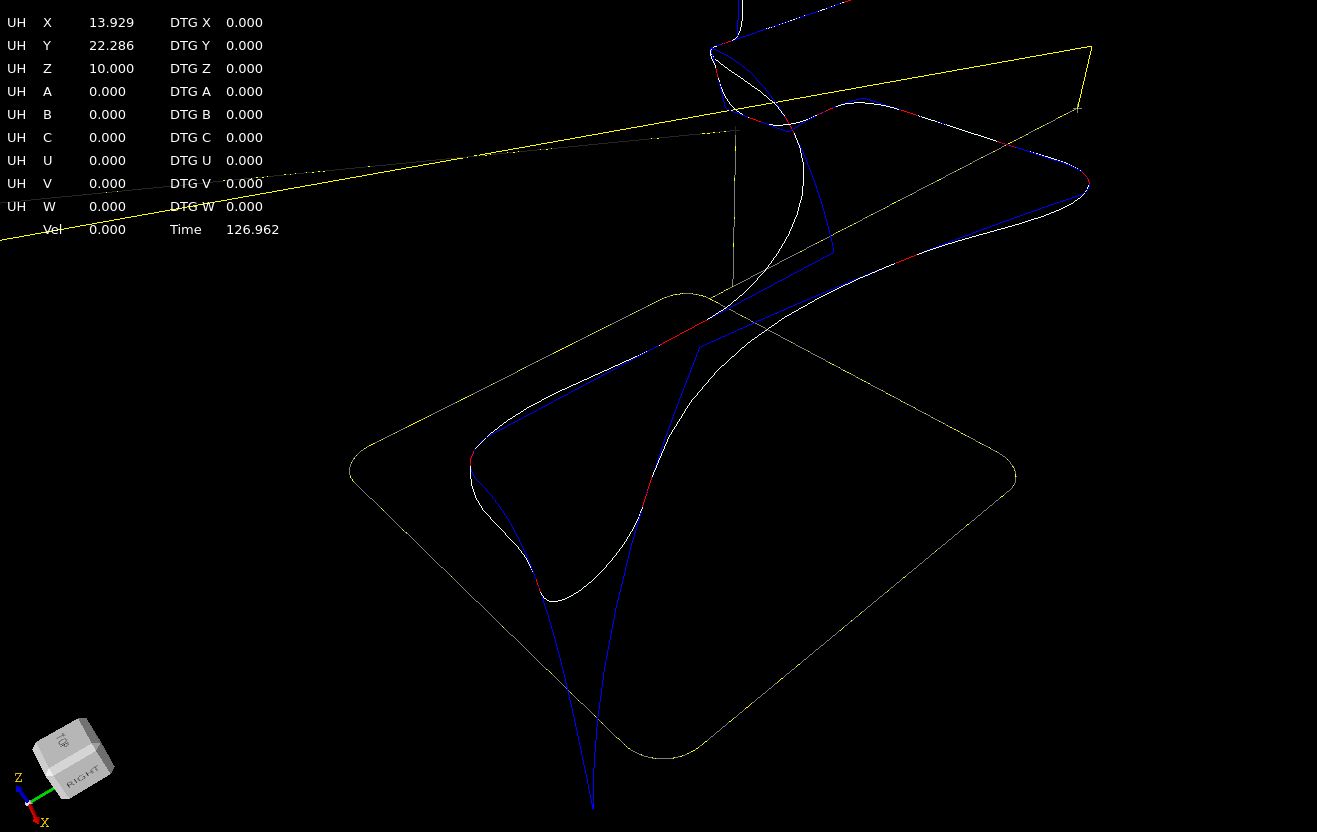

10 Jul 2024 11:23 #304803
by Grotius
@Hi Arciera,
Yes the deviation is within 5mm. It's less then 5mm.
The blend value is used as trim value seen from intersection point of curves.
Each curve has a trim value on both ends.
Now i have a little video, that shows also the tooldir symetric axis are updated in blue.
Now also a hard part comes. For each gcode line i need a correspondenting gcode tooldir path.
So i have to split the b-splines at the blue tooldir lines. Then i need to regroup a few curves together.
