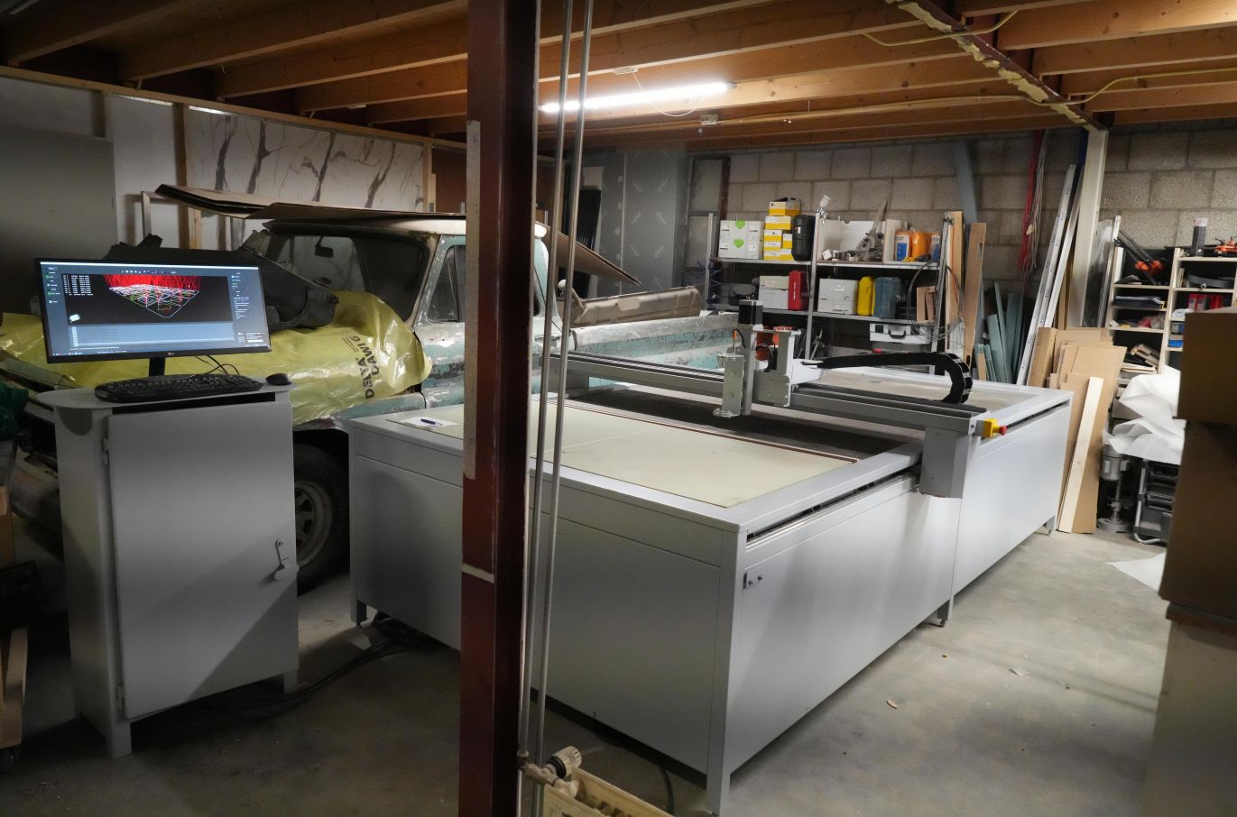

09 Aug 2024 20:58 - 09 Aug 2024 21:26 #307386 by Grotius
Replied by Grotius on topic Trajectory Planner using Ruckig Lib
Hi guys,
Tonight i did a test on the ethercat production machine, i brought a pc for the machine, pre installed linuxcnc and halcore on it.
This pc was already tested ok on the ethercat test board.
At the machine, after a while i came to the conclusion that one of the lcec output module's was broken, the stepper dir module.
altough it's brand new.  So maybe it is thanks to Stuxnet that i had so much trouble this week.
I had to drive to home again, and get a other lcec module. Then replaced it, and it worked.
But then the 24v input's where a problem. The input lights are burning on the module, but in halview, no signal is incoming.
So that's a problem i still have to solve. It was no problem for testing the machine altough.
Ok i made a few video's to show you.
The machine is never used before, and is software limited to 15000mm/min, it can run up to about 19000mm/min.
The machine has 2 x-axis motors, 1 for y, 1 for z. The machine setup is backslash free.
At the time it was configured with steppers. Nowaday's i think i would use servo's.
The machine in the workshop, the workshop i a collection of items, you see an old car in the background.
First video, running halcore.
Surface test.
Lcevette file milling, tiny product.

10 Aug 2024 22:56 #307445 by Lcvette
Replied by Lcvette on topic Trajectory Planner using Ruckig Lib
@Grotius
the model/gcode is in inches for that last video..lol  maybe try it in inch to see the correct moves?  :D :D :D
i couldn't tell if the machine was moving..lol
