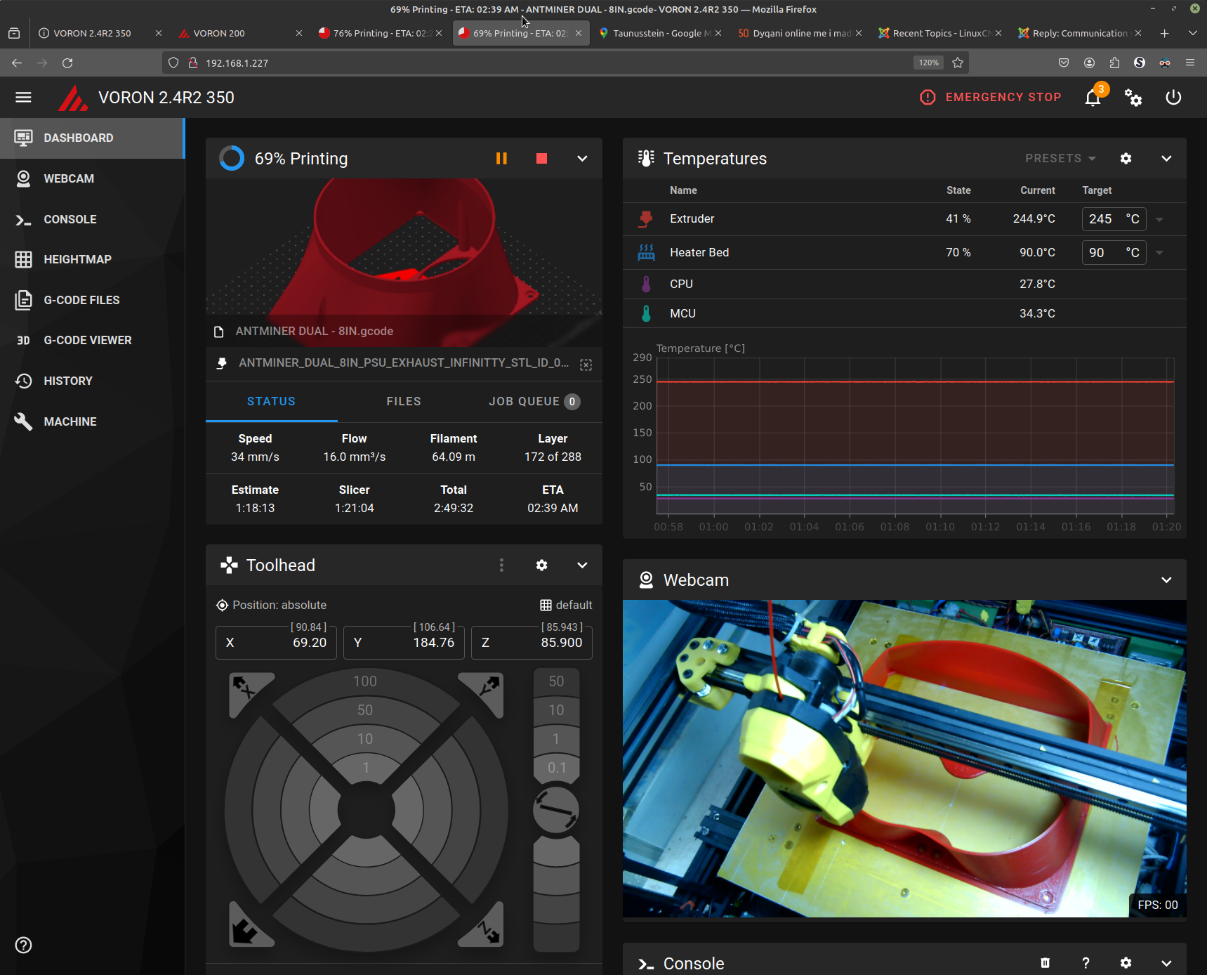

Replied by tommylight on topic Communication solution on my own CNC Machine
I am thinking i should stop watching MythBusters on youtube and go to the shop as i have 2 of 3D printers running 24h for several days now, i need sleep, just had popcorn, been working for 4 days on building another Voron 2.4R2 printer and i am close but having to shove 2 control boards with power supply and a huge amount of cabling inside a small box is to much work.What are you thinking?
