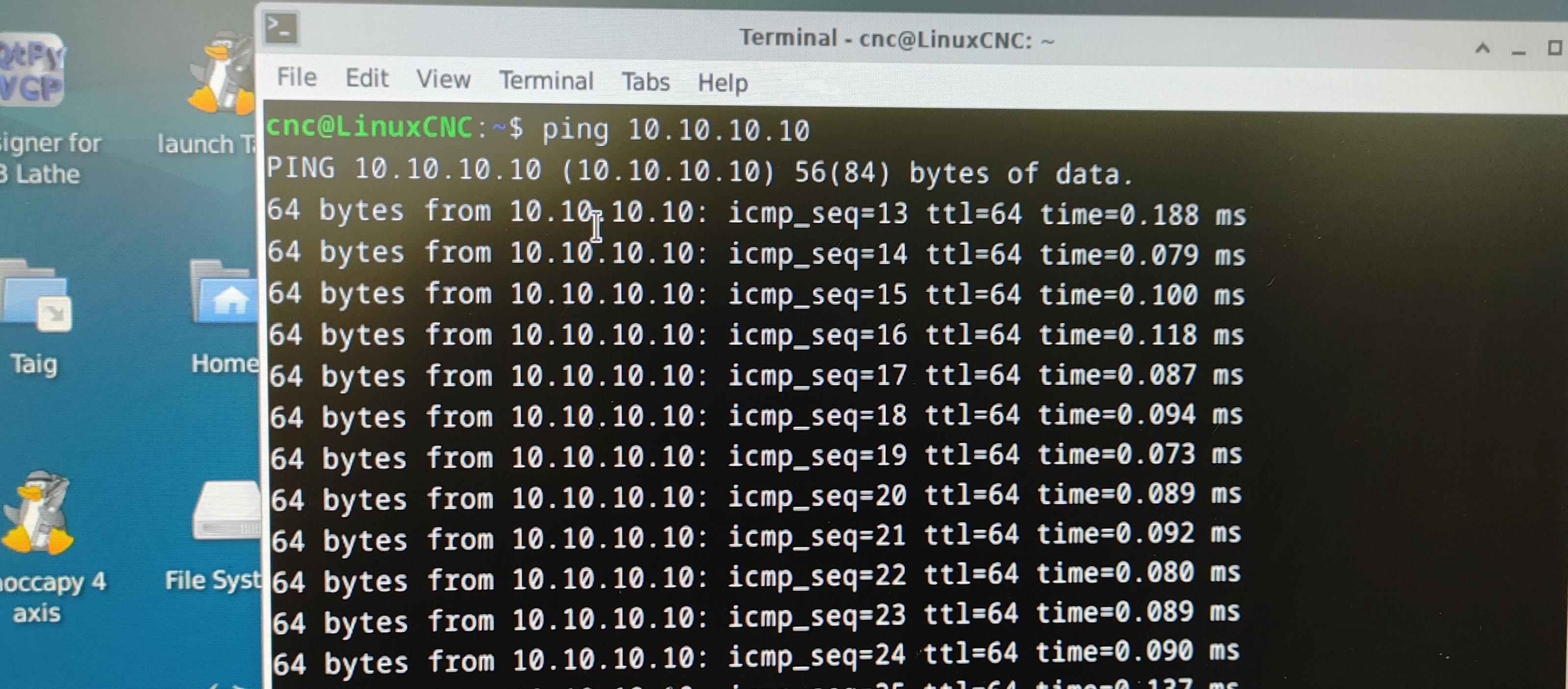

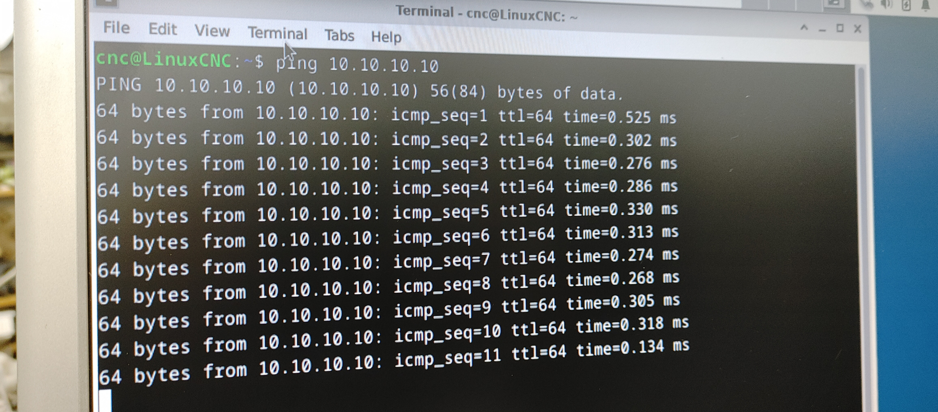

i wired it like you said, no change. when i hook a multimeter to the 7i96s, i dont get movement in voltage while i went thru config and set the motor tune to move up down 1in with no pause.
how do i check for a bad board?
i have tried two different motherboards, and an add on network card, powered the mesa with a benchtop power supply. im deep in the mud.

So you are saying that running LinuxCNC, you jogged in either
direction and the direction signal for the jogged axis does not change?

i have been playing just with z axis thus far, and no there has been zero movement of the motor or voltage change with a volt meter checking the step connection on the 7i96s.
