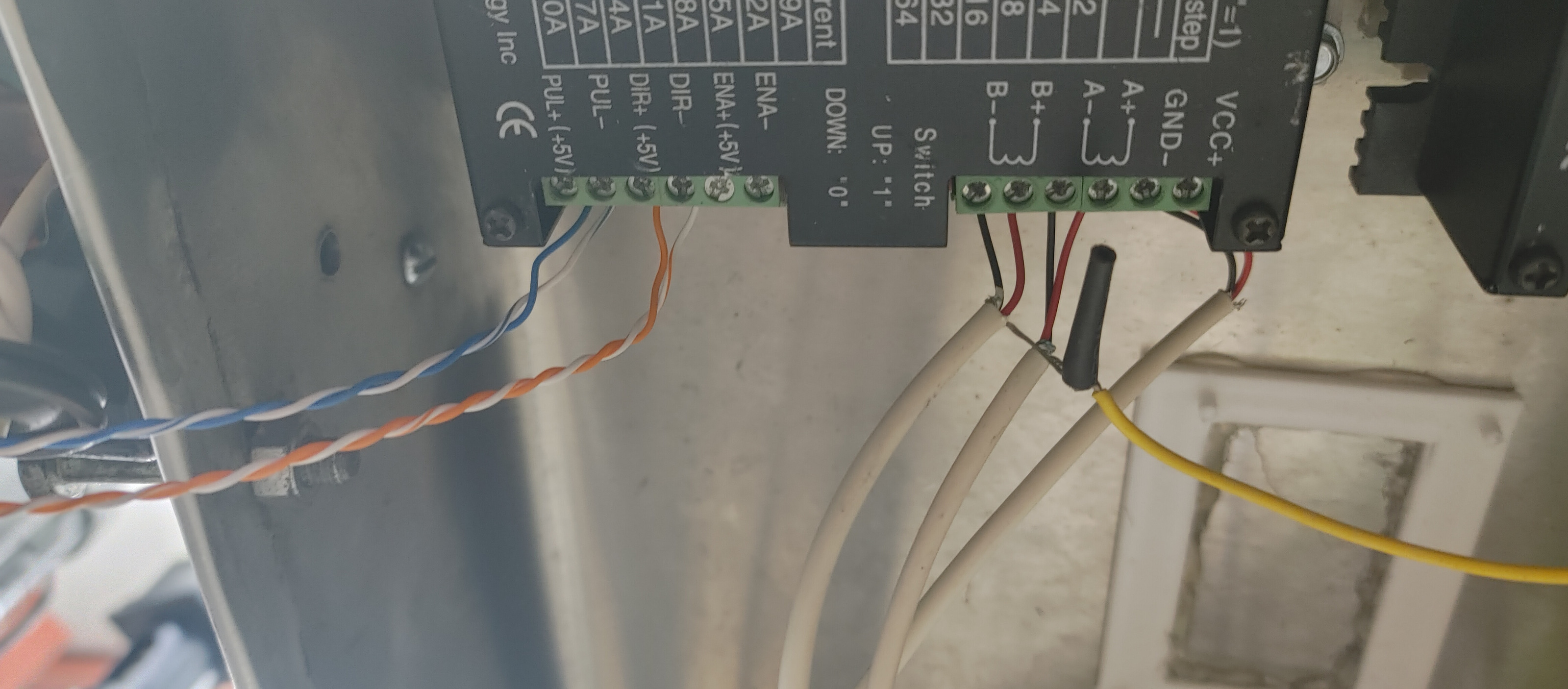

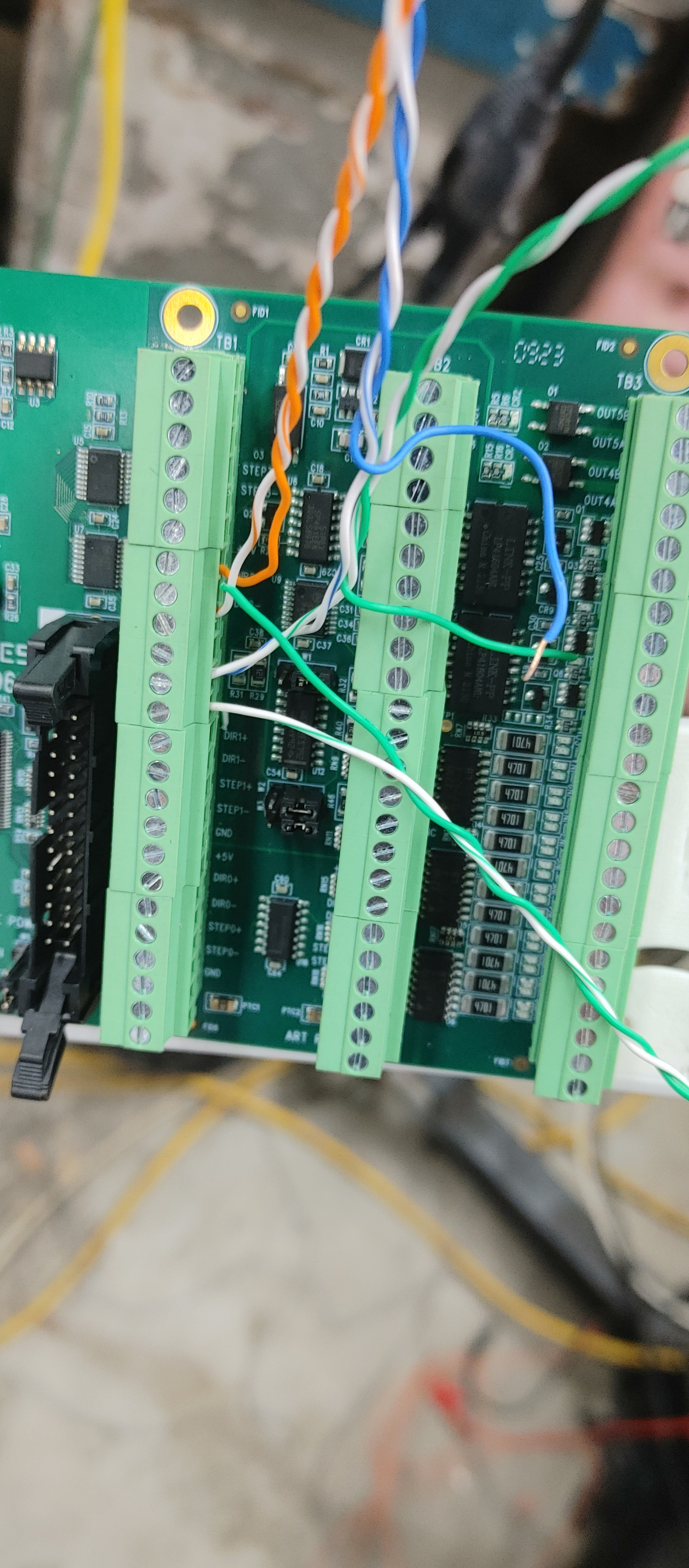

The motherboard that I'm trying now has a Serial port, I'm about to run it directly and see if it works but I need to see how to set that up. Heres how i have it wired trying to do the manual test. Dont mind the yellow wire i attached to the drain wire to keep ground loops/noise from the last setup. Its just hanging now.

Replied by tommylight on topic First time linux cnc user - no stepper movement.
No wonder it does not move, pulse + is not connected to anything.
pulse+ and dir+ to Mesa 5V
pulse- to Mesa step-
dir- to Mesa dir-
dir- to Mesa dir-

Replied by crazycajun on topic First time linux cnc user - no stepper movement.
That was for that "bypass" test i was doing as per instruction. I had it hooked up as you said.
omg lol it was one of two things. a: loose connection at the driver (which one wire appeared so. b: the twisted pair wiring was the issue. im about to go back to the twisted pair to test. WHEW. im just glad i got some headway made. i was really losing my mind lol
Edit: not the twisted pair. it was just a loose wire. thank you so very much for helping me work thru this!

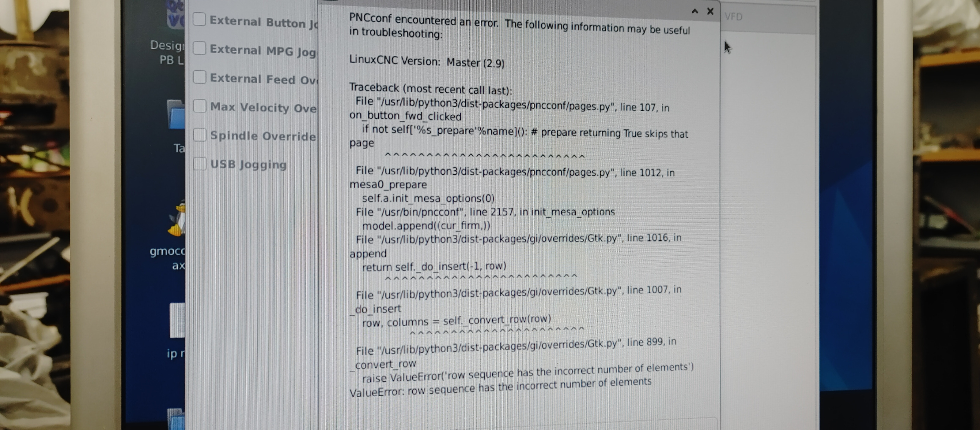

*** NEW ISSUE ***
i swapped the mobo back out because the window resolution actually fits the whole window of Lcnc.
anyway, i get an error on startup and it wont discover the board in advanced setup, but it pings 10.10.10.10
Last edit: 06 Sep 2024 15:34 by crazycajun. Reason: added report file in zip
