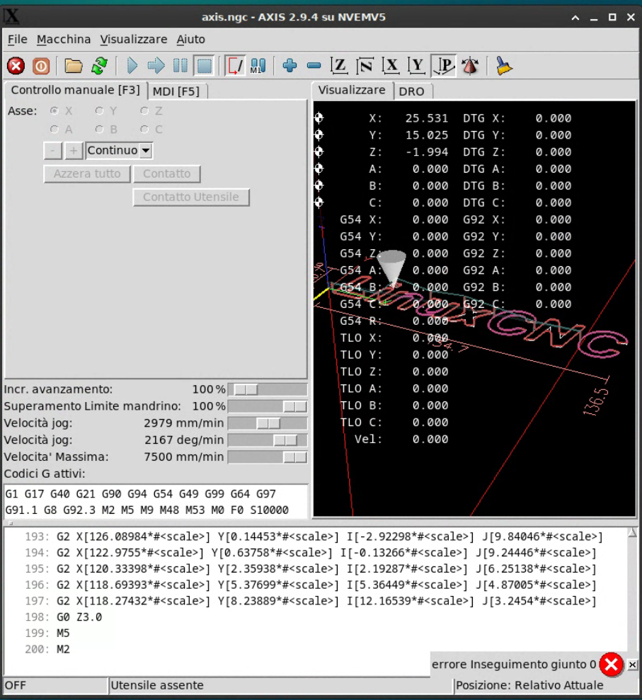

When you get an error, what does:
halcmd show param *.tmax
(typed in a terminal)
show?
This will help determine where the fault lies
show?

Warning: Spoiler!When you get an error, what does: halcmd show param *.tmax (typed in a terminal) show? This will help determine where the fault lies
Parameters:
Owner Type Dir Value Name
41 s32 RW 14985 encoder.capture-position.tmax
41 s32 RW 19158 encoder.update-counters.tmax
29 s32 RW 54482 motion-command-handler.tmax
29 s32 RW 108007 motion-controller.tmax
38 s32 RW 48125 nvmpg.update.tmax
33 s32 RW 16640759 remora.read.tmax
33 s32 RW 23424 remora.update-freq.tmax
33 s32 RW 14829214 remora.write.tmax
30 s32 RW 19134687 servo-thread.tmax
Thanks for help
I don't know the CPU clock frequency but if it's say 3 GHz, this is ~5 ms
so if you have a 1 ms servo thread, you are likely dropping packets
This indicates a network latency issue.
So possible the DKMS patch did not apply or there is still something
remaining wrong with the network setup.
I would run the ping test again, as it will show these issues clearly
sudo chrt 99 ping -i .001 -q -c 60000 10.10.10.10
PING 10.10.10.10 (10.10.10.10) 56(84) bytes of data.
--- 10.10.10.10 ping statistics ---
60000 packets transmitted, 60000 received, 0% packet loss, time 60017ms
rtt min/avg/max/mdev = 0.128/0.215/3.609/0.047 ms

Replied by DarkPhoinix on topic Which kernel version is best for real time?
sudo apt-get install r8168-dkms
Lettura elenco dei pacchetti... Fatto
Generazione albero delle dipendenze... Fatto
Lettura informazioni sullo stato... Fatto
r8168-dkms è già alla versione più recente (8.051.02-2).
0 aggiornati, 0 installati, 0 da rimuovere e 3 non aggiornati.The module is this, they are update...
NO RUSTDESK
60000 packets transmitted, 60000 received, 0% packet loss, time 59999ms
rtt min/avg/max/mdev = 0.154/0.210/0.417/0.027 msWITH RUSTDESK
60000 packets transmitted, 60000 received, 0% packet loss, time 60006ms
rtt min/avg/max/mdev = 0.131/0.213/2.341/0.035 ms

13 May 2025 15:35 #328396
Replied by tommylight on topic Which kernel version is best for real time?
You should really mention you keep using the remote desktop, not everyone here knows what RustDesk is.
And that begs the question, how is the NVEM wired to the PC?
So yes, rustdesk is causing issues, but if you are using a hub/switch, that is a big nono for machine control.
Youtube is used to stress the video subsystem as video uses interrupts that require the PC to halt until whatever is requested by that interrupt is finished, then go on to do other stuff, and so on. I am not aware of anywhere being stated you must use 4 youtube videos, if you are, please let us know so we can fix that. A single window maximizing and minimizing is enough to trigger latency excursions, so 4 are overkill and prove nothing.So why do they do these tests with 4 YouTube videos in 4k in the forum? in direct connection with stress test 100 GLXgears I can work safely even with NVIDIA! I got this AMD VGA and now I also bought a motherboard with HDMI output to pass the YouTube 4K video test!
Same thing with GlxGears, video, but easier to run, but this also uses OpenGL that is used by LinuxCNC, namely Gremlin uses it to display the stuff being cut. We use 10 as it is very lite on resources, but 100?
You keep mentioning that under stress it works fine (even unresponsive, and this is something Linux does magnificently), so you can try adding a base period and test some values till you get something that gets rid of errors/issues.
Probably something like this should do, add to hal file:
loadrt base_period_nsec=100000Please Log in or Create an account to join the conversation.

forum.linuxcnc.org/38-general-linuxcnc-q...ults?start=40#327937
100 glxgears windows += no junction error
4k youtube video (1 or 2 or 3 or 4 windows) with or not remote connection = junction error
in need put like this in hal file:
i think the problem is not video but the network load.... i can't try a youtube video offline... i do not why people tell to use this test for combo network + vga load??
I am newbee i read and make ... i try the way of new version kernel fot test but the new kernel give me more latency.
I ma near to finish the CNC, next try real work for test ...
Sorry all for my bad bad english.
stress --cpu 4 --io 4 --vm 4 --vm-bytes 1500M --timeout 200s4k youtube video (1 or 2 or 3 or 4 windows) with or not remote connection = junction error
#load the Remora real-time component
loadrt remora-eth-3.0 PRU_base_freq=500000
loadrt base_period_nsec=100000i think the problem is not video but the network load.... i can't try a youtube video offline... i do not why people tell to use this test for combo network + vga load??
Yes that is the correct place to put it.
While testing this, no stress test, no glxgears, no video, no youtube.
