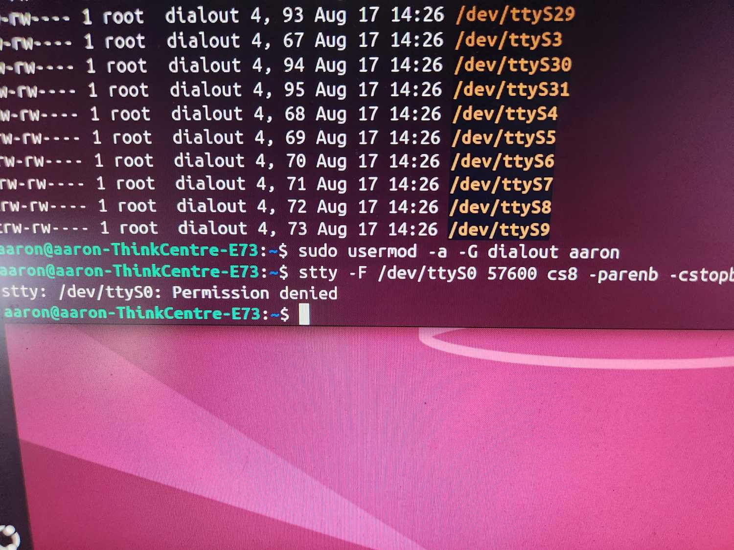

Good afternoon I have a question, It is both linuxCnc, and just Linux.
First I have been running LinuxCnc from a Startup Boot thumbdrive. I had a friend help with the original Linux install, and LinuxCnc install on this computer Lenovo intel g73.
At some point I think i would like to get rid of the thumbdrive boot , and have this computer just run linuxCnc , or if possible Linux Debian 12, and LinuxCnc . But for now i am pretty happy with the LinuxCnc on the thumbdrive and i have Linux Debian 12 without the thumbdrive.
I am still learning both Linux and LinuxCnc for sure.
I have a very old robot arm that i can run on a windows terminal . I ASSUME i should be able to run the arm from a Linux terminal????
BUT
I can not seem to change the serial port parameters in either Linux, or LinuxCnc.
I have tried several times to change the serial port parameter with various different terminal commands?
I have tried
" stty -F /dev/ttyS0 57600 cs8 -parenb -cstopb " i have also tried to add " sudo" in front of the line.
i always get permission denied.
I believe i have root access, but maybe not. i have tried to change my user status to a " ALL " and some other things, but no luck
I am not sure if this is a problem with my install, or if i need a more potent permission .
I thought i was the only user on this install and i thought i have " ALL access" but apparently I don't..
Shouldn't i have the same access in linux and LinuxCnc
i did mange a command that listed all my permissions and i am pretty sure i have at least admin level
how can i get permanent root access
thanks

17 Aug 2025 20:58 #333579
Replied by tommylight on topic getting started , latency and breakout board questions
ls -l /dev/tty*
then
sudo usermod -a -G dialout <username>
replace "username" with your actual username on that pc
then

17 Aug 2025 21:38 - 17 Aug 2025 21:48 #333580
by Chock
Replied by Chock on topic getting started , latency and breakout board questions
Good afternoon Tommylight thanks, I tried something pretty similar to this with out the < > .
That was several tries back
i just tried it and i added the < > with my username in the middle of the<> and i got a
bash: syntax error near unexpected token 'newline'
next i tried without the < > and i got asked for my password, that is good correct?
i made a typo next, trying the stty -F /dev/ttyS0
and on the 2nd try with the stty i got permission denied again.
if i make a typo do i lose my root access? and need to start over with dialout line ?
i tried the whole process starting with the " ls " again, no typos and still permission denied
Since the command line has my name twice that means i am logged in correct? does that mean i am logged in a both user and admin?

17 Aug 2025 22:06 #333581
by unknown
Replied by unknown on topic getting started , latency and breakout board questions
Logout out then log back in, then you'll be good for your permissions and group membership.
