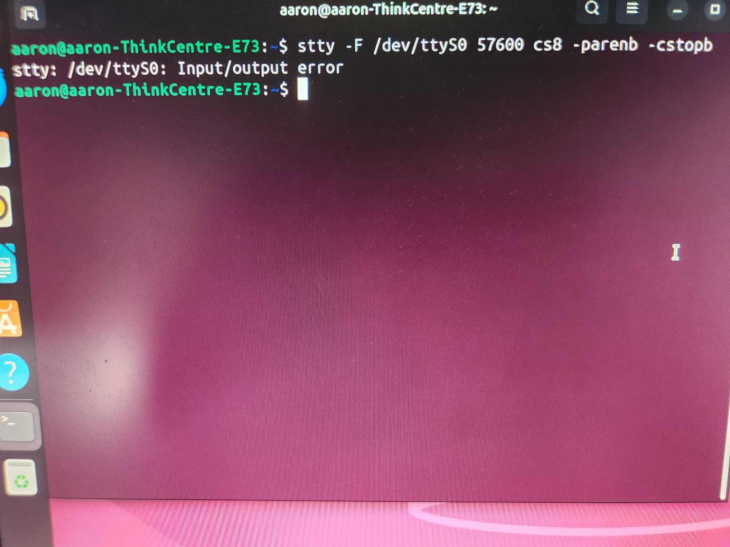

logout is just " exit " correct
and then the log in is automatic
i tried exit, and it shuts down the terminal window,
when i open the terminal window back up , i think i am logged in automatically
and i tried the stty line again , no luck.
i power cycled and still no luk
Does there have to be live activity on the serial port ??? for this to work?

what about something like this
" sudo apt-get install minicom # Install if not present
minicom -D /dev/ttyUSB0 -b 115200 # Connect to device at 115200 baud
but replace the usb0 with S0, and then fix the rest baud R, and parity, etc

i must be doing something pretty dumb, i tried this on the ancient Dell D620 dual booted with windows XP and Ubuntu14? from about years ago and i got the same problem. This is the known good computer to interact with the robot arm , but in windows XP with putty or the robot native software that i think was windows 95. This native software is not perfect and won't compile a program, but it will run the arm from the terminal
So maybe it is not my current version of ubuntu12.
Please don't ask how i got the ubuntu 14.

Ok this has got way off topic and is starting to get into topics far away from Linuxcnc.
For a detailed how-to on the use of the serial port please read this document.
tldp.org/HOWTO/Serial-HOWTO.html
This should cover everything regarding the serial port, the tldp site has a lot of docs regarding basic Linux usage.
Oh and please stop inserting random question marks, it's makes it hard to work out what you are on about.
