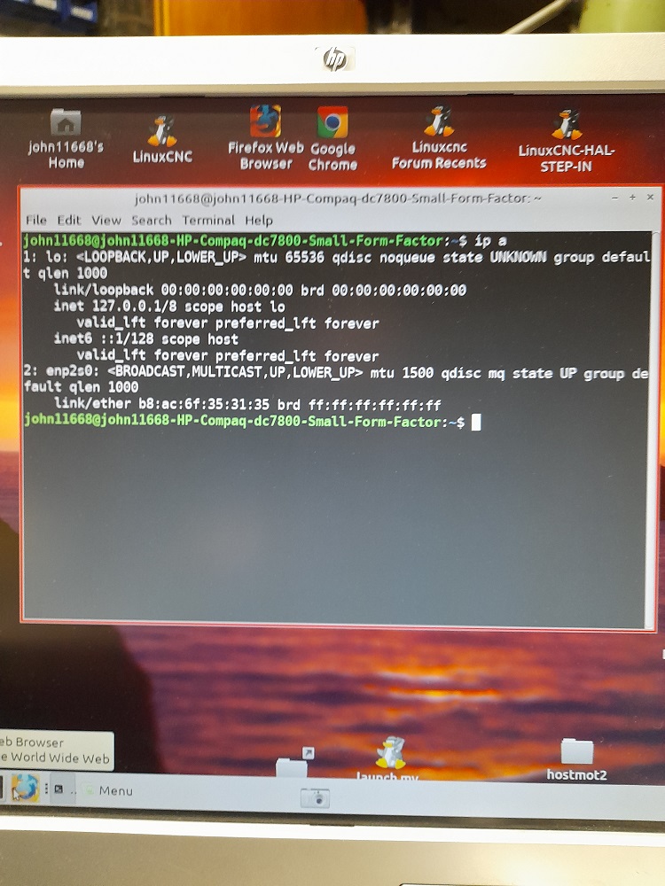

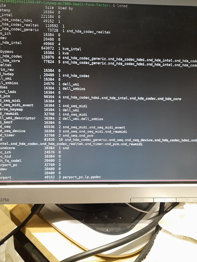

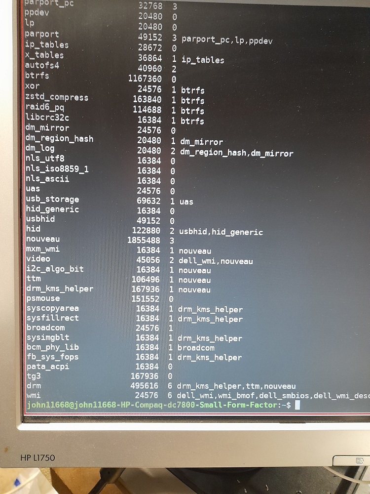

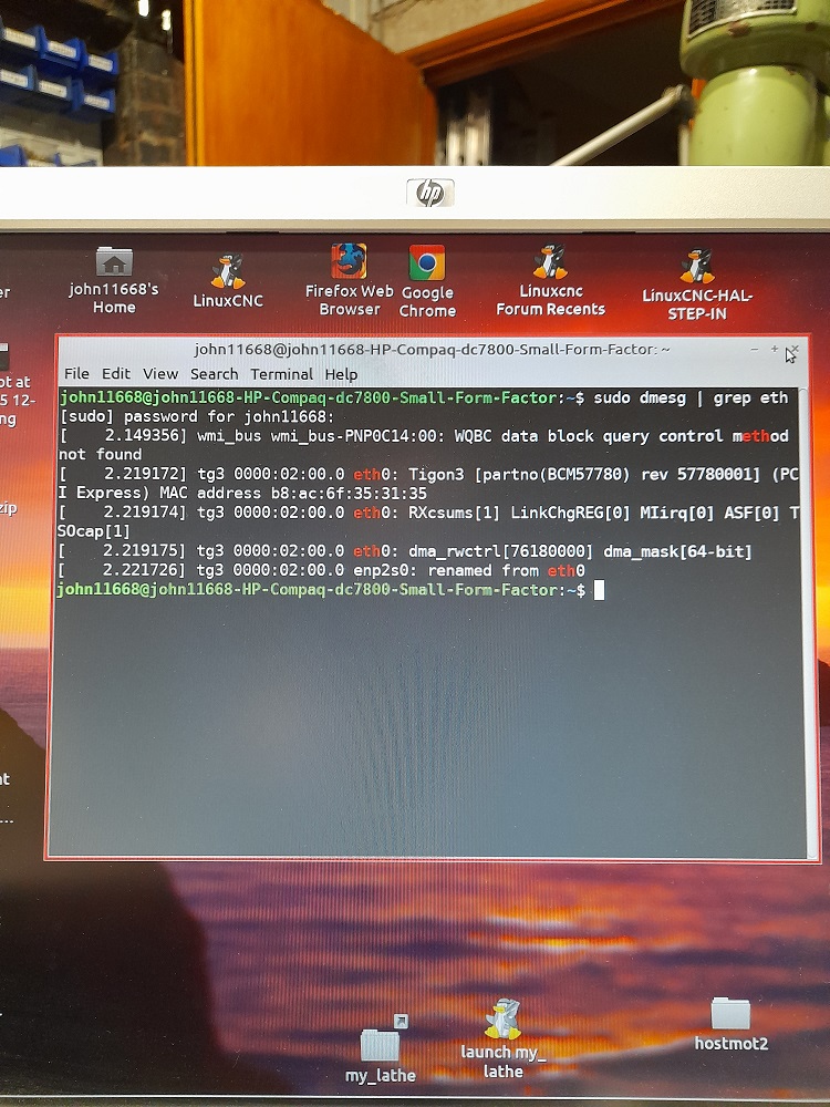

by john11668
Replied by john11668 on topic New install of Mesa 7i92 on TCL lathe
So info as requested
Home router IP 192,168.1.254
Mesa IP (default) 192.168.1.121
IP address of linux PC set to 192.168.1.2 as suggested
Pics as follows :-
and last one in two installments
Does this then allow us to proceed please
I am sorry that "paint" has turned these around . They were right way up when I saved

Ok John. I used to use another username.
Now back to the task at hand.
Your home network and the mesa network must be different. So you will have to change the address of the mesa card via jumpers.
So after doing that you will have the following.
Home Network 192.168.1.xxx
Mesa Network 10.10.10.xxx
Unfortunately your USB to LAN adapter is a weird beast. Hence I requested the full output of lsusb for that device, which has been omitted. The story with that particular device is that it first identifies as a USB Storage device and requires a command to get it working as as USB to LAN adapter. The below link provides a discussion which may seem confusing but hopefully proves I'm not a little too tipsy or at all.
www.draisberghof.de/usb_modeswitch/bb/viewtopic.php?t=2972
I think the more pragmatic way forward would be to purchase, if funds allow, one of the ethernet cards I suggested. That is if you have pci slot and require a low profile card. Then the setup becomes easier. Debain, depending on the drivers & firmware included, can be a little difficult in setting up wifi.
Whilst it may seem all is lost in a see of troubles that is not the case. Unfortunately whilst a Linux PC is a tool some knowledge is required in the operation.
, more than you would like to gather.

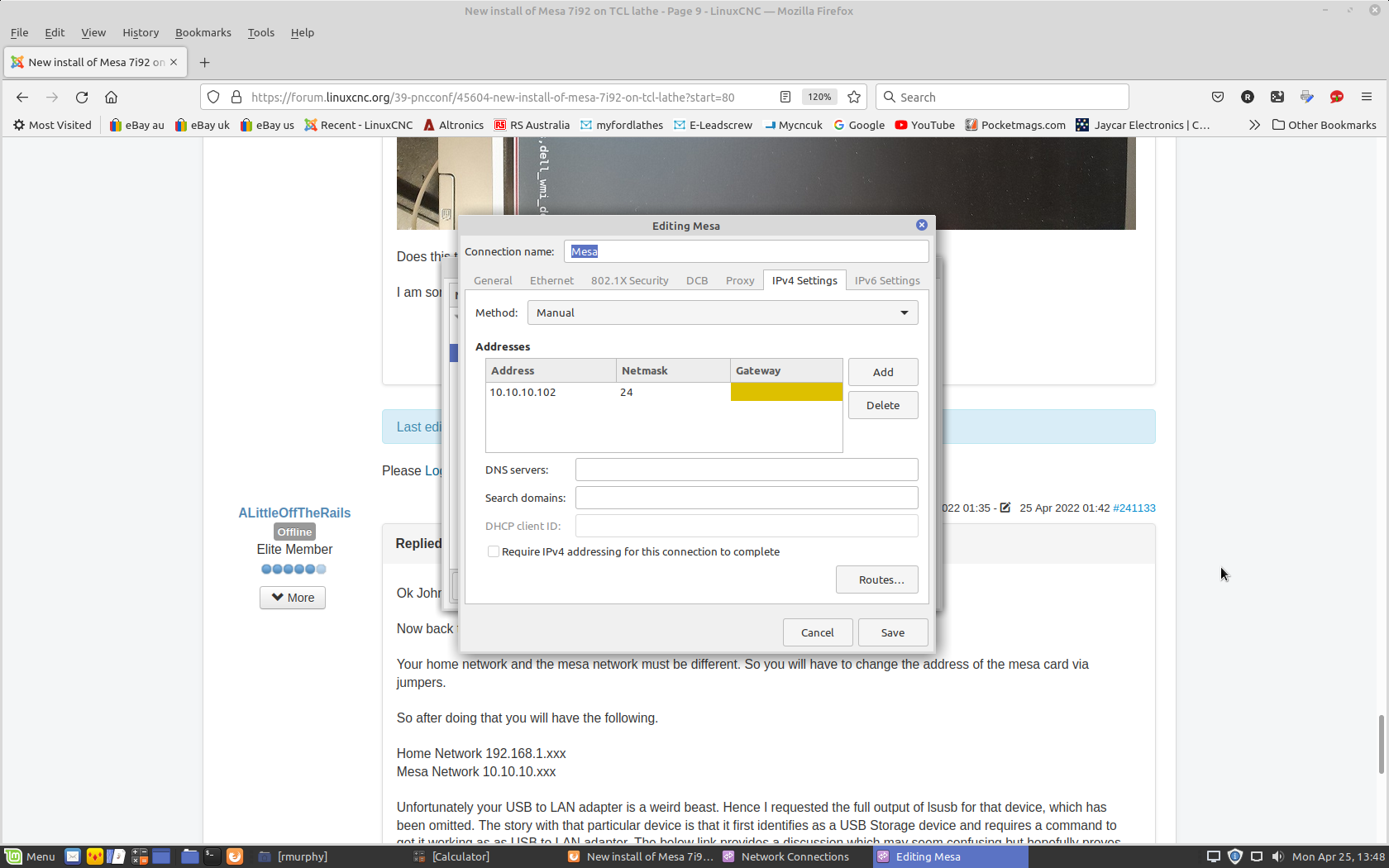

Setting up a connection for your Mesa card on the 10.10.10.xxx network.
Under the "Ethernet" tab all that is required is the device (card/interface) you wish to configure. I will leave that up to you. If you need information on how to select that device I can give advice. The important identifier is the so called MAC, this is an identifier unique to every network interface. That always amazes me consider the amount that have been produced and will be produced. This is a simple explanation.
Under the "IPv4" tab the below screenshot shows the information required.
Note:Method is manual
Only the IP address fields and Netmask is required. This maybe entered as "24" or the more traditional 10.10.10.0.
There is no need for a gateway as your only have one other the device on this network, your Mesa card. Simple explanation.
There is no need for DNS servers or search domain entries.
Note that the "Connection Name" is editable to something that makes sense to you, I choose Mesa as this is the details to connect to your Mesa card.
