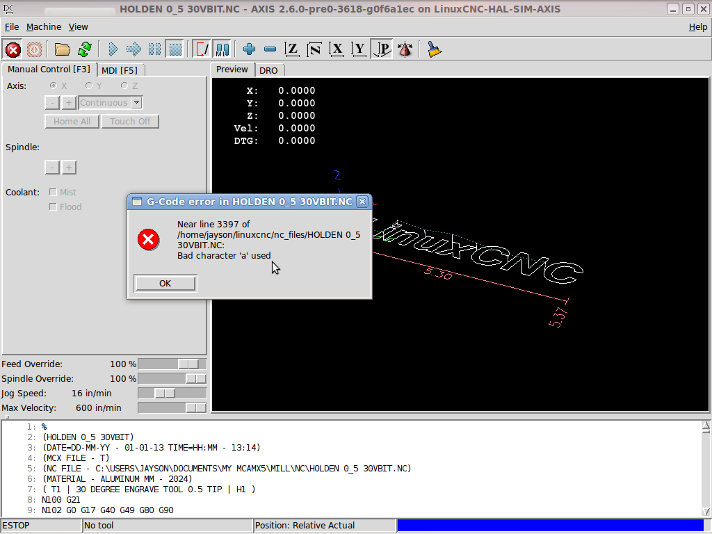

I have been using Gscreen all week and its working well.

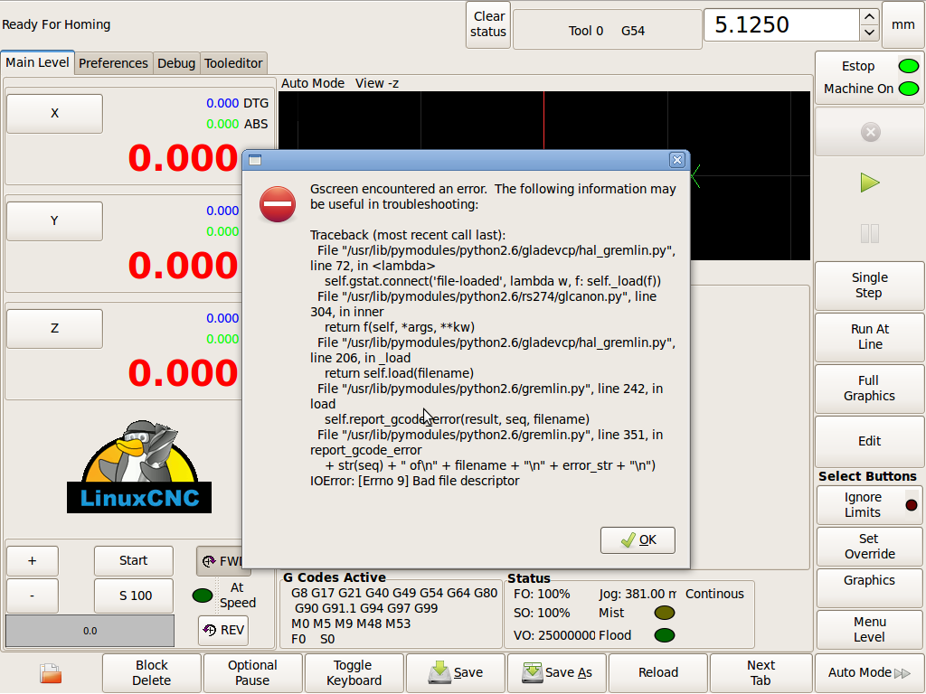

One small thing that I have noted is that if there is an error in the .nc file Gscreen throws up a bunch of python errors.
If I load the same file into axis it gives me the line number and points to what the error is.
Just makes it a little easier to find where I stuffed up

Ironically the error is from the code that is suppose to report the Gcode error.
This is a problem in the HAL_gremlin widget. Was hoping Pavel would fix it (he made HAL_gremlin)
I might look into it though...

Well while that would fix the error code being thrown that would create a lot of work for me and then restrict users from customising Gscreen's graphics plot, which is one of Gscreen's objectives.
Also fixing the HAL_gremlin error seems a better thing for a developer to do then just stop using the widget.
I can suppress the error messages easily by overriding the method that prints them to standard error and changing it to a print statement.
This shows me that the error message is being written twice, which seems to indicate the loading of the program is being done twice.
Not sure why that causes an error rather then just printing twice though...
I'm sure someone who knew how to use a debugger could figure out why it's being called twice - I just don't know how to use a debugger.
I did a few print statement debugging and haven't found it yet - I wouldn't be surprised if it's a glade signal being called twice.
