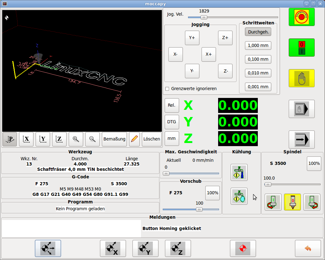

Hello Chris,
I am new with gscreen. I just pulled the newest version and tried it out.
First of all, I would say thanks for your work, but...
I am using it "run on place" on an Athlon 2000 (1300 MHz) with 1 GB Ram and SIS grafiks Card, so this isn't a new machine, but with gscreen it is getting an old lady, while it is running quiet well with axis. So I asume, that using an modern Computer will help. What specifications do you recommend?
When I start gscreen, an switch the machine on, all windows, or should I say elements makes a jump to the right.
The way to use it with custom gui is not easy to understand, I had to test a litttle arount to get used to it.
But I cound't find out how to come back to the main screen, after switching to the preference panel while there was running spiral.ngc.
I was working on an own screen, with is located also on mah's page, it is called moccapy, and based on the design of the german mocca surface.
I hope you don't mind, if I try to switch the design to an custom gui for gscreen, because I thing that is less work than finnishing my project, even, because I am just new with python.
I will test a litle more an give more feedback, but first I have to find a little more powerfull PC.
regards from Norbert

you should see a menu button in the bottom right corner this should move you around the screens , gscreen was initialy targeted for touch screens .
I would say the initial jump of the graphics is probably because of your setup and slow machine , 2gb of memory will help along with probably a better graphics card .
would be helpful .

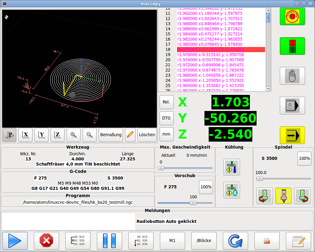

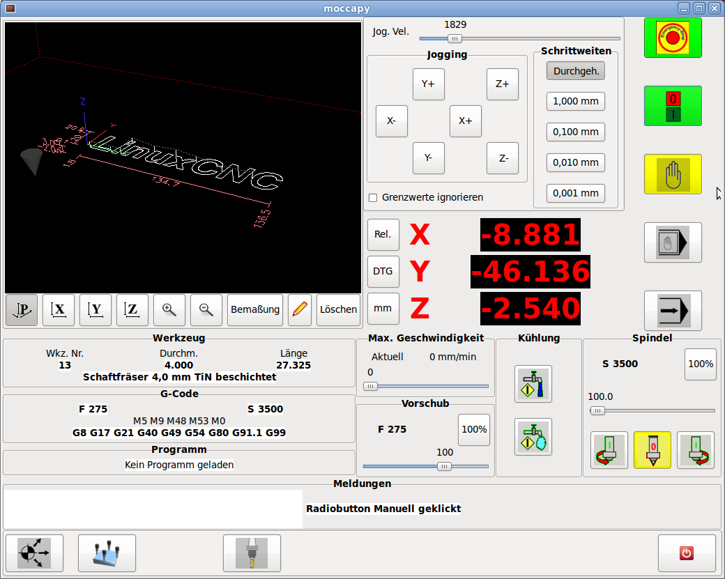

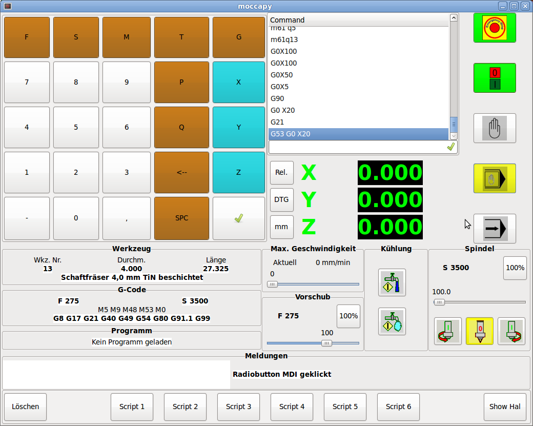

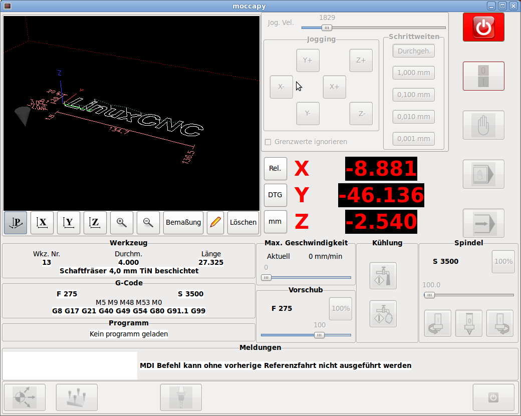

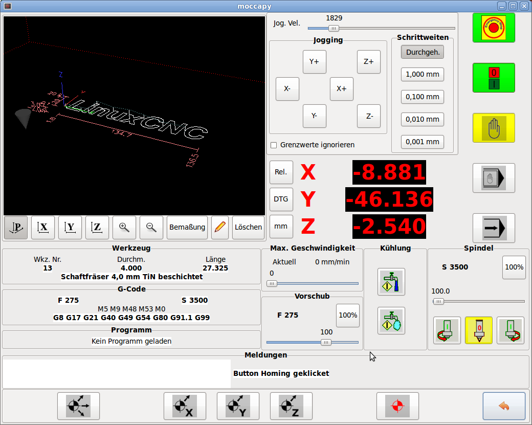

Here are some screenshots from my actual work
You can select the modes directly.
The button list on the bottom will change according to the mode.
In MDI mode you can select scripts
You will find a frame named Meldungen, where on the right you get the EMC reports and errors and on the left side it is a small debug window, with can be enlarged by double clicking it, then it fits the gremlin frame.
Most changes of the design are made by notebooks, chnging the page, so nothing is hopping around.
and some more stuff.
I like ICONS, but changing the button to text is easy.
So what are your opinions?
Regards Norbert

Cool screens, you should start a new topic to show them off.
