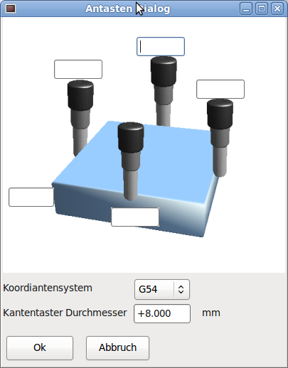

If you build an offset screen, have you thought about an touch off screen to?
Are you able to integrate an touch off dialog to calculate the angle error of the position of the workpiece?
I meen an angle error of the workpiece to the table axis.
I added the touch off dialog of original mocca.
Regards Norbert
P.S. Kantentaster Durchmesser = diameter of the touch off tool (will be taken in care when touching)

Hallo Chris,
will "Start of Line" check the code in front of the startline?
This will be needed!
Otherwise the machine may begin it's work without coolant and a stopped spindle.
Also the position may be incorrect, if the program contains G53 steps and some other stuff may occur.
We discussed that matter in the german mocca thread and mocca do check all lines from the beginning of the program, sets the G and M values and reaches then the strartline, now the G Code is transmitted to the interpreter, all other code is gone to a cero device. So all start parameters should be set up correctly.
Regards Norbert
