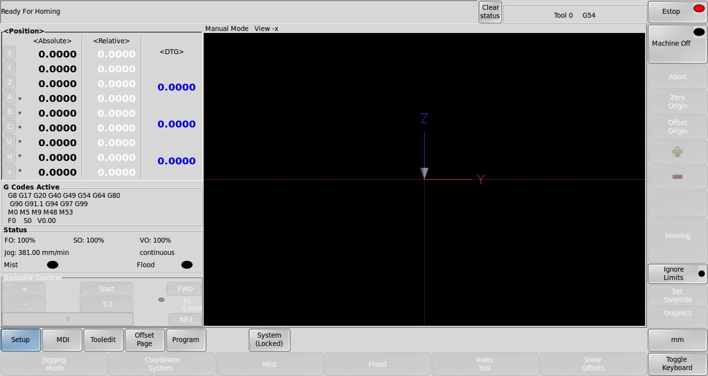

Replied by tjamscad on topic Gscreen - a GTK / Glade / Python based screen
Chris,
The homing indicators show before the machine is even turned on. Also the DTG text is not inline with the other axis's text.

And the order of the axis should be changed too.
It is now:
X Y Z A B C U W V
but should be IMHO:
X Y Z A B C U V W
Norbert
It is now:
X Y Z A B C U W V
but should be IMHO:
X Y Z A B C U V W
Norbert

Yes, you are correct here is the ini
AXES = 9
COORDINATES = X Y Z A B C U V W
HOME = 0 0 0 0 0 0 0 0 0
It is now:
X Y Z A B C U W V
but should be IMHO:
X Y Z A B C U V W
Norbert
AXES = 9

Replied by cmorley on topic Gscreen - a GTK / Glade / Python based screen
I'm still busy at work but those are easy fixes.
so ....pushed the fixes plus changing to metric mode changes all the axis and DTG
Chris M
Chris M

Were you able to fix the DTG being in all the wrong places with 9 axis shown?
Chris,
sorry missed that - pushed fix

The DTG indrustrial is shown all the time. The prefferences option to change it doesnt work.
fixed.
And I have pushed Norbert's new screen : Gmoccapy
I'll start a separate thread for it.
Chris M
