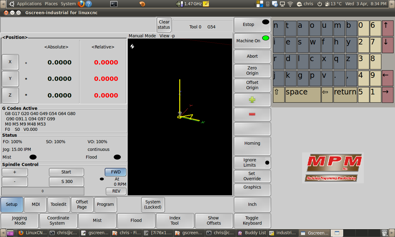

Yes some of those symbols are available by pressing a 'shift' key,
Onboard supports custom layouts so it comes down to someone writing one.
I was just happy figuring out how to embed Onboard in the first place - needed holp from the Onboard project to guide me.
Chris M
Chris M

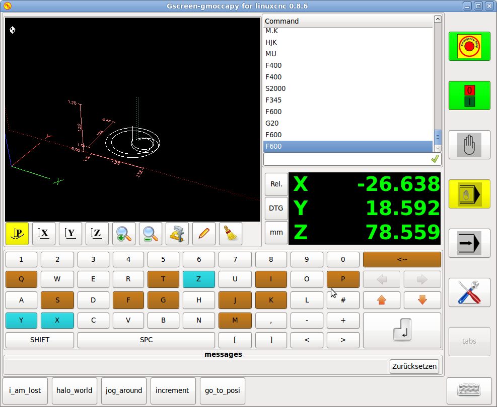

Hallo Chris,
feel free to get code of mine.
Norbert
Norbert

03 Apr 2013 17:56 #32205
by BigJohnT
Have you tried adding more rows and having less per row to get a squareish key?
John
Replied by BigJohnT on topic Gscreen - a GTK / Glade / Python based screen
Here is Industrial with an embedded 'Onboard' keyboard.
This is permanently at the side on the screen not a separate window.
This is just a test - but what ya think?
I think the keyboard layout needs to be optimized though...
Chris M
John

What I am doing is embedding Onboard (launchpad.net/onboard) into Gscreen.
opposed to launching Onboard separately.
I'm not interested in building a keyboard program as Norbert has done.
In this way a user could build what ever type of keyboard he likes and I don't have to maintain code.
I will play with the layout a bit.
Chris M

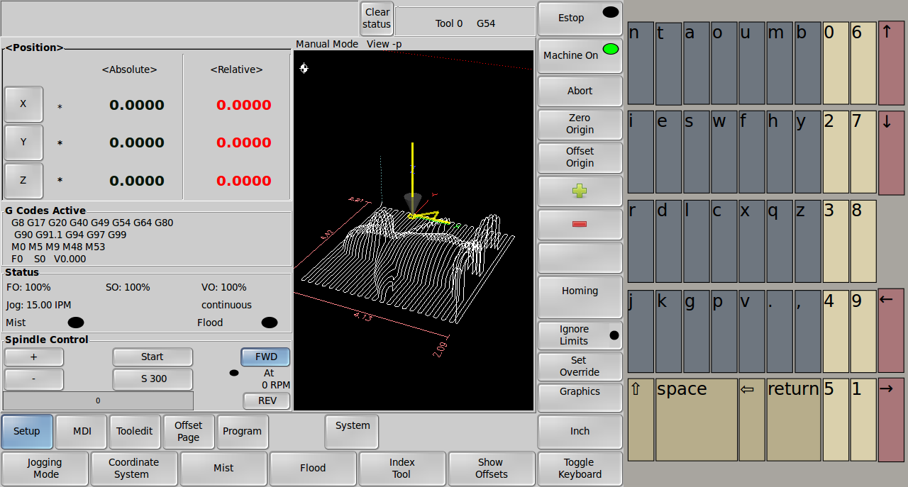

04 Apr 2013 12:00 #32260
Replied by cmorley on topic Gscreen - a GTK / Glade / Python based screen
I was fooling with keyboard bindings.
Is this something we should have for Gscreen?
What would we want a keyboard binding for - everything?
I would need to make it extendible in a handler file which is fine.
Maybe I should try to follow AXIS's bindings if I can.
Or maybe Gscreen is fine with touchscreen and mouse....
Chris M
Chris M
