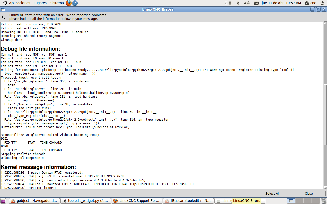

- jlviloria
- Posts: 161
- Thank you received: 9
10 Apr 2013 08:14 - 11 Apr 2013 18:00 #32514
by jlviloria
Replied by jlviloria on topic Gscreen - a GTK / Glade / Python based screen
Cmorley,
hello sorry you bother.
GScreen trying to get, I see you did the ToolEdit in glade. copy your files (tooledit.widget.py and tooledit.gtk.glade) in /sim/axis and try to embed on screen AXIS, but I get an error. I gave the path to my file. TBL.
But it has not been unsuccessful. is that I have no knowledge of programming, if I ask your help,
In advance thank you very much for your attention.
jorge
jorge
Last edit: 11 Apr 2013 18:00 by jlviloria.
- newbynobi
- Posts: 1931
- Thank you received: 394
11 Apr 2013 22:36 #32596
by newbynobi
Replied by newbynobi on topic Gscreen - a GTK / Glade / Python based screen
Hallo Jorge,
I think axis is tkinter and not glade, I am wondering if this will work together?
Norbert
Norbert
