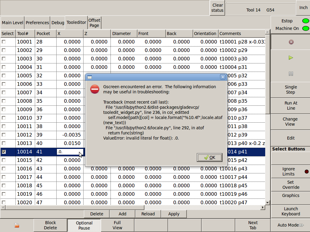

Hello Chris,
Have a few questions for you,
1. On tuesday, we were running our turning center, and the operator looked up, and realized that the screen had frozen up in the middle of a running program. He hit the feedhold button on the operator console of the machine and came and got me. I it stayed that way for all of the 5 minutes I was trying different things to get it to come back to life, nad nothing worked. I had to press and hold the PC power button to restart the pc. Since then it hasn't done again. I have the refresh rate at 100 in my INI. Any thoughts?
2. Last week the same operator came and got me saying that there was a fault on the display. I looked at it and saved a copy, just in case anything odd were to happen, which today it did. The operator was double checking one of his tools in the machine and went to re-touch off the tool to be sure and after he pressed the tool setting button, entered the value and pressed enter. Then he pressed the Tool Editor button on the top row of buttons and when the tool table came uponly 3 of his 14 tools had any values in them, the rest of his data for the other tools was all zeros. He told me after a short discussion with him that the following fault has came up 3 times in the last 4 weeks, and he has had tool data dissappear 1 other time during the same time period. I attached a screenshot of the fault to see if it may make sense to you, and if what I am experiencing is related.
It has been running fine other than these few things which have come to light in the last couple of days. The operator really like's the feel of the GUI, he's just been getting a little frustrated with me when it throws me a curve ball this.
Rick
Rick

Larry, greetings.
that error is because you are typing one wrong number
I have installed the GUI I industrial fanuc patch applied.
happened to me also the same problem, that the tool table data is deleted. I realize when I try to do a tool change and I get a message request tool does not exist. immediately is that the tool-table is deleted or blocked.
I think it's the patch, unfortunately it is very difficult to determine the error you have because I have no knowledge of programming.
chris hope can help us both.

1) I really don't know what would cause this. I'll have to ask one of the other developers about how to diagnosis this.
Thank goodness Linuxcnc uses realtime OS so even if the screen freezes the machine still runs properly.
2) I can get the error code eg type 1.2 3 in. - I can suppress this error so it doesn't pop up.
I do not lose any tool data. Is it possible the operator forgot to hit the apply button after editing the tool file?
This would be easy to do - pressing return updates the screen but does not update linuxcnc until the apply button is pressed.
maybe I should change that behaviour.
If this is not the problem then there must be a special combination that does it - which will be harder to find.
I have fixed the MDI entry problem - update to fix it.
Chris M

13 May 2013 13:07 #33974
Hmm according to the patch code - 10004 is the geometry and 4 is the wear offset. Is that normal in Fanuc programming?
When tool changing to tool 4 does the pop up say tool 10004?
Jorge could you explain exactly how you get the tool table to delete? is it repeatable?
Chris M
