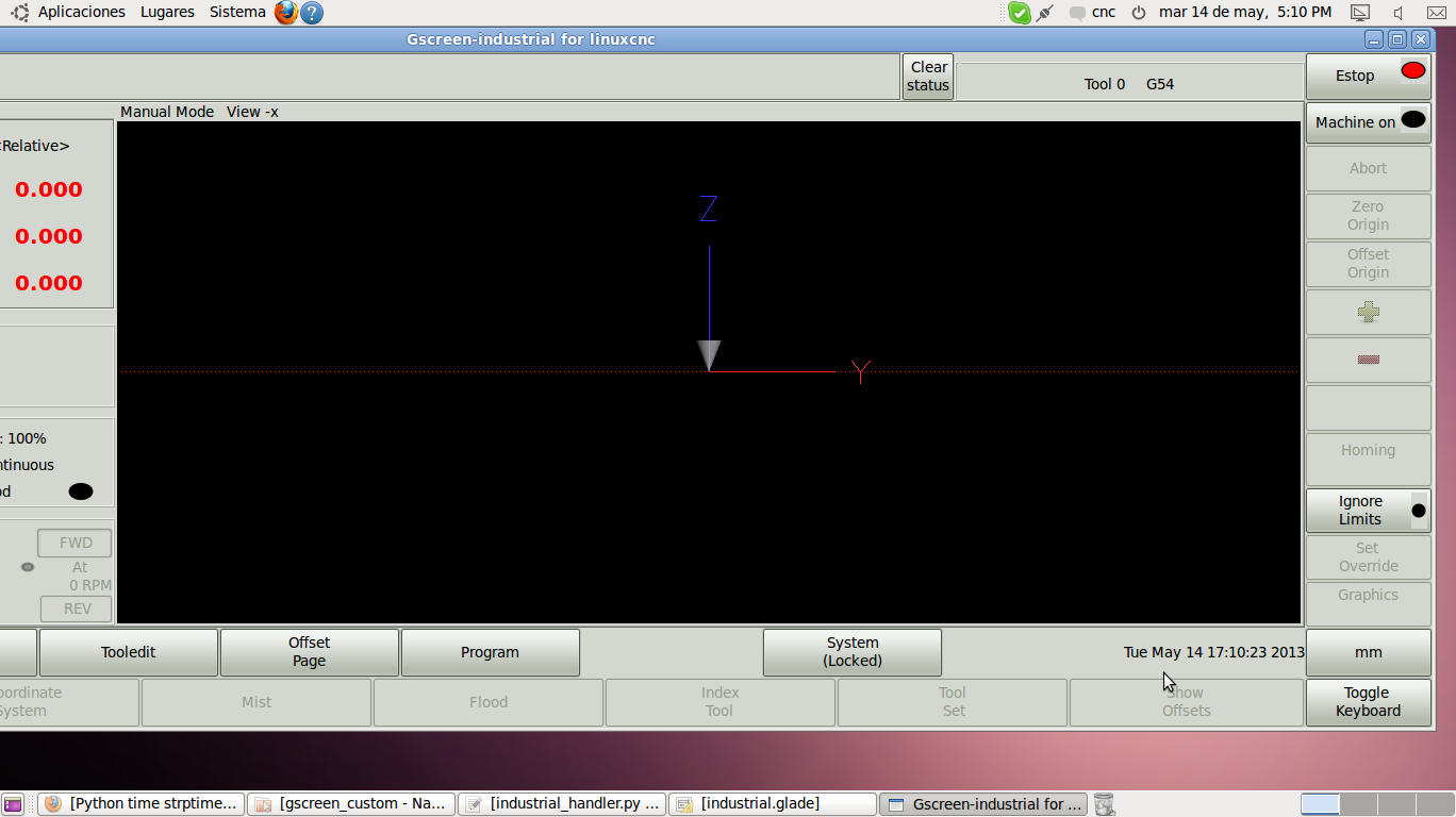

15 May 2013 08:05 - 15 May 2013 08:33 #34107
by jlviloria
Replied by jlviloria on topic Gscreen - a GTK / Glade / Python based screen
Chris, I have a question regarding library time.
I wanted to add date and time to my gui-industrial.
I have done the following:
industrial.glade:
label = data_local
industrial_handler.py:
import time
def update_data_local(self):
localtime = timeasctime (time.localtime (time.time ()))
self.widgets.data_local.set_text (localtime)
def periodic (self):
self_update_data_local ()
displays the date and time, but will not let me see the screen in fullscreen.
I appreciate any help, it may be something simple, but I think it is useful.
Jorge
industrial.glade:
label = data_local
import time
Jorge
Last edit: 15 May 2013 08:33 by jlviloria.
- Posts: 7368
- Thank you received: 2181
15 May 2013 08:36 #34108
Replied by cmorley on topic Gscreen - a GTK / Glade / Python based screen
Jorge
can you post the complete handler file?
I like the time idea too.
Chris M
Chris M

- Posts: 7368
15 May 2013 11:25 - 15 May 2013 11:27 #34113
Jorge:
It was the way you added the time label to Glade - forced the screen too wide, wich doesn't allow full screen.
try this glade file:
Last edit: 15 May 2013 11:27 by cmorley.
