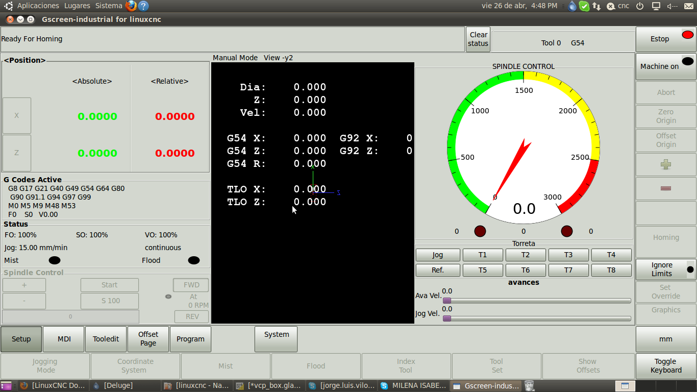

Chris, I want to change the font to a hal_dro (dro_x1, etc), as I can tell, I looked on the internet, which is by pango.FontDescription ("serif 20"), but I have tried several ways without success.
using "Industrial GScreen"
In advance thank you very much,
Jorge Viloria
Jorge Viloria
- Posts: 7368
- Thank you received: 2181
24 Apr 2013 08:50 #33111
Replied by cmorley on topic Gscreen - a GTK / Glade / Python based screen
find the file industrial_handler.py
at about line 290 change to this:
for i in self.data.axis_list:
self.widgets["dro_%s1"%i].show()
self.widgets["dro_%s1"%i].modify_font(pango.FontDescription("serif 10"))
self.widgets["dro_%s2"%i].show()
self.widgets["dro_%s2"%i].modify_font(pango.FontDescription("serif 10"))
self.widgets["dro_%s3"%i].show()
self.widgets["dro_%s3"%i].modify_font(pango.FontDescription("serif 10"))
self.widgets["axis_%s"%i].show()
self.widgets["home_%s"%i].show()

Chris,
I'm testing GScreen-industrial successfully on my lathe.
I have some doubts.
1) When starting I get the measurement in inches, but what I have in mm, in the "DRO" of gremlin out in mm, touch him twice click the button mm / inch units.
2) Do not I have all this physical buttons on my screen. is very hard for me to jog change going forward one by one. any help at this point would be very helped, I've thought about hal_scale in vcp_box, but I could not connect to LinuxCNC.
thanks in advance.
Jorge Viloria.
I have some doubts.
thanks in advance.
Jorge Viloria.
- Posts: 7368
27 Apr 2013 09:07 #33266
Glad you got it working.
If you wish to start in mm all the time, select the 'metric' button in the system / preference page.
adding a jog rate slider using HAL connections is probably not going to work satisfactory.
Doing it by using a custom handler file would integrate better.
a Jog slider is not going to be nice if you use a touch screen I think.
I am still working out of town so can not offer code examples yet.
Chris M

Jorge,
you can check the code of gmoccapy for the slider acting as jog velocity.
Norbert
