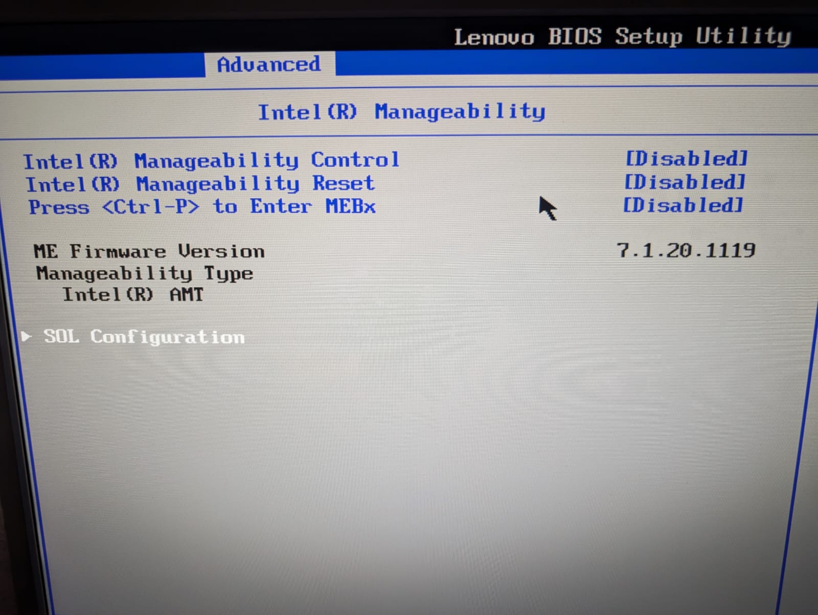

Replied by PCW on topic 7i96s Watchdog Ethernet
in the BIOS, at a minimum, Disable AMT
The following user(s) said Thank You: ErwinCNC
- ErwinCNC
- Posts: 39
- Thank you received: 7
12 Apr 2025 11:27 #326175
by ErwinCNC
Replied by ErwinCNC on topic 7i96s Watchdog Ethernet
- Posts: 18122
- Thank you received: 5337
12 Apr 2025 12:06 - 12 Apr 2025 12:26 #326178

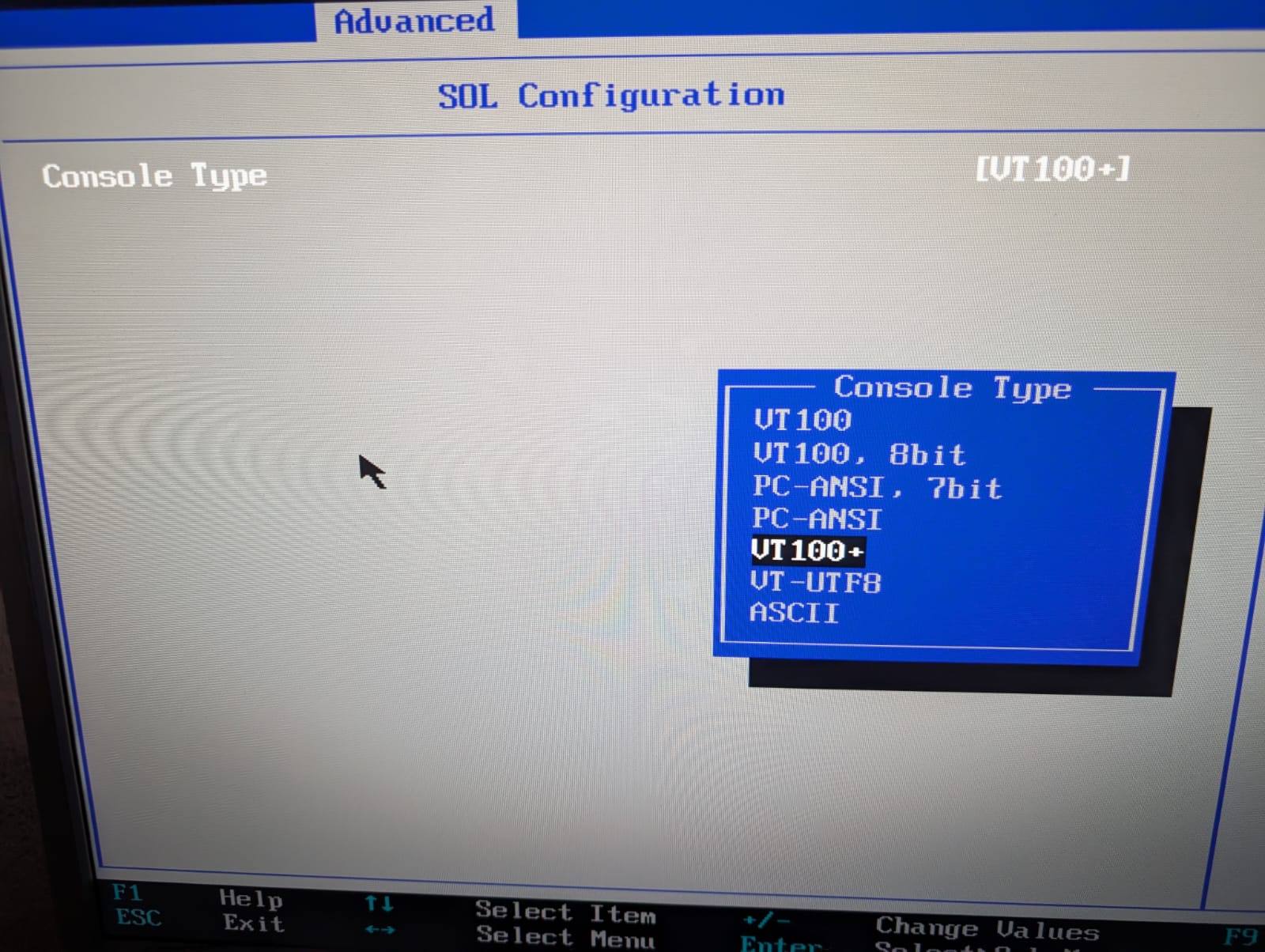

AMT is still enabled
I think you need to enter MEBx to disable AMT
I would do a web search in the steps needed for this
on your particular CPU.

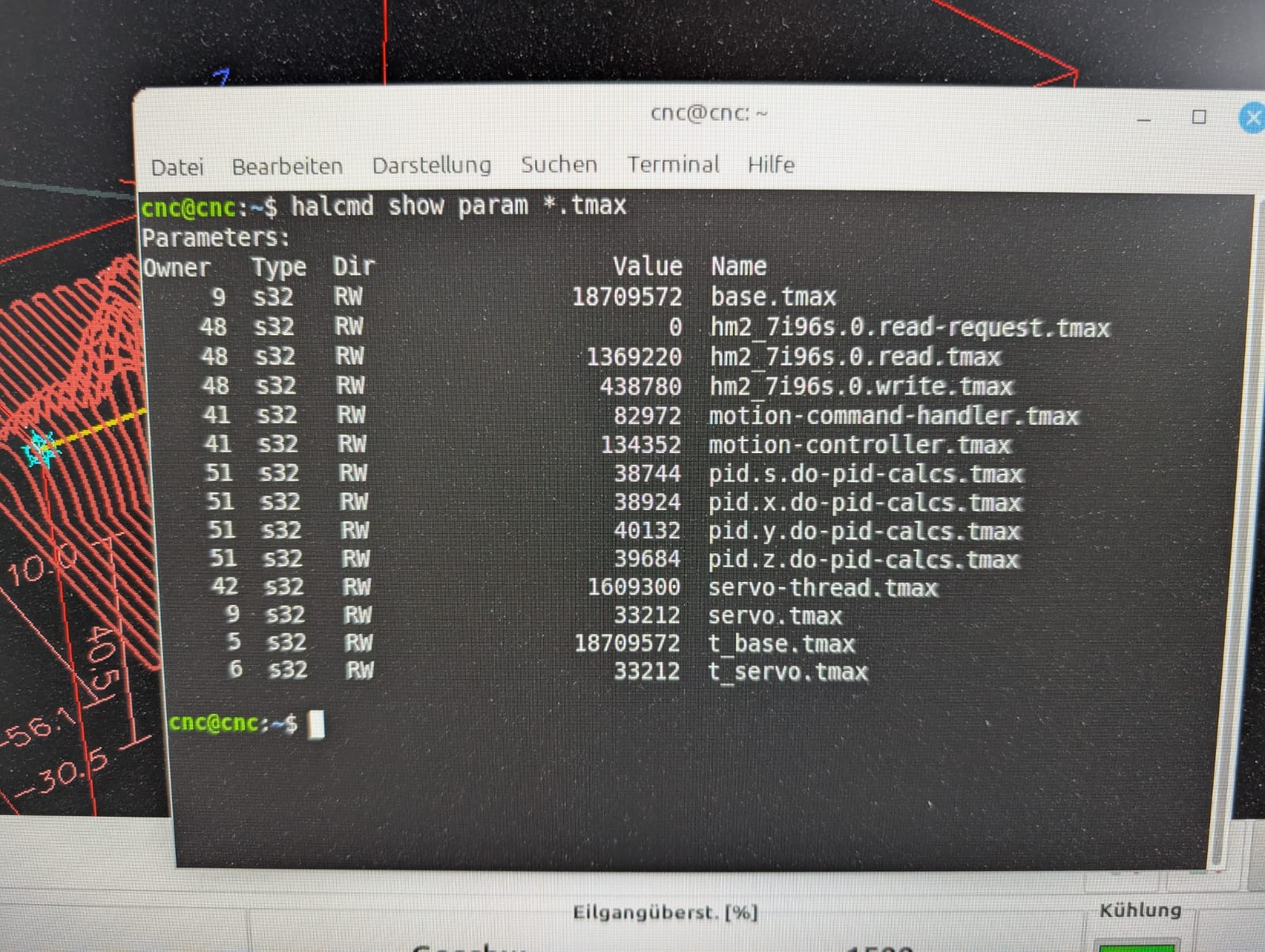

13 Apr 2025 11:58 #326224
Yeah, there are several odd .tmax entries, not sure what they are about,
this is what I get with a simple pncconf/gmoccapy configuration:
Parameters:
Owner Type Dir Value Name
38 s32 RW 0 hm2_7i96s.0.read-request.tmax
38 s32 RW 661312 hm2_7i96s.0.read.tmax
38 s32 RW 62668 hm2_7i96s.0.write.tmax
31 s32 RW 4296 motion-command-handler.tmax
31 s32 RW 43264 motion-controller.tmax
41 s32 RW 3464 pid.s.do-pid-calcs.tmax
41 s32 RW 3472 pid.x.do-pid-calcs.tmax
41 s32 RW 4984 pid.y.do-pid-calcs.tmax
41 s32 RW 2916 pid.z.do-pid-calcs.tmax
32 s32 RW 760744 servo-thread.tmax
Where the heck do "base.tmax" and "servo.tmax" come from?

18 Apr 2025 06:30 #326592
by ErwinCNC
Hallo PCW,
ich habe noch einige andere Einstellungen versucht aber ohne Erfolg.

18 Apr 2025 07:50 #326598
It's worth a try, but...
Did you actually disable AMT?
Still don't know where base.tmax" and "servo.tmax" come from.
These are suspicious as they do not exist in a standard LinuxCNC installation.
