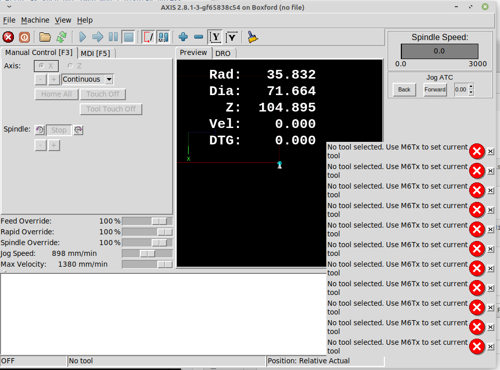

Replied by Aciera on topic How to make a tool changer move to home
Ok I found it. We can remove it in the toolchanger.comp and then you will need to recompile the component.
Change line 136 in the file toolchanger.comp from this:
to this.
and recompile the component. It should remove the warning.
bWarn = true; // just warn once, its not an error as such but INFO won't display unless debugging is set 3+to this.
bWarn = false; // just warn once, its not an error as such but INFO won't display unless debugging is set 3+and recompile the component. It should remove the warning.

18 Dec 2020 16:29 - 18 Dec 2020 16:34 #192343
by Clive S
Replied by Clive S on topic How to make a tool changer move to home
Last edit: 18 Dec 2020 16:34 by Clive S.

18 Dec 2020 16:33 #192344
is this after recompiling toolchanger.comp?

18 Dec 2020 16:35 - 18 Dec 2020 16:46 #192345
by Clive S
Yes but I will make sure and do it again
Edit; I have tried it again with the same results
This was the line that I changed to false
rtapi_print_msg(RTAPI_MSG_ERR, "No tool selected. Use M6Tx to set current tool");
break;
and compiled with terminal from config folder . sudo halcompile --install toolchanger.comp

18 Dec 2020 16:38 #192347
Maybe put the "bWarn = true" back in and just uncomment line 137:
Also make sure the file 714.ngc exists.
// rtapi_print_msg(RTAPI_MSG_ERR, "No tool selected. Use M6Tx to set current tool");and recompile the component.

18 Dec 2020 16:56 #192350
by Clive S
Perfect. You have a fantastic flare for the way you can help and give advice so clearly.
Star Man Thanks.
