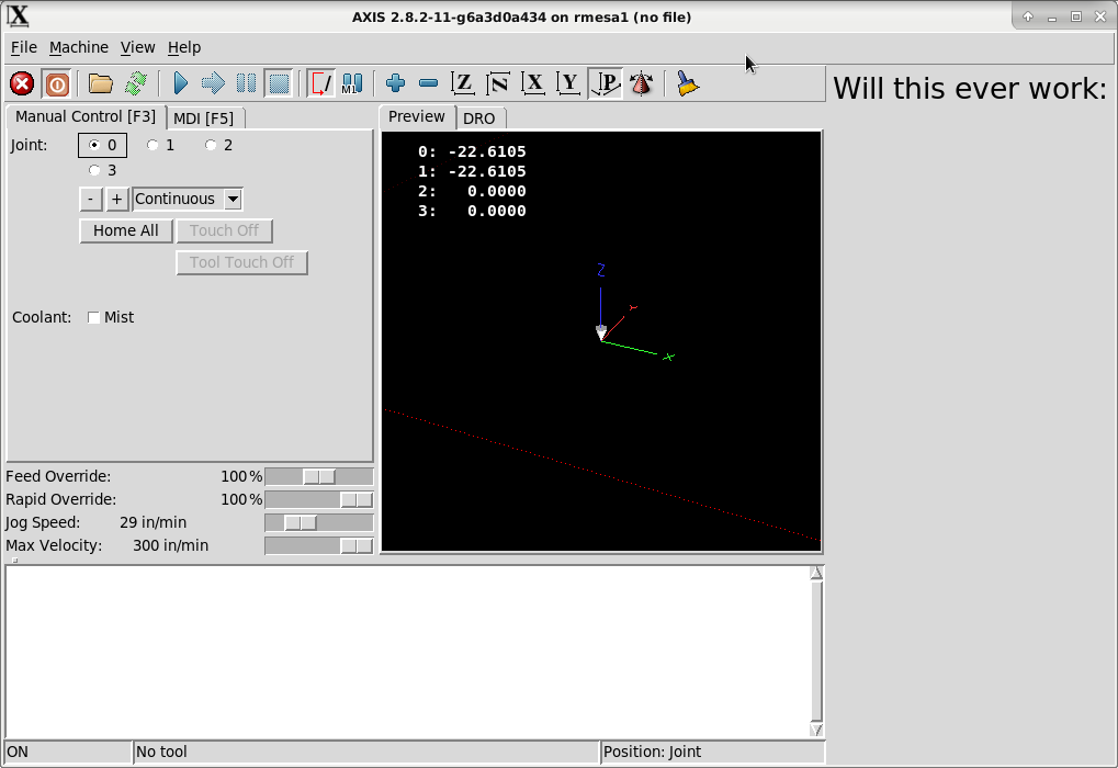

BigJohnT ... I tried to configure without the tool and the result were not good. Linuxcnc failed to run. I am back to re reading the manuals and I try again. I am hoping to most of today on and I will post as I go..

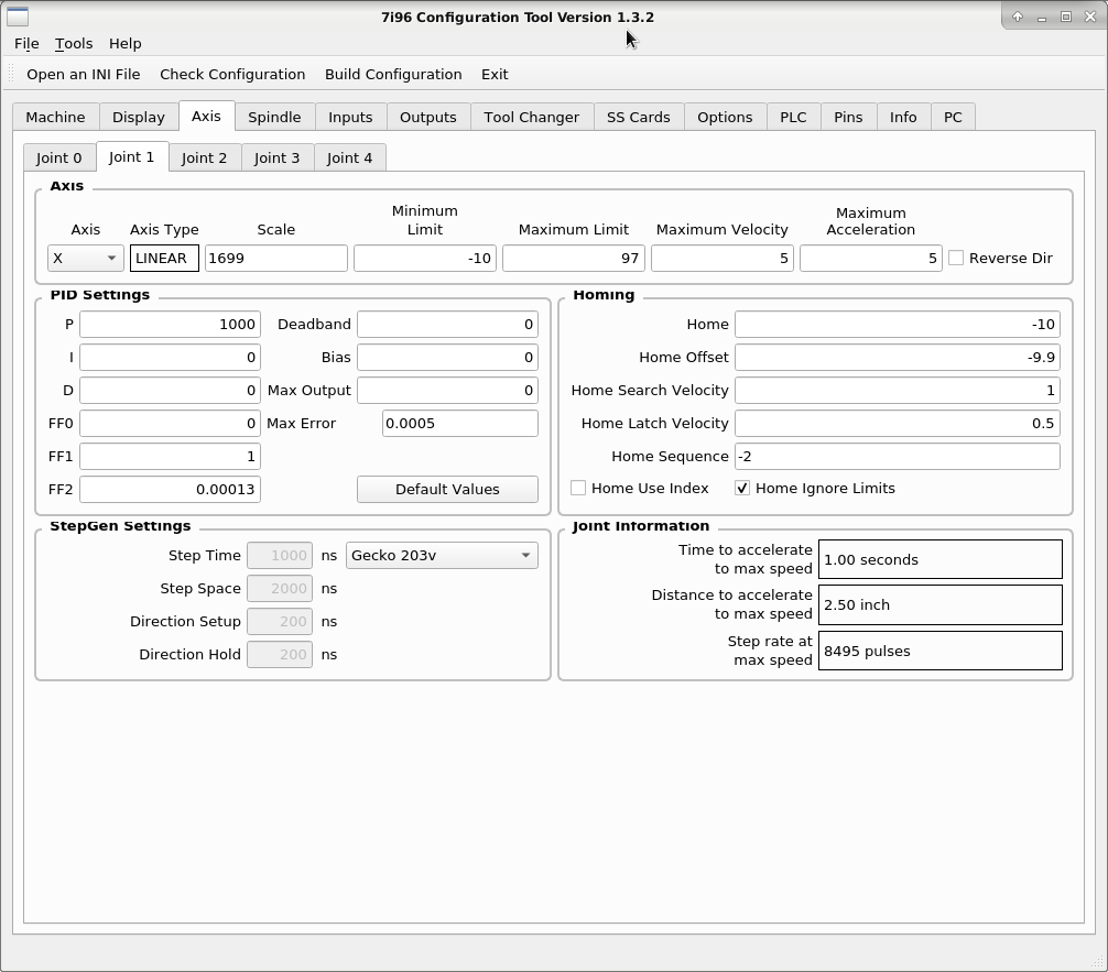

This the error i get if i do not make these changes
[AXIS_X]
MIN_LIMIT = -10
MAX_LIMIT = 97
MAX_VELOCITY = 5
MAX_ACCELERATION = 5
#[AXIS_X]
#MIN_LIMIT = -10
#MAX_LIMIT = 97
#MAX_VELOCITY = 5
#MAX_ACCELERATION = 5
[AXIS_Y]
MIN_LIMIT = -2
MAX_LIMIT = 52
MAX_VELOCITY = 5
[AXIS_X]
MIN_LIMIT = -10
MAX_LIMIT = 97
MAX_VELOCITY = 5
#[AXIS_X]
#MIN_LIMIT = -10
#MAX_LIMIT = 97
#MAX_VELOCITY = 5
[AXIS_Y]
MIN_LIMIT = -2
MAX_LIMIT = 52
MAX_VELOCITY = 5

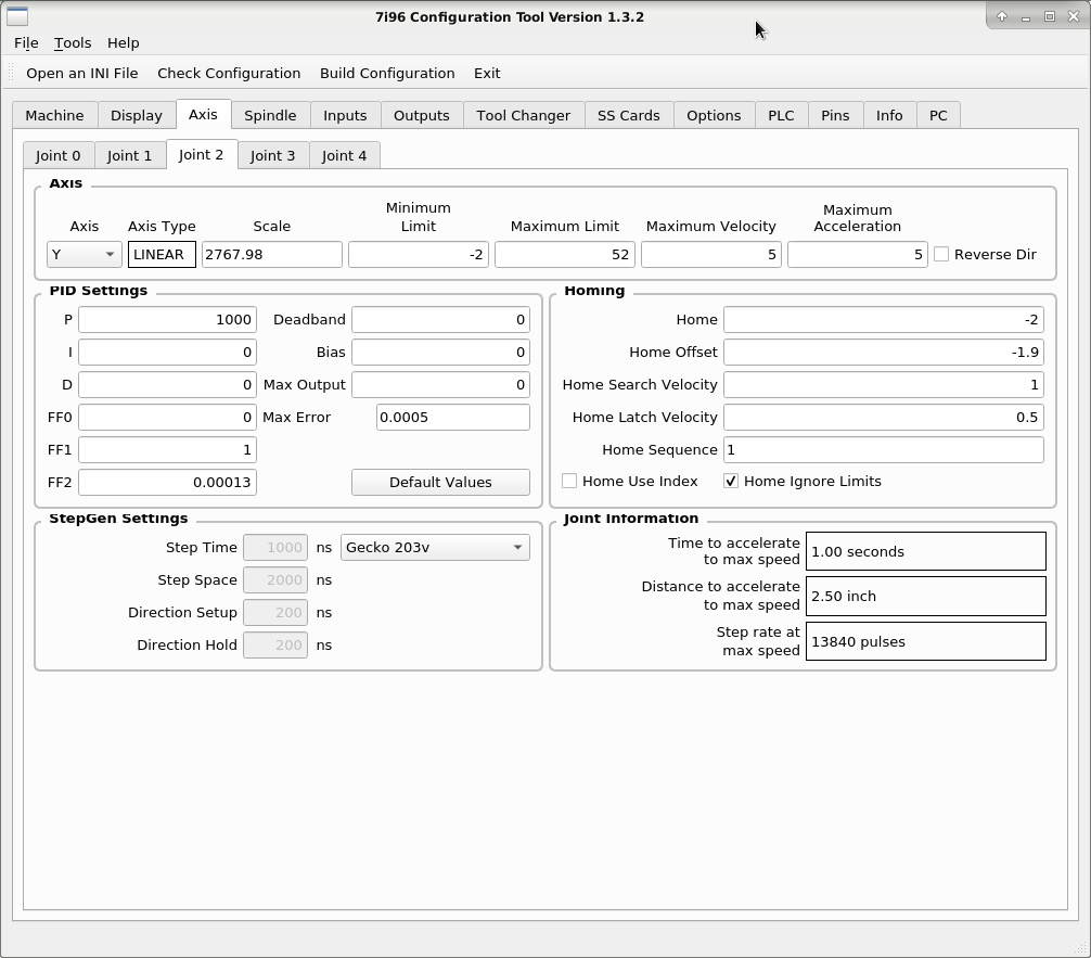

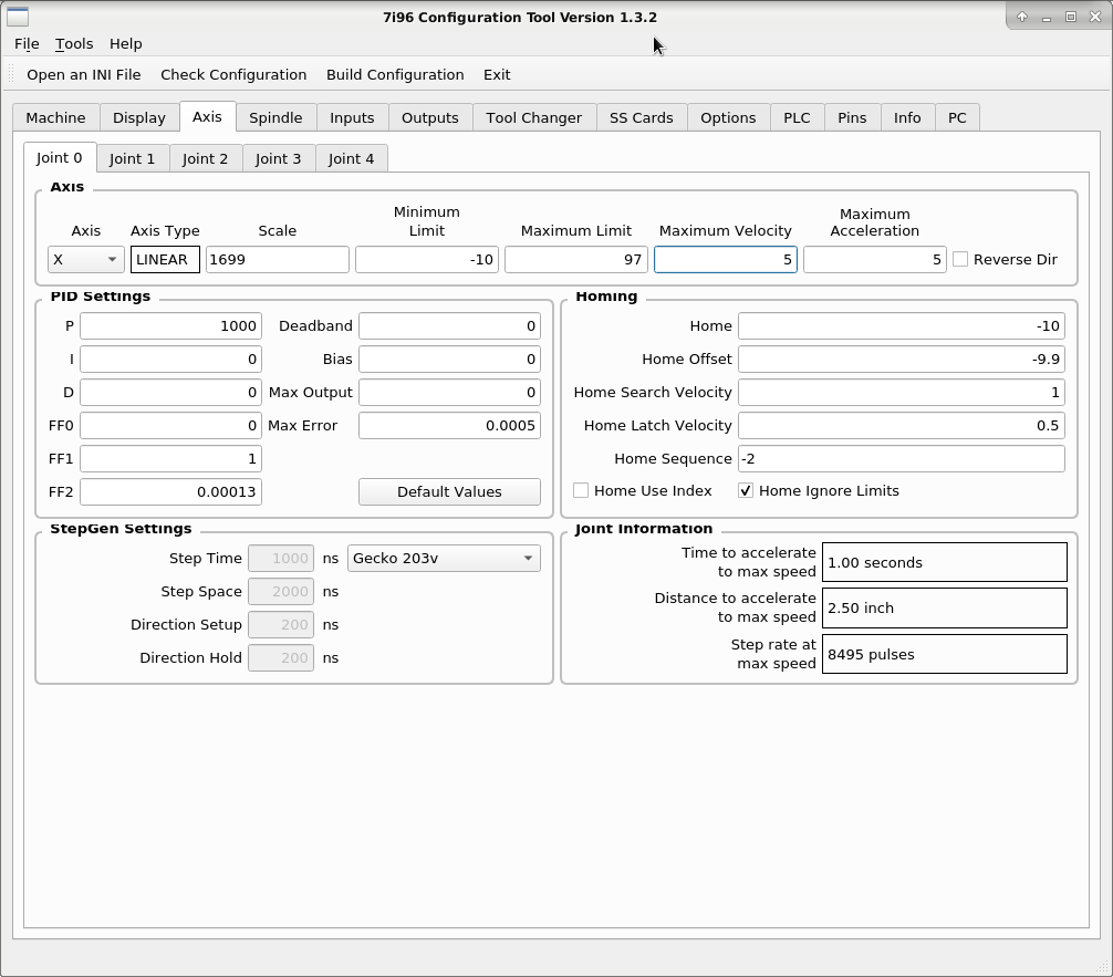

08 Jan 2022 23:06 #231191
by SSIRon
Replied by SSIRon on topic 7i96 configuration Tool and Gantry XYZ Machines
OK i have Joint 0 and joint 1 moving together. I had to add these lines to each joint.
OME_OFFSET = -2
HOME_SEARCH_VEL = -1
HOME_LATCH_VEL = -0.1
HOME_FINAL_VEL = 1
HOME_IGNOR_LIMITS = YES
HOME_SEQUENCE = 1
for some reason they did not get created with the tool. of course the value changes for each joint. I am not connected to the motors yet so i cant make it to the limits to home. and it will not let me jog till I home..
Can any one suggest how i can avoid that?
OME_OFFSET = -2
HOME_FINAL_VEL = 1
HOME_SEQUENCE = 1
- Clive S
- Posts: 2204
- Thank you received: 486
08 Jan 2022 23:13 #231194
by Clive S
I think it is a typo OME_OFFSET = -2
If this is a gantry you will need to change HOME_SEQUENCE = 1 to HOME_SEQUENCE = -1 on both joints
Can you post your ini and hal files

08 Jan 2022 23:18 #231197
by SSIRon
Clive s - no the type is in the post. here are my ini and hal files. Also do not understand why the display and animation are disconnected
