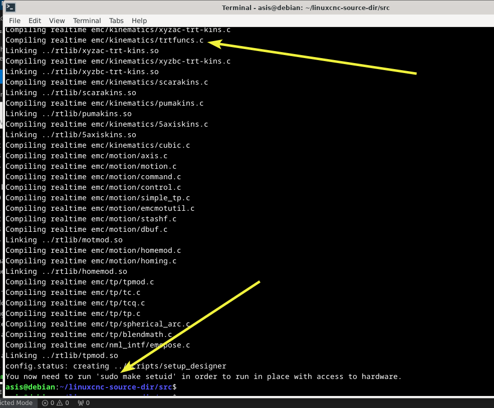

1. Note that the compiled installation is separate from the package installation you worked with before so you need to modify '~/linuxcnc-source-dir/src/emc/kinematics/trtfuncs.c'
2. then cd to ~/linuxcnc-source-dir/src and run
3. if that was successful you can start the compiled installation:
make3. if that was successful you can start the compiled installation:
cd ~/linuxcnc-source-dirsource scripts/rip-environmentlinuxcnc

Hi Aciera,
Now it's Work !!!
I miss source scripts/rip-environment

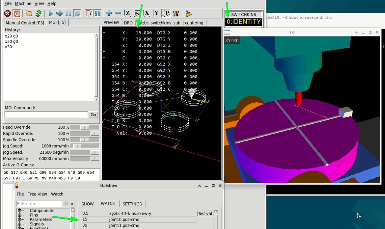

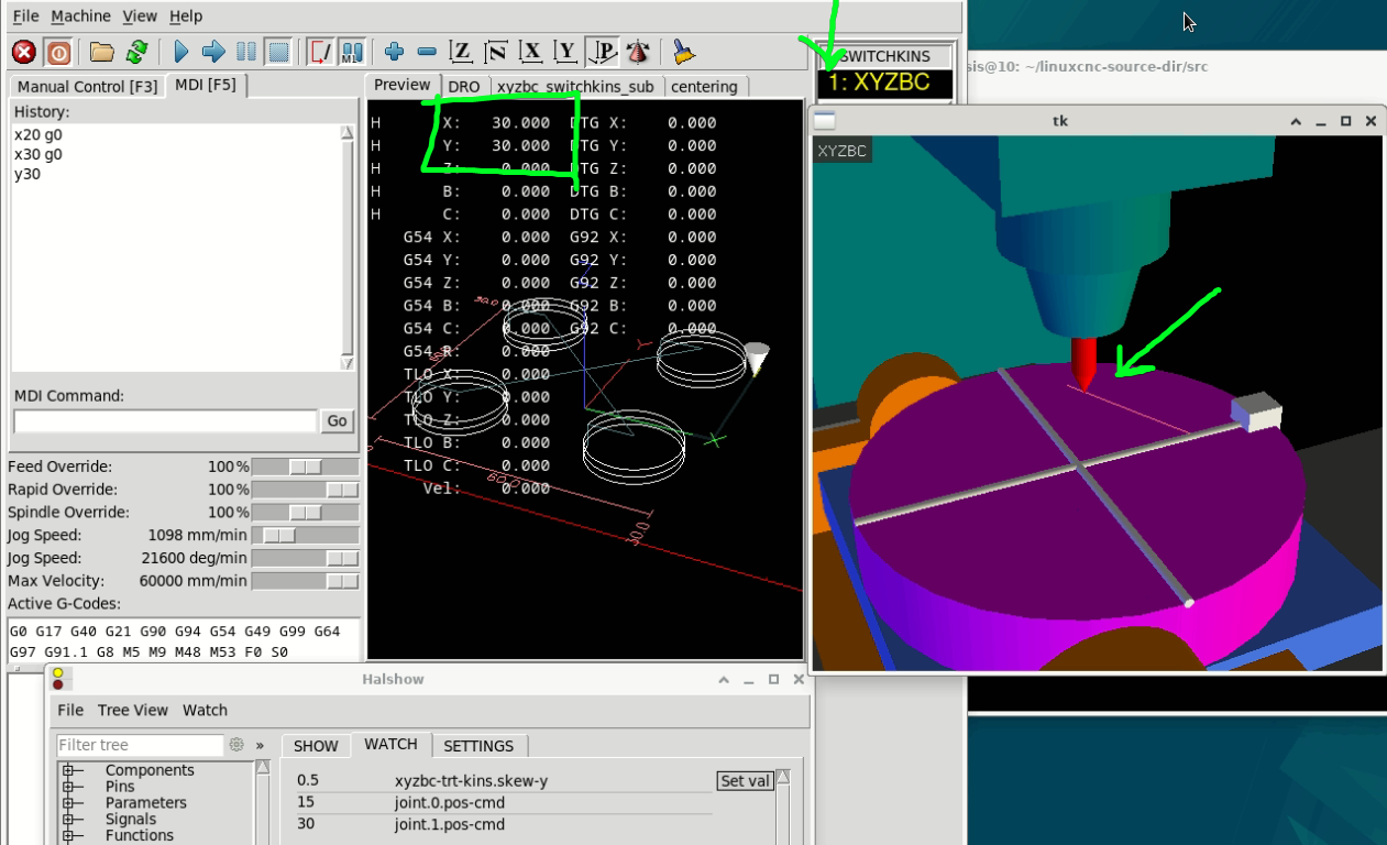

But....I think not correct output When in Mode : 0 Identify , because Identify not have skew
when change to mode to : 1 TCP , Y move and X skew correct
When I turn off TCP change to : 0 Identify Mode . X will change to Y/0.5 off skew
In picture Mode 1 TCP
X30
Y30
Then, I change mode from 1 (TCP) to 0 (Identify) X and Y will change to
X15
Y30
In real I think in DRO will X30 Y30 (I think you understand me)
can you help me for check code again ? ^^"

27 Dec 2024 10:30 #317458
Replied by Aciera on topic Skew correction/perpendicularity correction (millkins or millkins_xyz)
That is correct there is no skew correction in identity kinematics. Note though that my modifications are NOT what you need as the skew is in the work coordinate system (ie the correction rotates with the table) which is not correct, you want the skew correction to be applied to the machine coordinate system (ie it remains oriented to the machine joints regardless of table rotation).
To make a serious effort to get this working I would not bother with the built in trt kinematics but would use the more recently added userkins.comp template and build a new kinematic from scratch.
