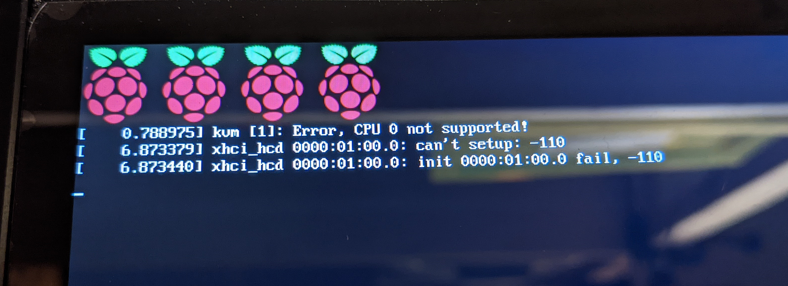

So, I found that the image for the raspberry pi on linuxcnc.org/downloads/ has an issue with no USB connectivity on the 8GB Pi 4 boards.
The image boot through to the desktop, but USB keyboard and mouse do not function. And because it is a loaded image there is no chance to set it up for wifi and remote connection to enable access.

So no issues with plain raspbian [2020-08-20-raspios-buster-armhf.img], just linuxcnc image [linuxcnc-2.8.0-pi4.img]
I also get the following errors with linuxcnc that do not come up with raspbian;
kvm [1]: Error, CPU 0 not supportd!
xhci_hcd 0000:01:00.0: can't setup: -110
xhci_hcd 0000:01:00.0: init 0000:01:00.0 fail, -110

Hi
I did a side by side comparison of a Pi4 with 4GB and 8GB. I modified the image in order to get ssh from the first boot. Both have a mouse connected and no screen.
The dmesg shows that on the 8GB the xHCI could not get activated (see line 142/142. Later this device is mentioned as the USB Host controller.
This problem appears only with the linuxcnc image.

Replied by idea on topic linuxcnc-2.8.0-pi4.img - no USB on raspberry pi 4 - 8GB & 2GB
I found the following at - wiki.debian.org/RaspberryPi4
- USB doesn't work up to kernel 5.7 for the hardware variant of PI4 with 8GB RAM
- This issue has a fix in kernel 5.8 (currently in experimental): lkml.org/lkml/2020/5/5/998
But I'm not clear if the build image here is running debian

My 8GB powers up all the way through to the desktop, just fails to start USB during boot (see errors logged above), so no keyboard / mouse.
