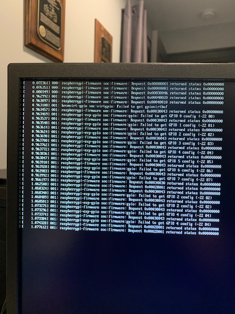

Hey everyone I finally have my machine built but I can't get LinuxCNC to run.
I thought I would try down loading a fresh image so followed this link Linuxcnc_2.8.1_5.10.25-rt35.img but it took me to lcnc_2.8.1_rt64.img file. I gave it a try seem so go good until I shut down and try to reboot then this happens. see image attached.
Any ideas on how to fix it or dose anyone have a good rpi4 image? I am using Mesa 7i96 and I just can't seem to get it to work.
I have re imaged it 3 time this happens every time after everything is installed and updated
