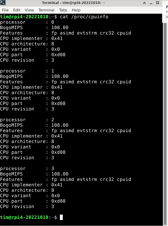

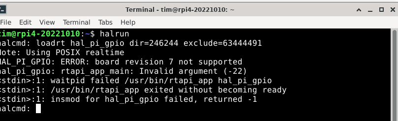

03 Nov 2022 01:55 #255814
by tjmarch
Replied by tjmarch on topic LinuxCNC on Raspberry Pi 4
Saw this so thought I would give bookworm a try everything went well until I ran my config setup. When starting Linuxcnc I received the error screen. Attached is error log file. Which contains the following error. HAL_PI_GPIO: ERROR: board revision 7 not supported. I have a RPI4 4GB.

Debug file information:
Note: Using POSIX realtime
hal_pi_gpio: rtapi_app_main: Invalid argument (-22)
./standard_pinout.hal:8: waitpid failed /usr/bin/rtapi_app hal_pi_gpio
./standard_pinout.hal:8: /usr/bin/rtapi_app exited without becoming ready
./standard_pinout.hal:8: insmod for hal_pi_gpio failed, returned -1

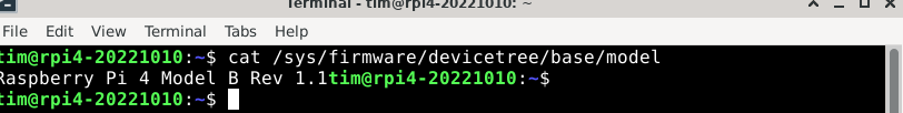

- elovalvo
- Posts: 205
- Thank you received: 127
03 Nov 2022 08:22 - 03 Nov 2022 10:29 #255823
by elovalvo
The problem is due to the cpu_info.c file
github.com/LinuxCNC/linuxcnc/blob/master...al/drivers/cpuinfo.c
which refers to what is reported in this document:
www.raspberrypi.com/documentation/comput...ry-pi-revision-codes
To check what your Raspberry board revision is, see the result of the 'pinout' or 'cat /proc/cpuinfo' command executed in the terminal.
If the revision is present among those reported in the cpuinfo.c file, the version of linuxcnc used is not updated.
If it is not present, the file will need to be updated.
Let me know

03 Nov 2022 14:35 #255846
by tjmarch
Checked, cat /proc/cpuinfo
with the following output. Thank you for the help elovalvo, what next, looks like revision 3 which is there.
tim@rpi4-20221010:~$ cat /proc/cpuinfo
processor : 0
BogoMIPS : 108.00
Features : fp asimd evtstrm crc32 cpuid

- elovalvo
- Posts: 205
03 Nov 2022 15:57 #255850
by elovalvo
You forgot to report the last 4 lines that report revision information like this
processor : 3
BogoMIPS : 108.00
CPU implementer : 0x41
CPU architecture: 8
CPU variant : 0x0
CPU part : 0xd08
CPU revision : 3
Hardware : BCM2835
Revision : c03131
Serial : 1000000079326ffc
Model : Raspberry Pi 400 Rev 1.1
Replied by elovalvo on topic LinuxCNC on Raspberry Pi 4
processor : 3
BogoMIPS : 108.00
CPU architecture: 8
CPU variant : 0x0
CPU part : 0xd08
CPU revision : 3
Hardware : BCM2835
Revision : c03131

03 Nov 2022 16:29 - 03 Nov 2022 16:34 #255851
by tjmarch
Last edit: 03 Nov 2022 16:34 by tjmarch.

03 Nov 2022 17:23 #255858
by tjmarch
- tjmarch
