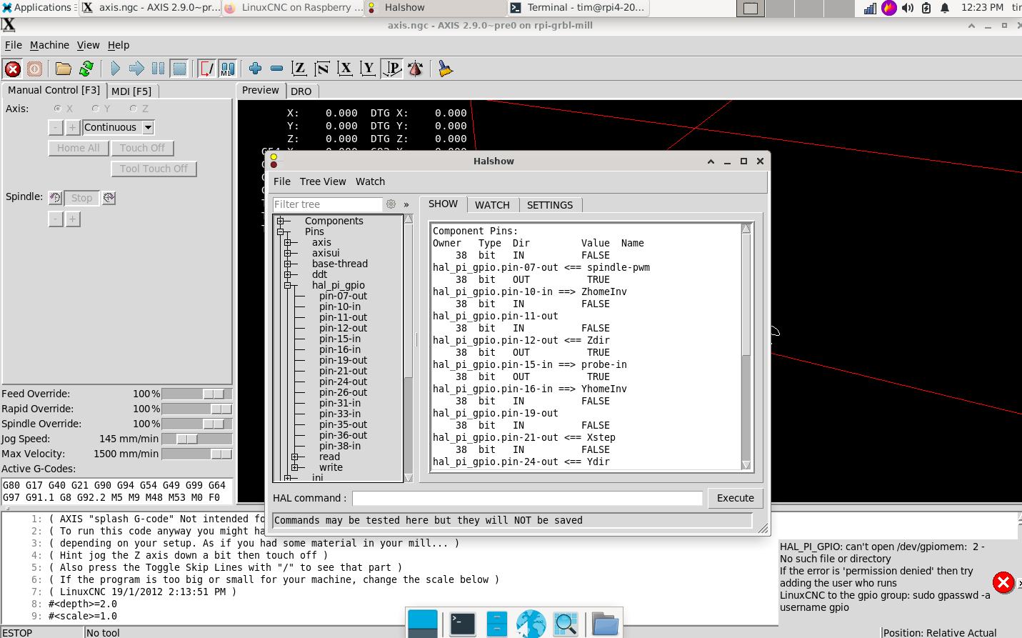

Made a little progress was able to downgrade kernel to 5.15.65-rt49-v8+
from github.com/kdoren/linux/releases.
To do this I installed deb files then I copied initrd.img-5.15.65-rt49-v8+ and vmlinuz-5.15.65-rt49-v8+ from /boot to /boot/firmware.
Then made appropriate changes to /boot/firmware/config.txt
This eliminated original problem of not recognizing rpi board.
After reading this at roboticsbackend.com/raspberry-pi-hardware-permissions/
Then I added file /etc/udev/rules.d/local.rules with the following;
ACTION=="add", KERNEL=="mem", MODE="0666"
This got ride of permission problem for memory.

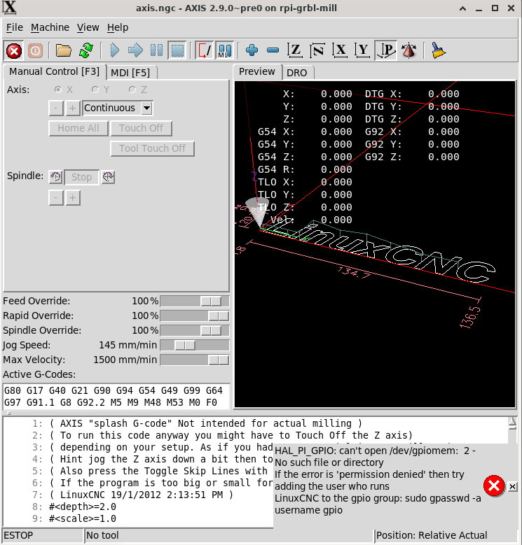

Now linuxcnc will start but still with error which I think goose back to
HAL_PI_GPIO: can't open /dev/gpiomem: 2 - No such file or directory
If you open terminal then
cd /dev
ls -l | more
you will see that there is no /dev/gpiomem
just gpiochip0 and gpiochip1
cd /dev
ls -l | more

17 Nov 2022 17:59 #256942
by elovalvo
Unfortunately, despite many attempts, I have not been able to solve the problem.
I believe this is due to the new kernel version 6.0.5-1 (2022-10-28) that you are using.
As the full working version (5.15.65-rt49-v8+), based on Raspbian rather than Debian, is available here
forum.linuxcnc.org/9-installing-linuxcnc...cnc?start=150#253623
why do you want to use Debian? To switch to Bookworm?

Going to sift through my notes, I found that, as reported in this link (forum.linuxcnc.org/9-installing-linuxcnc...-debian-64bit#178472), in this link (forum.linuxcnc.org/9-installing-linuxcnc...-debian-64bit#158905 that you modified on 17/4/2021) there was a file (services or linuxcnc-mem-services.zip) that would solve the problem you indicated
In particular, I found these instructions
Do you have a chance to recover this file?
Replied by elovalvo on topic LinuxCNC on Raspberry Pi 4
To elovalvo,
cd /dev
ls -l | more
# To overcome permissions for memory usage for gpio driver download the following archive
There two files in archive extract them
setmempermissions.service
setgpiomempermissions.service
Place files in /etc/systemd/system/
Do in Terminal
sudo systemctl enable setmempermissions.service
sudo systemctl start setmempermissions.servicesudo
sudo systemctl enable setgpiomempermissions.service
sudo systemctl start setgpiomempermissions.service
sudo reboot -n
After reboot check /dev/mem and /dev/gpiomem permissions
In terminal
cd /dev
ls -l | more
press ENTER key to scroll through
Should be
crwxrwxrwx 1 root root 246, 0 Mar 1 09:50 gpiomem <---date and time will be different
crwxrwxrwx 1 root kmem 1, 1 Mar 1 09:50 mem

I deleted that post along with the files I had a long time ago, sorry. But those file would not have gotten rid of the problem of /dev/gpiomem because /dev/gpiomem dose not exsist on the version of debian that is in development for raspberry pi now. But Rasbian still uses /dev/gpiomem. The probem with reconizing the board can be overcome with using the kernel from github.com/kdoren/linux/releases . I also came up with a fix for /dev/mem useage from this artical roboticsbackend.com/raspberry-pi-hardware-permissions/
This got ride of permission problem for /dev/mem. What I think needs to happen is the Hal_pi_gpio driver needs to be updated to not use /dev/gpiomem when used with pure Debian OS.
Regards

So, where is this at? Is there a version of LinucCNC that works on the new rev of RPi 4?

- dannym
- Posts: 220
08 Jan 2023 22:11 #261308
by dannym
Replied by dannym on topic LinuxCNC on Raspberry Pi 4
>- the Buster-based 64bit version with LinuxCNC 2.8.2 here
But that's the one that just says "this board requires newer software" and won't boot with the current rev of RPI 4 board.
- dannym
- Posts: 220
08 Jan 2023 23:04 #261309
by dannym
>- the 64bit version based on Bullseye with LinuxCNC 2.9.0pre here
And this one says "Welcome to Raspberry Pi Desktop" splash screen, but then the monitor says the HDMI signal is lost and it never recovers. Hitting the keyboard had no effect.
