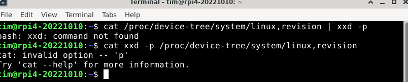

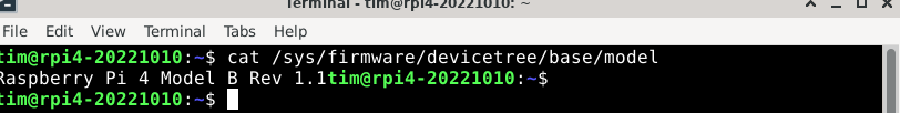

As far as I can see the problem arises from a bug on the 'cat /proc/cpuinfo' command
github.com/raspberrypi/linux/issues/2110
Unfortunately this command is used by the cpuinfo.c module which is called by the hal_pi_gpio module.
Maybe it could be solved with this variant:
cat /proc/device-tree/system/linux,revision | xxd -p
or
xxd -p /proc/device-tree/system/linux,revision
Can you try and tell me what he answers?
or

04 Nov 2022 14:32 #255915
by tjmarch
Replied by tjmarch on topic LinuxCNC on Raspberry Pi 4

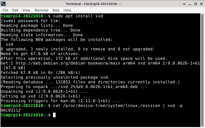

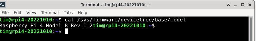

04 Nov 2022 16:00 - 04 Nov 2022 16:03 #255929
by elovalvo
But what operating system do you have?
In any case, install the xxd command with this
sudo apt install xxd
and then run the command again.
The following outputs should come out:
c03111
and
c03112
If so, I can edit the cpuinfo.c file easily.
Otherwise I will have to think of some other solution.

- tjmarch
- Posts: 152
- Thank you received: 22
04 Nov 2022 19:35 - 04 Nov 2022 19:37 #255949
by tjmarch
Last edit: 04 Nov 2022 19:37 by tjmarch.

- elovalvo
- Posts: 205
- Thank you received: 127
05 Nov 2022 10:36 #256001
by elovalvo
Does this solve the cpuinfo problem?
Replied by elovalvo on topic LinuxCNC on Raspberry Pi 4
Ooops sorrry, the debian images do not include a graphical environment. This is pretty easy to install and you have a choice of environments.
sudo apt install tasksel sudo tasksel

08 Nov 2022 19:05 #256231
by tjmarch
elovalvo
wrote "But what operating system do you have?
c03111
and
c03112
Otherwise I will have to think of some other solution."
Was just wondering if you were able to update cpuinfo.c
