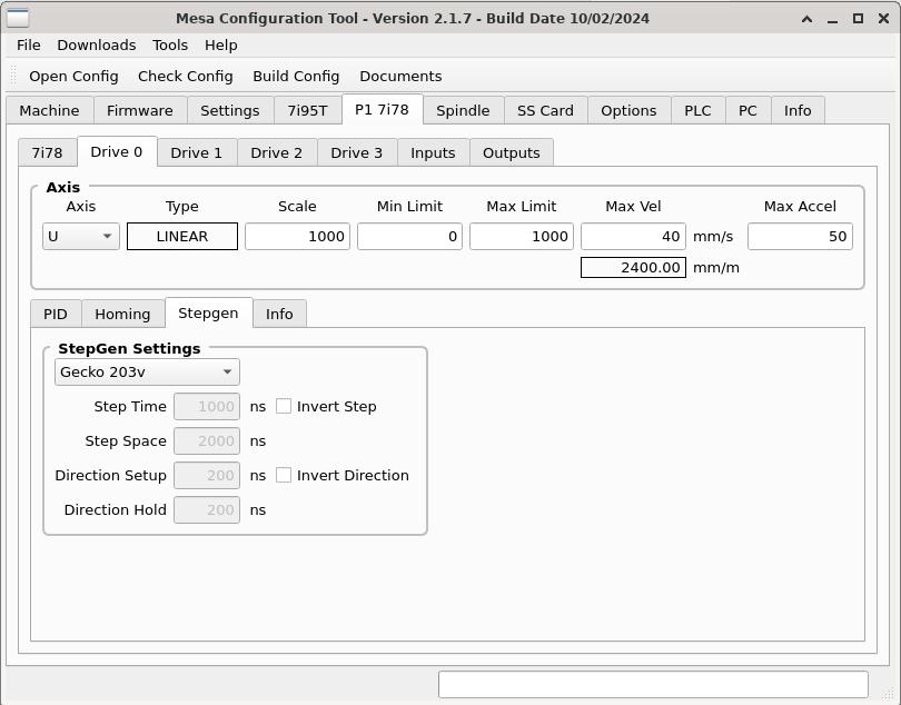

Using firmware PCW attached above, I see following:
Souldn't be there 7 encoder inputs?

Replied by tommylight on topic Mesa Configuration Tool
Muxed encoders, so that would make 8 available encoders.
Muxed = multiplexed , IIRC that is 2 encoders on a single channel .

In MesaCT I configured 6 axis on 7i95T and one on 7i78, but for that one there are no stepgens defined in .hal file:
# This file was created with the Mesa Configuration Tool on Nov 30 2024 17:11:51

net estop-loopback iocontrol.0.emc-enable-in <= iocontrol.0.user-enable-outAttachments:
- Posts: 18093
- Thank you received: 5325
30 Nov 2024 18:09 #315670
Replied by PCW on topic Mesa Configuration Tool
Looks like a mesact bug.
In the mean time you could just copy/paste/renumber
the stepgen section from another axis to get it working.
- JT
- Posts: 1103
- Thank you received: 593
01 Dec 2024 12:30 - 01 Dec 2024 12:35 #315727
by JT
Replied by JT on topic Mesa Configuration Tool
Fixed the 7i78 stepgens, download the deb again and reinstall.
JT
JT
Last edit: 01 Dec 2024 12:35 by JT.
