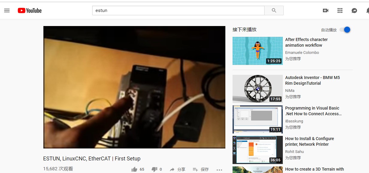

Have you ever used the command line to control the rotation of the motor?
This was sent to me by Grotius. There is no need to execute linuxcnc xxxxx.ini.
Part of the message is hidden for the guests. Please log in or register to see it.
mabey you can see this video
I hope this will help you.

I've checked your advice. When the program is started, the servo is still in the PREOP state and + changes to E. I've checkedm 'dmesg' command and have received such information:
I tried to use the command line to control the rotation but i can only read information about max torque and velocity. When I try to use another command, it's showing up: "The slave selection matches 0 slaves. 'upload' requires a single slave".
I don't know what and where i'm doing wrong
Code:
[ 7031.928353] EtherCAT WARNING 0-0: Slave did not sync after 5000 ms.
[ 7031.945351] EtherCAT ERROR 0-0: Failed to set SAFEOP state, slave refused state change (PREOP + ERROR).
[ 7031.947348] EtherCAT ERROR 0-0: AL status message 0x001E: "Invalid input configuration".
[ 7031.958347] EtherCAT 0-0: Acknowledged state PREOP.

Hi marcin2458,
Do you have well configured the "driver" with the "servo-motor" and all the corresponding parameters?
regards

chimeno wrote: Hi marcin2458,
Can you try to erase this signal if it solves something?
setp lcec.0.0.extenc-scale [AXIS_0] ENC_SCALE
regards
Chimeno
