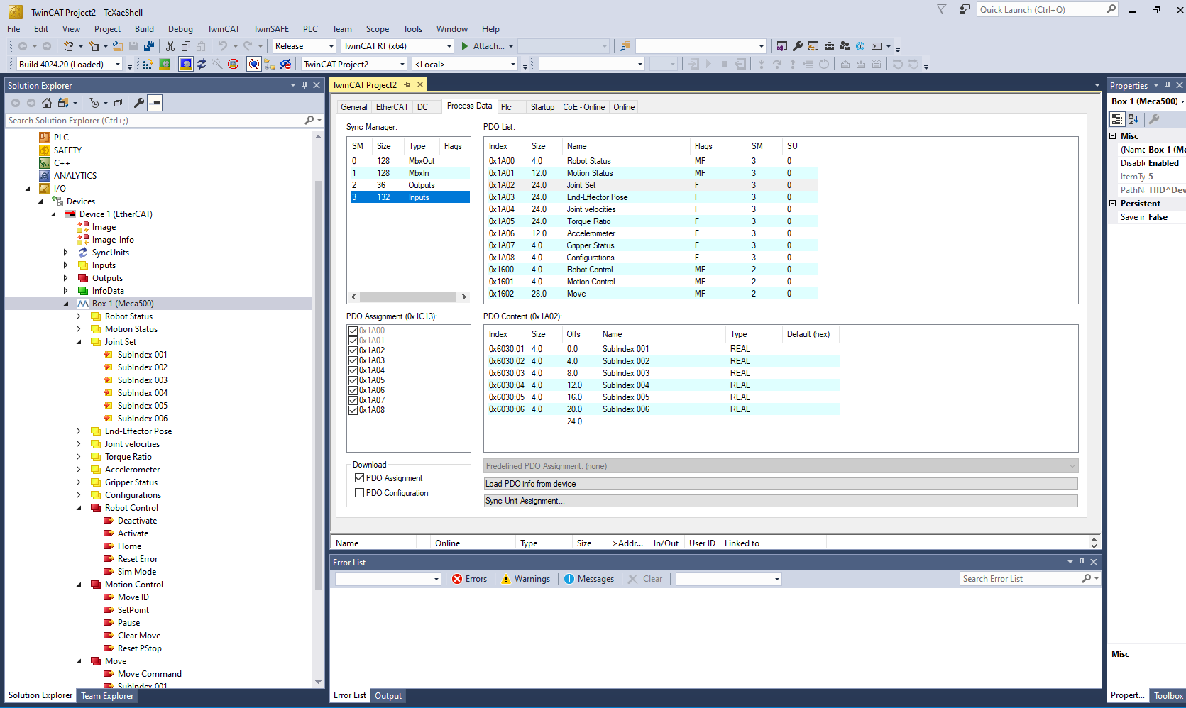

Hi!I would like to develop a LinuxCNC driver for an EtherCAT 6 axis robot - the Meca500.
I have started the HAL side and have the 3D stl model articulating with switchkins.
Can you recommend a starting point to learn more about the interaction between LinuxCNC HAL and a LinuxCNC EtherCAT driver? The EM7004 looks like a good example of multiple axis control but I am struggling to find how to map between the two.
github.com/sittner/linuxcnc-ethercat/tree/master/src
If you're curious you'll find the Meca500 EtherCAT documentation in section 4 of the programming manual along with the EtherCAT object dictionary.
cdn.mecademic.com/uploads/docs/meca500-r...mming-manual-8-4.pdf
There is also an Meca500 EtherCAT ESI xml file in the root of the firmware file
cdn.mecademic.com/uploads/docs/meca500-v8-4-5-2580-official.zip

I had a quick look at the manual.
I would start by installing ethercat as per the sticky in this section.
Once the robot is seen with the ethercat slaves command, I would build a custom XML file that exposes the PDO registers that are listed.
These registers then become pins in hal. They will be named something like lcec.0.xxxx.
You will probably need to write a custom homing module which will require v2.9 master branch
ref: linuxcnc.org/docs/devel/html/man/man9/homecomp.9.html
It will then be up to you to map the required commands to those pins.
Good luck! IT would be pretty cool to see several robots all on the one ethercat bus!

as far as i can see, if i understand the robots manual correct....
the implemented ethercat interface is useless for linuxcnc.
Linuxcnc is an realtime motion controller, which needs independent full controll over all single joints.
The robots interface is designed to get external control of the robots inbuild motion / trajectory control. you are only able to send waypoints for all joints at once and add them to an motion que in the robots memory . with this data the robot will calculate its own accel/deccel and trajectory .
I could not find anything about realtime external control, all motion commands are interpreted by the robot himself and gives no direct control of the joints themselfes...
