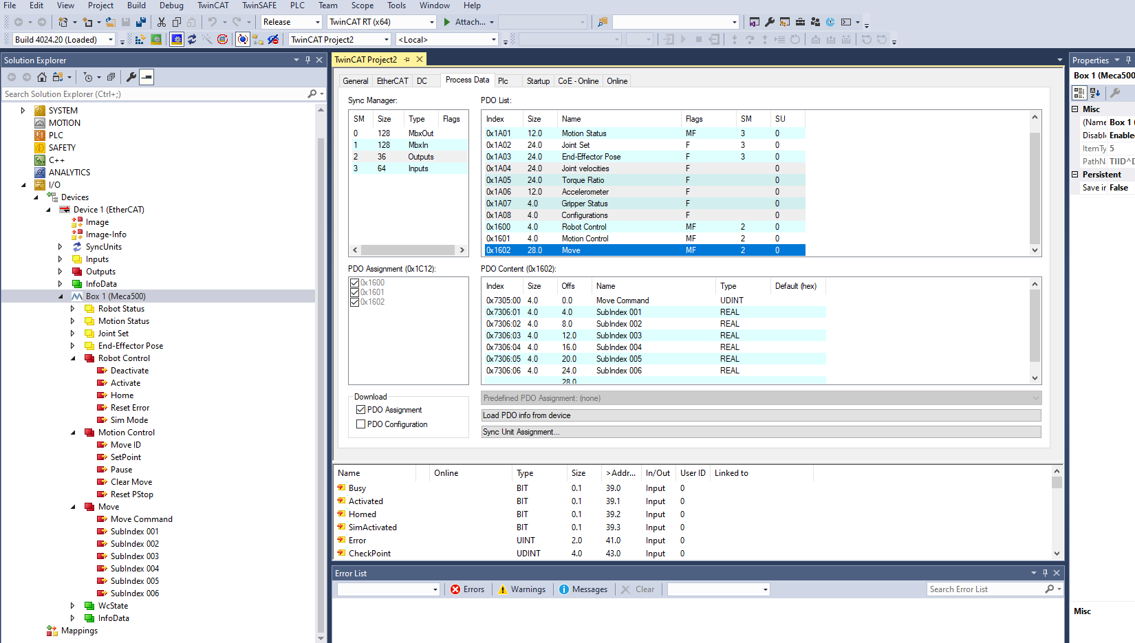

I am fully aware that "linuxcnc does not have ready-made tools" for my particular robot. I specifically said I wanted to "develop a LinuxCNC driver for an EtherCAT 6 axis robot - the Meca500" and asked for a starting point. rodw seemed to grasp straight away what I was asking and provided some great advice.
I'm here to develop and contribute. I have already installed etherlab master and lcec.
"The new firmware will not allow you to control an individual joint" - are you a Mecademic employee or have one of these little chaps?
Last edit: 10 May 2022 10:20 by ftree.

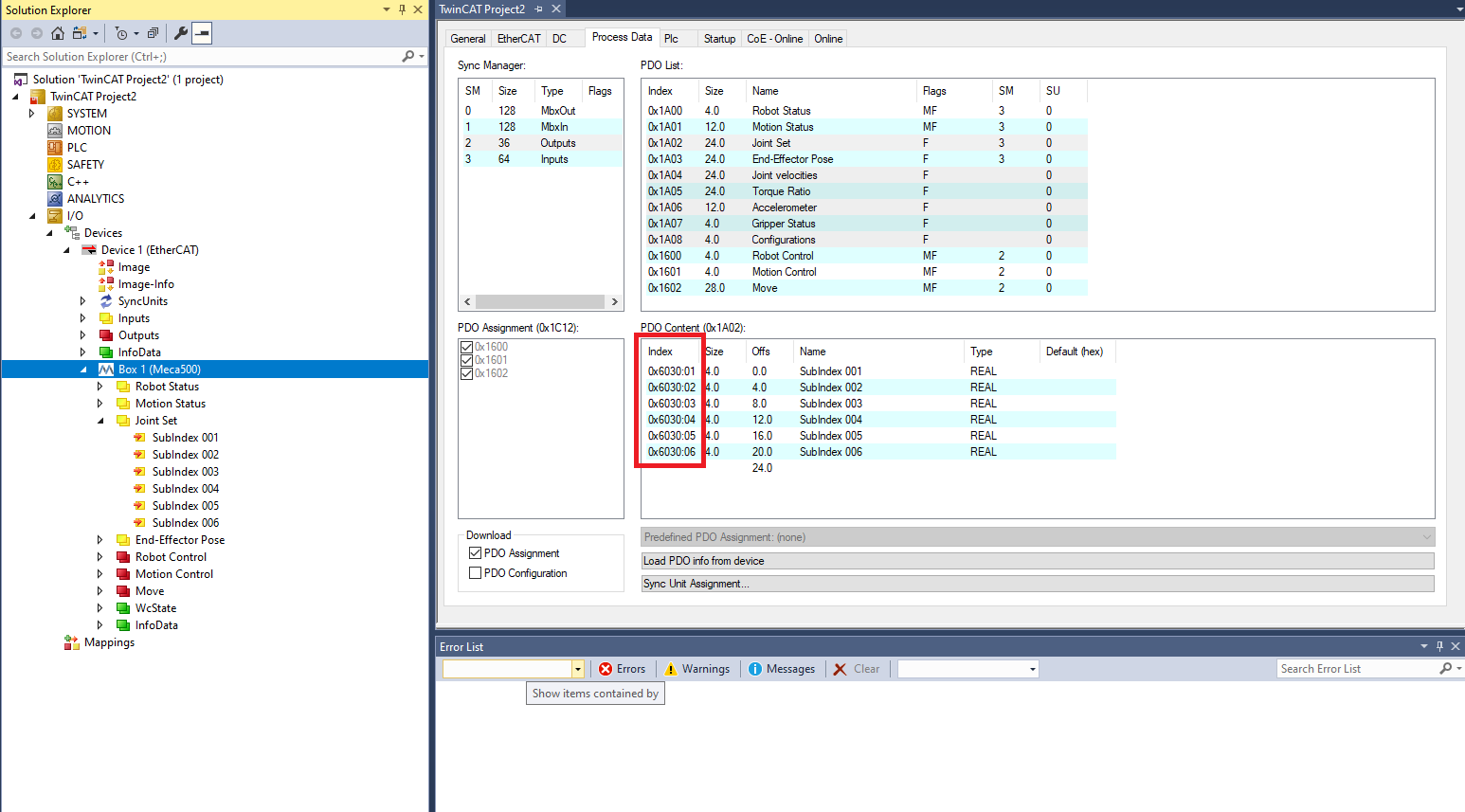

hmm, what for this case is needed is an direct cyclic control of the joint motor amps, like cyclic synchronus position or velocity mode. without an inserted controller from the robots motion system.
The joint indexs that TheRoslyak marked in his picture are only feedback information from the robot to ethercat. controlling at this firmware is reached through the motion command block with the underlaying motion que. And this sadly is not rt controllable....

EtherCAT interface appears to support MotionCommandID with six arguments (for each joint?). Here are two - many others available. See table 7 in programming manual. "List of MotionCommandID numbers"
ID=6 MoveJoints 6 arguments in degrees
ID=23 MoveJointsVel 6 arguments in degrees / sec
Last edit: 10 May 2022 12:04 by ftree.

And I did not say that these registers are needed for control.
For control need move command (for example 1 - is line 2 - arc 3 - spline and etc)
And sub index ( is x ,y, z ,etc)
In any case, if you do it through linuxcnc, Need combinations of mux, dmux and etc

The only "cyclic" modes (velocity mode) are
MoveJointsVel
MoveLinearVelWrf
MoveLinearVelTrf
These can be sent evey cycle with MoveID=0, SetPoint = 1. To stop the robot send SetPoint=0
Would a velocity mode with position feedback from each joints encoder be such a bad thing? Robot timestamp, World Reference, Tool Reference and Robot Base Reference are available data on the TxPDOs in various data forms.
MoveJointsVel
MoveLinearVelWrf
MoveLinearVelTrf
Last edit: 10 May 2022 13:15 by ftree.
