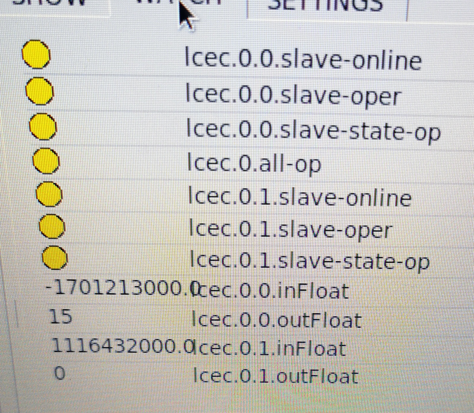

Replied by rodw on topic Custom EtherCAT device
I did wonder if you were using haltype="float" in the xml config but it seems you are.
My immediate thought after that could be it is a byte ordering thing on your hardware
It would be interesting to explore the hal pin value at a binary or hex level.
Swapping theĀ byte order might fix it.

by Tady
Replied by Tady on topic Custom EtherCAT device
Yes I use float as halpin type. And in my XML.. But the "ethercat XML" returns the XML version that it supposed to be flashed on the EEPROM (If I understand this correctly), this is printed in CLI and there the DataType is UINT32, but it should be REAL.. Here I think is the problem. I tried reversing the byte order and alot of different things.
To me this seems to be the problem. This a side, it work great. Maybe I can make a demo on the encoder thing

by Tady
Here is the photo of the slaves sending a float number to LinuCNC. The number is counting from 0 to 100 in 0.1 steps. The top is byte reversed and the bottom is not. Totally different numbers. But they don' reprisent the same number, because the slaves are not counting at the same rate.
I think this is a representaion of a float number in UINT32 formatĀ

by Tady
I posted an issue on siitool guthub page (the tool I used to convert my XML to bin, and then flash the bin to my slave's EEPROM). The author of the software replyed that there is a bug in his software and he will fix it.. So it seems that I'm on the right track..
Now waiting for an update.
